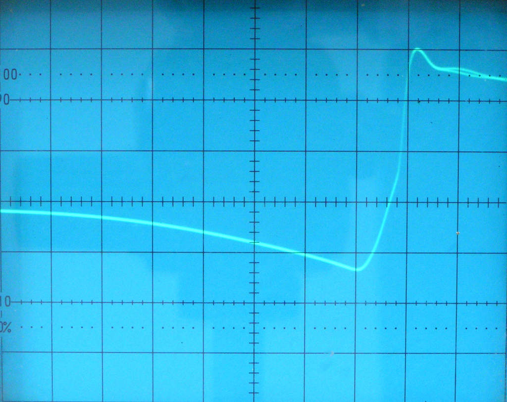

When the DEM oscillator timing cap has the correct value there should be a lock, however, due to drift (temperature) lock-out can occur over time. The jitter is quite normal with the datasheet app, performance can be optimised by using an un-interrupted ground plane and very small (805 size) film cap with shortest possible traces.
EMI pick-up can be greatly reduced by the following:
6K8 between pins 15 & 16
6K8 between pins 15 & 17
Timing cap between pins 16 & 17 (value has to be increased due to reduced oscillator input impedance).
Attached picture of the DEM clock shows the typical DEM oscillator signal for this free running DEM clock.

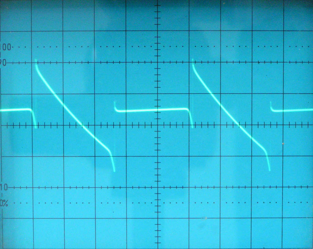

Ideally I should have seen clean synced 4-steps signal. I have seen a jittery smeared signal, instead.
Also it is easy to de-tune the DEM oscillator by closing my hand to the capacitor.
