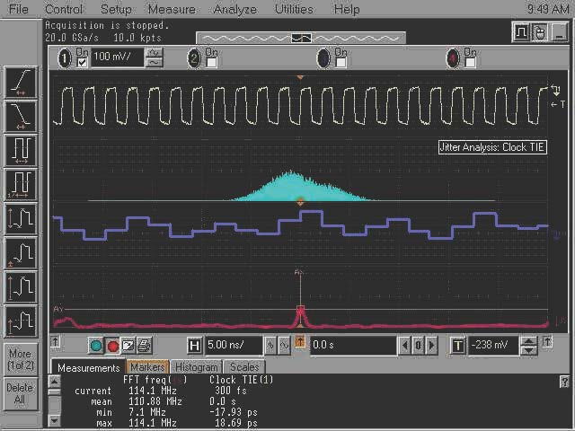

Reading this article (http://www.unitest.com/theory/jitter.html),
I have come across on interesting picture.
Upper curve - a clock pulses (456 MHz), blue histogram - a histogram of the point of the transition.
The blue line - TIE (Time Interval Error – TIE), red line - a FFT for TIE that is to say the jitter spectrum.
