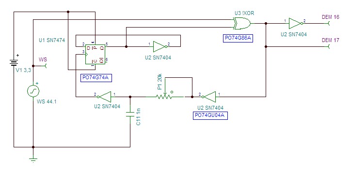

When the DEM oscillator timing cap has the correct value there should be a lock, however, due to drift (temperature) lock-out can occur over time. The jitter is quite normal with the datasheet app, performance can be optimised by using an un-interrupted ground plane and very small (805 size) film cap with shortest possible traces.
EMI pick-up can be greatly reduced by the following:
6K8 between pins 15 & 16
6K8 between pins 15 & 17
Timing cap between pins 16 & 17 (value has to be increased due to reduced oscillator input impedance).

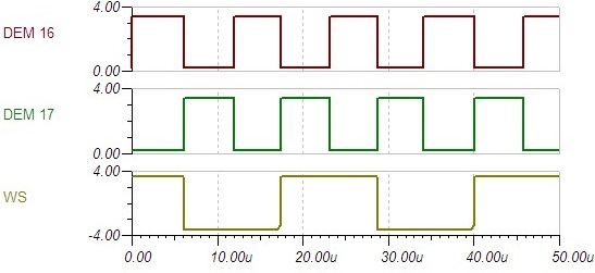

Attached picture of the DEM clock shows the typical DEM oscillator signal for this free running DEM clock.

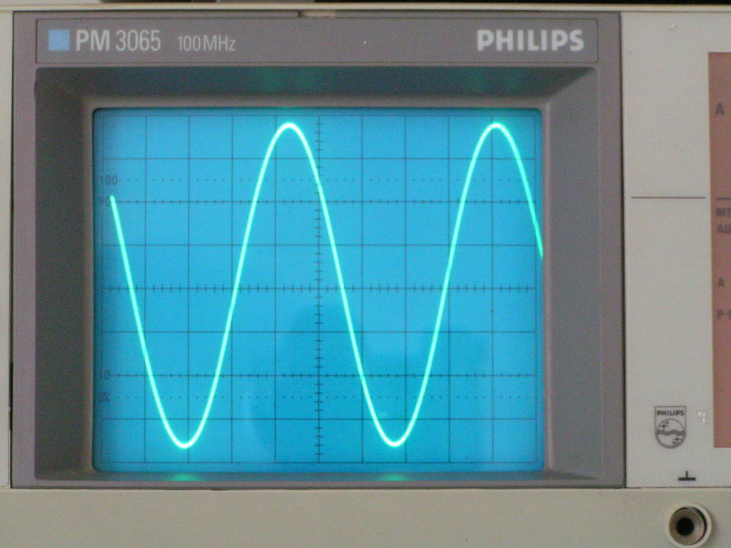

Perceived sound quality is the most important factor, so far no audible "problems" with the Cauer filter plus 44K1 trap.

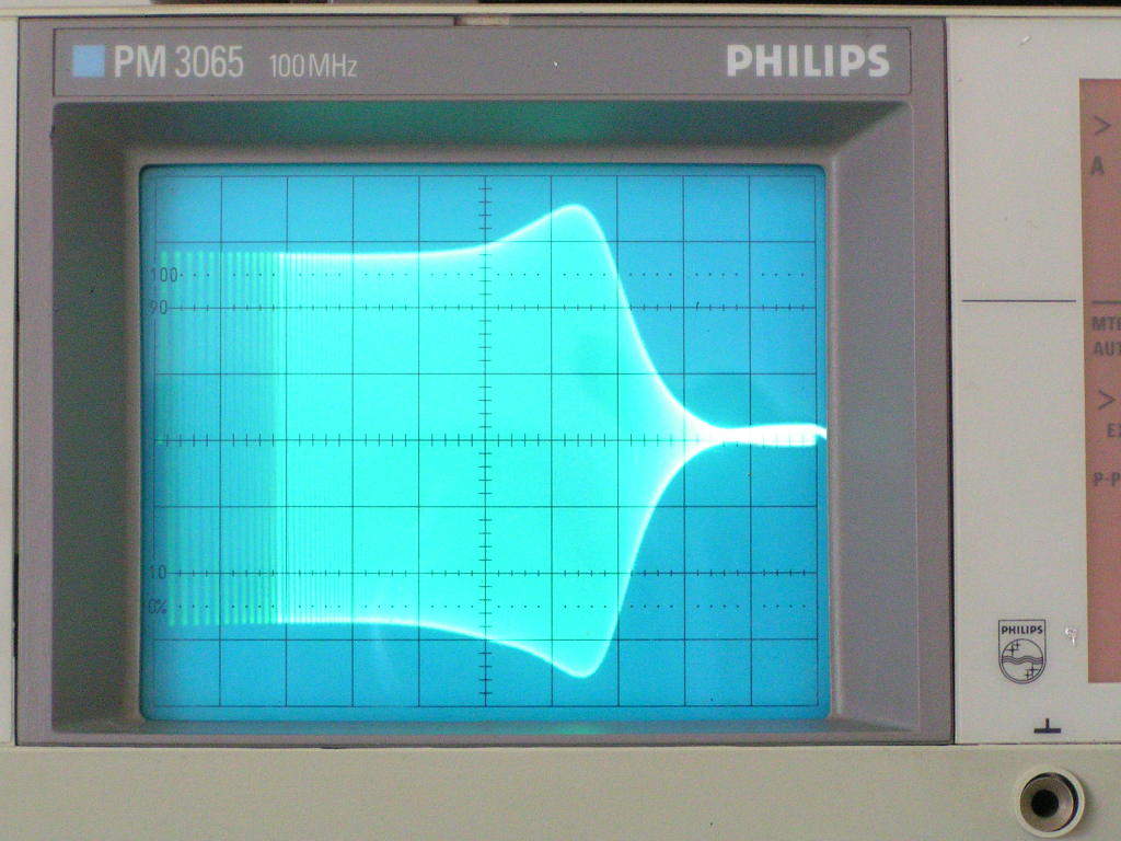

I tested a 3rd order Cauer-Pi filter with integrated parallel resonance circuit ( 9 Ohm load, single TDA1541A).
C1 = 470nF, L1 - 150uH, shunt cap, 100nF, C2 = 470nF, 4 parts in total.
I attached an oscillogram of a 800Hz … 88K2 sweep that shows filter response.
Second oscillogram shows the resulting 1 KHz sine wave test signal.

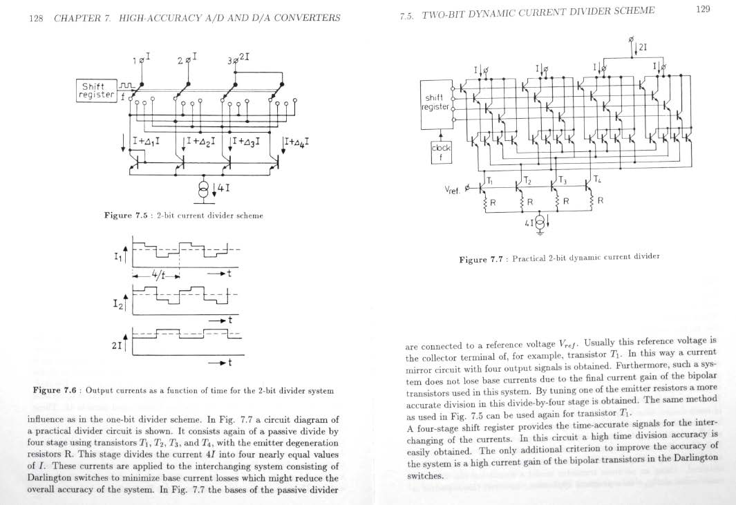

In another thread in DIY Audio, someone posted an paper by Henk ten Pierick for synchronizing the WS to couple the DEM. Did you ever try this, and if so, you must have abandoned it for one reason or another?
Gary
The following could be a way to run the DEM at 88k2 in synchro with WS, using Potato TTL gates.
At this moment I have no chance to give it a try.
Seems most people prefer the free running DEM, anyone did never tried such kind of synchronizing?

I already tested down to 40Hz using 3uF DEM oscillator timing cap...
At such a low frequency DEM mechanism stops working. Then it is better to just turn off it, because of him there is no sense.
Each current divider will supply current for 25 ms. During this time will change 44.1 * 1000 * 25/1000 = 1102 samples. For these 1102 samples a reference current generated by the same current divider. That is, for them the mechanism of DEM as to be no.

Averaging is not the best term, low-pass filtering would be more adequate. But I agree that the problem is not the ripple (high-frequency switching artifacts). For this reason I listen to my DAC without external filtering capacitors 😉
Hi, oshifis!
The term "averaging" reflects the essence of the DEM mechanism. Bit currents of neighboring bits should be different exactly twice. DEM mechanism achieves this by interchanging reference currents, which leads to an time averaging of the reference currents. Read the monograph van de Plassche. I already gave a link to it. Here is an excerpt from chapter 7 of this monograph.
Interesting article, thanks. Also worth reading "Dynamic Element Matching for High-Accuracy Monolythic D/A Converters" in the IEEE Journal of Solid-State Circuits, Vol. SC-11, No. 6, December 1976.
