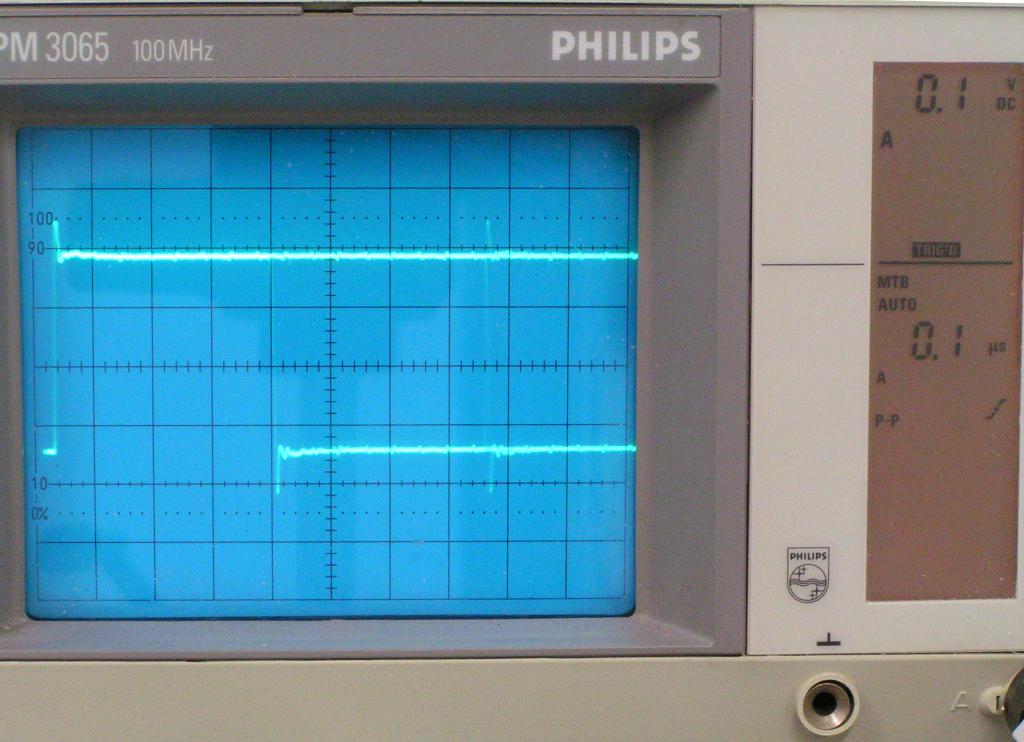

This is the BCK signal measured on the tda pin2. I am using the mk8 reclocker design... Is this normal behavior given the internal capacitance of the tda and limiting resistors? The WS trace is clear square wave with slight overshoot
What are BW, impedance and capacitance of probe/scope?
What is source impedance of reclocker?
Reclocker source impedance is 82R I believe
Standard probe, can't find the spec sheet, but I think 1M/12pF

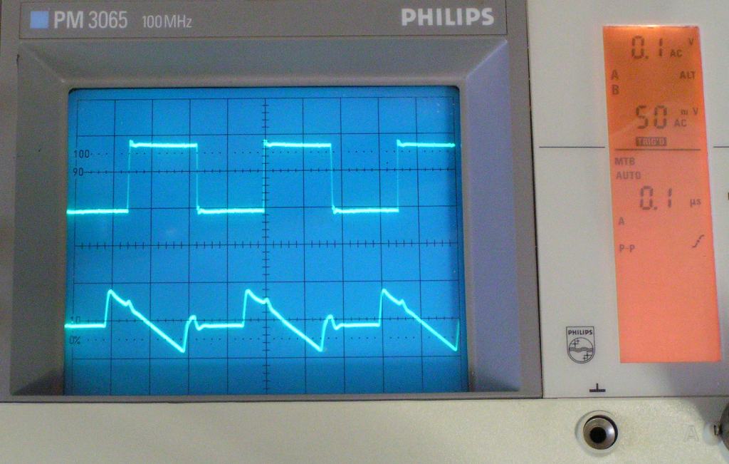

I attached an oscillogram of BCK signal (pin 2) measured on an earlier design (2010)
You need a large bandwidth scope of say 100MHz, suitable probes and have to remove the ground lead and use an adapter tip with short ground connection:

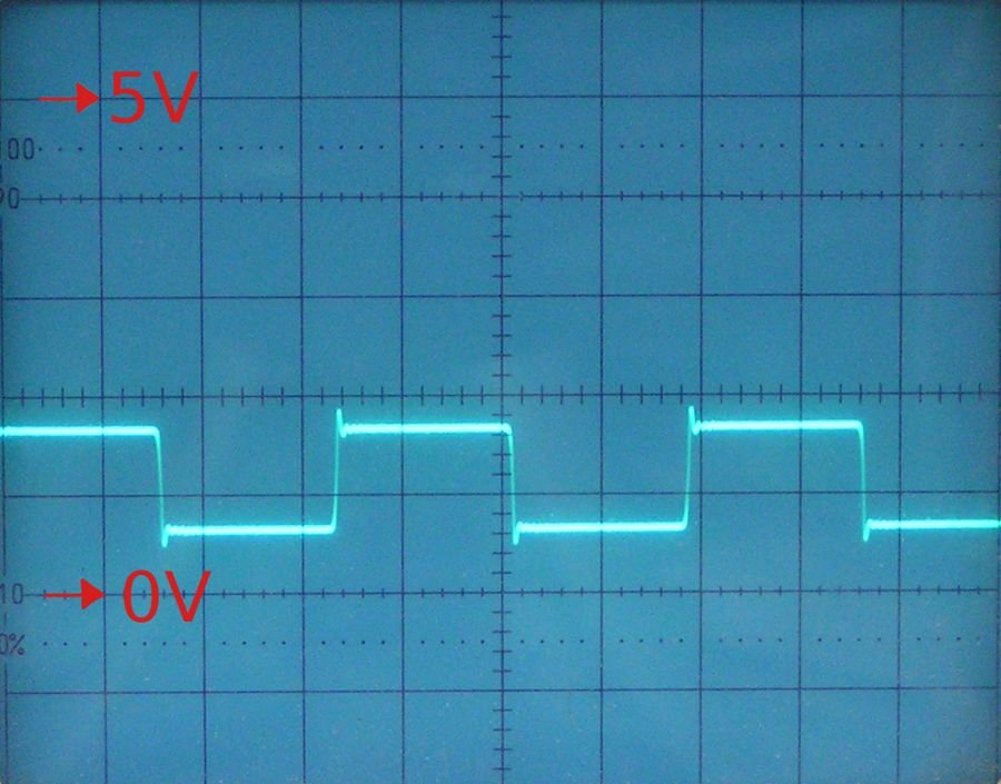

The nice square was measured on a resistive BCK divider (330R / 1K) in 2010. The divide-by-4 circuit (2012) provides much steeper transients. BCK now has 1.8Vpp amplitude (no DC bias voltage).

That explains why you have a nice square

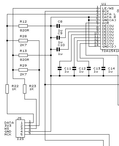

Why do you still place current limiting resistors on WS and DATA (even though the SD transport outputs suitably levelled signals.
SD8 transport outputs 3.3Vpp. These signals are attenuated and a bias voltage is added for minimum switching noise injection through ground-bounce. The resistors reduce WS and DATA signal bandwidth and attenuate the signal amplitude, both lead to reduced ground-bounce in the TDA1541A I2S input circuit.

Hi Galeb,
I attached the I2S attenuator / bias circuit for WS and DATA.
Input signal amplitude equals 3.3Vpp. Resistor of 1K is placed in series with the signal (R22, R23).
Resistor of 820R to GND and 2K7 to 3.3V power supply provide the bias voltage and together with the 1K series resistor they provide required signal attenuation.
The circuit provides approx. 1.76Vpp and a bias voltage of 1.115V.
hi john, could you post the signal conditioning schematic?
