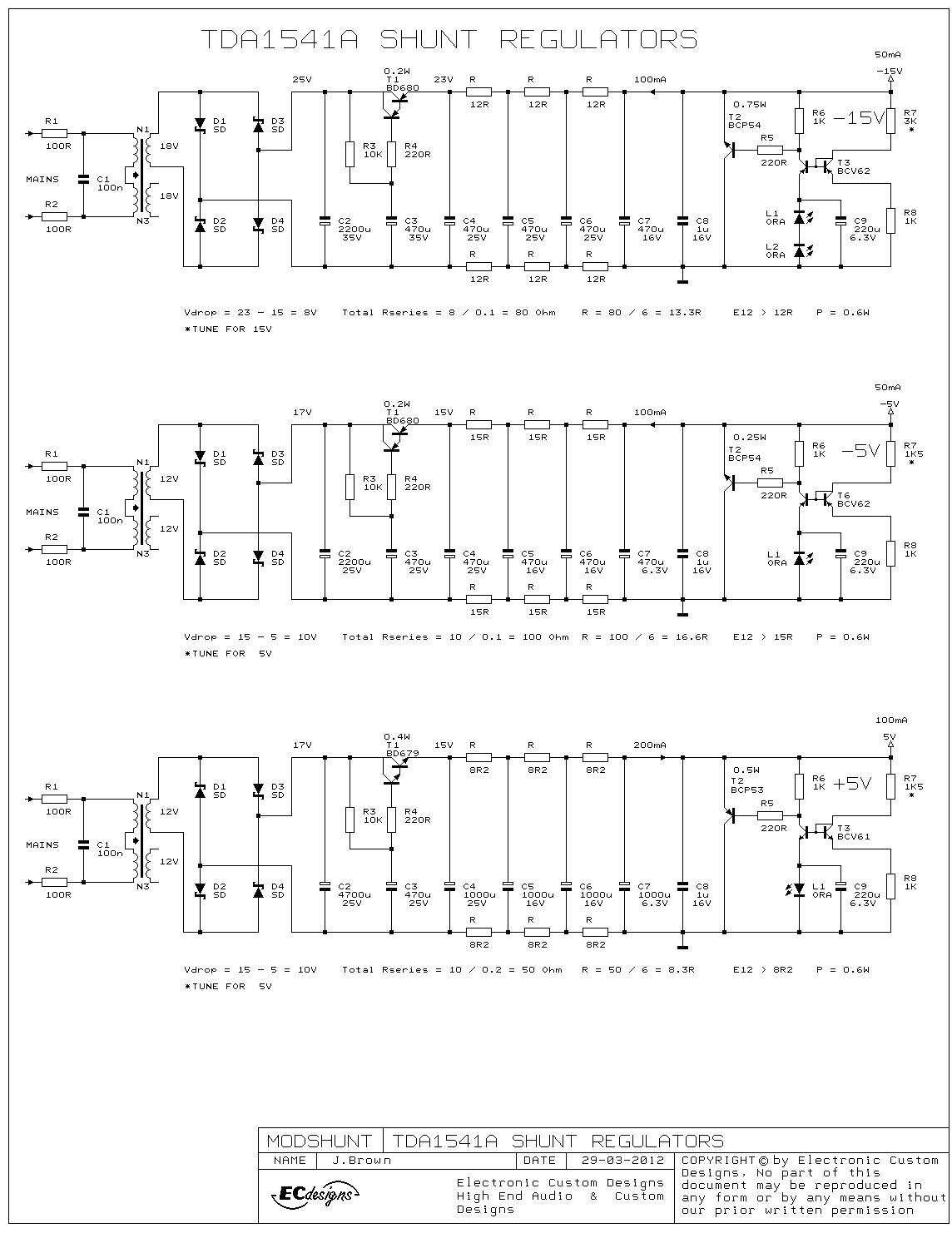

Is the maximum current through the MODPWR2 common mode regs limited only by the maximum collector current of the BD679 (4A) ? I would like to use one to power a squeezebox (roughly 1A draw)....
Hi studiostevus,
The maximum regulator output current (capacitance multiplier) also depends on BD679 base current / Hfe.
When higher output current is desired you need to increase base current (decrease resistor value between base and collector).
This in turn will increase ripple voltage on the capacitor (capacitance multiplier), so a larger capacitor value is needed.

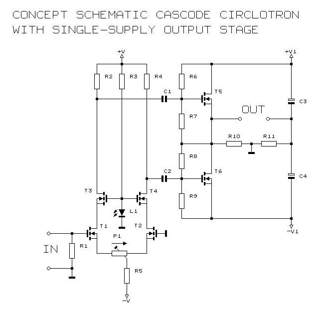

I use a 2A capacitance multiplier for the modified Circlotron output stage that runs on a single power supply.
The latest power supplies consist of rectifier, capacitance multiplier, balanced passive RC filter and shunt regulator. This configuration offers very clean DC voltage even with highly polluted mains voltage (attached schematic).

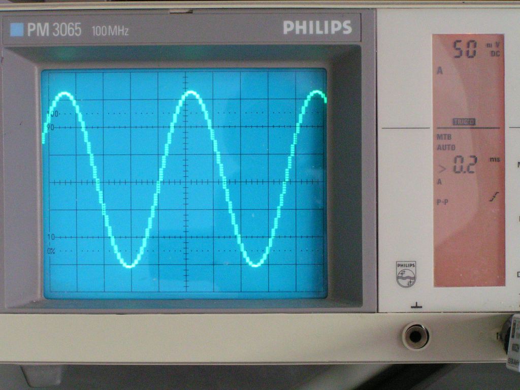

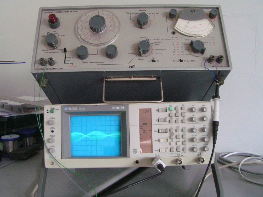

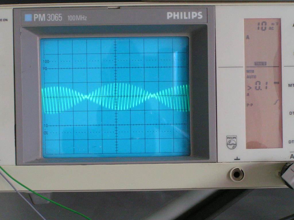

Yes I did, Marconi TF2331A distortion meter indicates approx. 0.02% THD + noise (DAC + Aikido line amplifier). The TF2331 also has an output (extracted THD + noise). This output signal can be used to analyse the distortion + noise.
The first oscillogram shows the 1 KHz output signal (3Vpp) at the Aikido line amplifier output. Voltage across the 120R passive I/V resistor equals 480mVpp and positive bias current equals 2mA.
The second picture shows THD measurement setup. The TF2331A indicates approx. 0.02% THD & noise. The scope shows the distortion meter output signal. The distortion mainly consists of quantization noise as can be seen on the oscillogram.

Did you measure the distortion with decent equipment or did you look at the waveform with a scope ? Remember the 25mV voltage compliance.

Can you post some more info and maybe a schema of this Circlotron?I use a 2A capacitance multiplier for the modified Circlotron output stage that runs on a single power supply.
This would be much appreciated 🙂

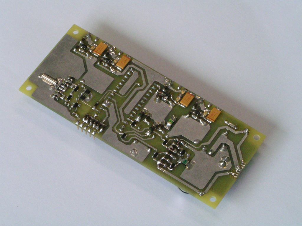

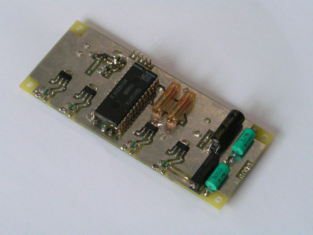

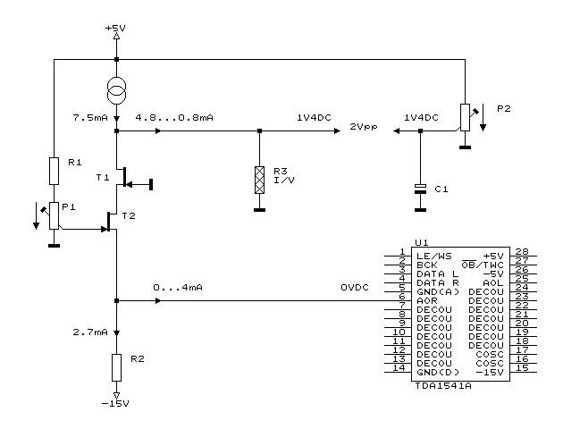

This week I completed some TDA1541A-MK11 modules. After performing tests with passive I/V conversion using 120R from TDA1541A to GND and 2mA bias current to +5V it turned out this resulted in limited dynamics and caused some other problems like the need for extra amplification.
The MK11 I/V stage is based on a RF JFET cascode current buffer connected between TDA1541A output and a 7mA RF JFET CCS that connects to +5V. Resistor or CCS from TDA1541A output to GND provides a 3mA bias current for the current buffer.
Both, DAC output current and 3mA bias current are subtracted from the 7mA CCS and the remaining current flows through a 500R Rhopoint wire-wound I/V resistor that connects to GND. This offers 2Vpp as before. The bandwidth of this circuit is almost equal to RF JFET FT (700 MHz). So it's important to use short wiring and un-interrupted ground plane.
There are two trimmers on the current buffers for L/R channel DC offset at the TDA1541A outputs.
The reference voltage for DC-coupling now equals around +1.6V and can be decoupled to GND instead of +5V. This prevents external interference being dumped on the +5V supply. An additional trimmer is provided to set this reference voltage.
The TDA1541A-MK11 runs on the proven masterclock / clock buffer and synchronous BCK divider circuits. DEM soft sync circuit offers best DEM circuit operation so far.
Active divider decoupling is located underneath the TDA1541A and consists of 1uF 1210 size SMD film caps. The TDA 1541A is placed in an IC socket and there are no parts soldered to this chip so it can be swapped easily.
Resistive I2S attenuators are used for WS and DATA signals. The MK11 outputs 11.2896 MHz for slaving external sources.
The stepped shunt volume control based on Rhoint resistors and sub miniature signal relays works fine. It is controlled through a serial interface that connects to the SD8 transport. The attenuation is displayed on the 7 segments displays during volume change. It is soldered directly to the DAC for minimum (capacitive) losses between DAC and volume control.
I attached a photograph of SD8-transport, MK11 DAC and stepped shunt volume control while being tested.

Hello John,
I understood your your MK11 current buffer in principle but not in detail:
The reference voltage is about 1.6V. I suppose this voltage is across the 500R resistor if
the TDA1541A provides no AC signal. The current through the resistor is 3.2mA.
The remaining current through the JFET is 3.8mA (7mA-3.2mA)

Hi marconi118,
I attached a concept schematic of the Ciclotron. The Circlotron output stage runs on a single power supply instead of two isolated power supplies. The circuit is still a parallel push-pull concept like the Circlotron.
The differential cascode input / driver stage / phase splitter runs on a separate high voltage supply (80 ... 120V) in order to maximize headroom, eliminate interference from the output stage, and achieve fairly constant current through R5.
Bias current equals approx. 2 x 10mA. Input is DC-coupled. LED L1 provides bias voltage for the cascode (T3, T4).
Output stage consists of T5 and T6. Each MOSFET has a separate bias circuit (R6. R7, T5 and R8, R9, T6). Bias current is set to approx. 400 ... 500mA (no signal).
R10 and R11 create required reference for signal injection (C1, C2).
Signal path T5: C1, gate, source, R10, ground.
Signal path T6: C2, gate, source, C4, R11, ground.
Asuming C3 and C4 are short circuit for ac signals, signal path for T6 can be viewed as:
C2, gate, source, R11, ground.
Can you post some more info and maybe a schema of this Circlotron? This would be much appreciated

Hi JOSI1,
I attached I/V stage concept schematics.
With no signal TDA1541A outputs 2mA bias current. This current varies between 0 and 4mA with input signal.
No signal: current through R3 equals 7.5mA (CCS) - 2mA (DAC) - 2.7mA (R2) = 2.8mA. This gives 0.0028 * 500 = +1.4V DC.
DAC output 0 mA: current through R3 equals 7.5mA (CCS) - 0mA (DAC) - 2.7mA (R2) = 4.8mA. This gives 0.0048 * 500 = +2.4V
DAC output 4 mA: current through R3 equals 7.5mA (CCS) - 4mA (DAC) - 2.7mA (R2) = 0.8mA. This gives 0.0008 * 500 = +0.4V
So signal amplitude across R3 equals 2.4V - 0.4V = 2Vpp.
DC voltage at DAC output is set @ 0V with trimmer P1.
Note that there is always at least 2.7mA bias current running through the cascoded current buffer (T1 & T2).
DC-coupled output is achieved with decoupled adjustable reference voltage (P2). P2 is trimmed to match DC voltage across R3, in this example +1.4V.
This reference voltage is decoupled to GND and serves as reference for connected (pre) amplifiers. The circuit GND is -not- connected to external equiplent.
This circuit offers improved dynamics, lower distortion and better transient impuls response compared to pure passive I/V conversion. There is also no need for extra amplification (and related bandwidth reduction).
I used low noise (0.5dB) RF JFETs with Ft of around 700MHz. So the I/V converter has very large bandwidth and good linearity (cascode).
The measured input impedance of the cascode current buffer equals approx. 60 Ohms.

TDA1541A-Mk11 pictures
I attached some pictures of the latest TDA1541A-MK11 DAC.
First picture shows the component side. SMD film decoupling caps are located on the PCB, underneath the TDA1541A. The TDA1541A can be swapped easily (socket).
Film capacitors were used where possible in order to eliminate unwanted piezoelectric effects of ceramic caps. Only exception are the low value NPO caps (8.2pF ... 33pF).
There are 4 discrete shunt regulators, 3V6, -5V, -15V, +5 (left to right). Circuit is designed so transistor heatsink (collector) can be soldered to the ground plane for optimal cooling.
The two transparent trimmers are for 0V DC adjustment (L+R) on the TDA1541A outputs.
The black trimmer (bottom right) is used for DC-reference voltage. The electrolytic cap above it decouples DC reference voltage to GND.
I/V resistors are 500R 0.1% Rhopoint non-inductive wirewound.
Second picture shows the solder side. Masterclock is on the bottom left. It consist of two synchronized oscillators. Miniature crystal is used. Clock buffer and BCK divide-by-4 circuit are located very close to the masterclock. The divider output in turn is located very close to the TDA1541A BCK input (pin2). Buffered 11.2896 MHz output is provided for slaving digital audio sources (leftmost pin on the I2S connector).
The resistive I2S attenuators are located close to the I2S connector. Again I2S signal path is kept very short by placing the I2S connector close to the TDA1541A. Note that the MK11 only requires WS and DATA, BCK is provided by the divide-by-4 circuit.
The I/V circuits (bottom right) consist of cascoded current buffers and JFET CCS. There are 6 JFETs in total.
The discrete shunt voltage regulators are located at the top. LED reference is decoupled by a 220uF tantalum capacitor. These regulators require external current limiting (resistors). Power supply wiring needs to be shielded.
