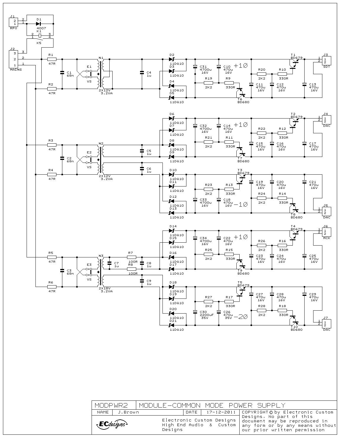

Hi Studiostevus,
I'm presently using John's MODPWR2 "bulk supply" before the Salas shunt regulators. These have a tremendous impact on the level of detail, the midrange is awesome! The ripple reduction circuit does a great job of bringing down the noise to virtually nothing which I believe is contributing to what I am now hearing. One think I did not use is Schottky diodes; just sticking with regular 1N4007 diodes and added a tuned RC snubber on each diode.
I'm presently doing my PCB with the Salas Shunts on the same PCB as the TDA1541A S2 (I can do quick proto PCB's in my shop which are pretty good). Will it be a bit bigger? Yes...worth it? yes. I'm using the Salas in a couple of other parts of my system - in my preamp, and as the first stage driver regulator on the power amp - can't live without them. Is John's new regulator better? Possibly (and I may try it) but right now I'm sticking with what has worked well and sounds great.
Hope John doesn't mind, I've attached his bulk supply schematic from an earlier post. (if you don't have it)
Gary

studiostevus,
We are indeed on the same road 😉
I think the MODPWR2 is a "bulk supply", meant as a super-clean pre-filter for the regulators. The voltage out of them is just the right overhead for the Salas shunt input, for the TDA1541A might be a bit high! 😱
Before I was using a CRC filter (4700uF caps) and there's no way that sounds anywhere like the MODPWR2, using that ahead of the Salas shunts is a whole new level! Highly recommended!
For the DAC only, I decided that 3 Salas shunt regulators were adequate. For the reclocking, I thought why not a well designed standard regulated but low noise supply? Less room, less headache. Also, for the on board shunts, I'm using TO-220 FETs which can use a smaller heatsink (in lieu of the plastic pack IRF240/9240 types)
To save room on the reclocking, DAC bulk and CTL PCB's, using surface mount where possible and through hole audio grade parts in any signal paths.
I opted out for an SRPP stage using Siemens CCA tubes, the sound surpasses anything else I tried. I managed to tweak the circuit to get the 2nd harmonic down to -93dB. Totally happy with it! For I/V, I'm using a Takman 2W (100 ohm) in parallel with a Mills MRA5 (120 ohm) giving me about 54 ohms, perfect with the tube stage, smooth sound and great dynamics. I'm still at a bit of a loss to understand the argument against using an I/V resistor, combined with a properly designed tube stage it's great. At least running through my pair of Class A tube amps it sure sounds great!
So I end up with these 6 PCB's:

Gary, very elaborate reply.
You're right, the MODPWR2 is a pre-supply as far as I understand. John suggested earlier to combine it with the post regulators in post #4008. Have you tried any of this instead of the Salas shunts?
Aside from size, the Salas shunts need significant heatsinking. I recall it is recommended to have at least 100mA additional on the CCS on each reg. I think John has tested Salas shunt as well, but never adopted them (not sure why)...

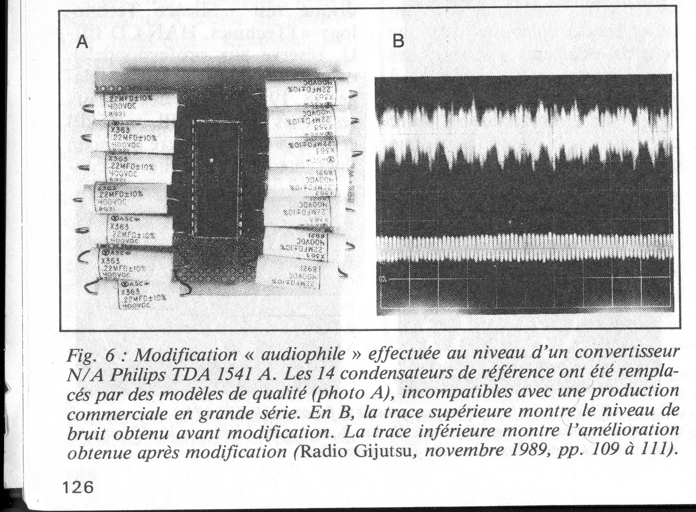

The mystery of lost bits solved
Bernard raises a 'killing concern'
and dismisses the TDA1541 altogether. But he may be jumping to conclusions, his argument looks like the technical rebuffing of the TDA1540 (that concatenated the bits from 16 to 14).
So what do I think the real reason for the off-measurements are?
In an article in L'Audiophile no. 13 (nouvelle série), Déc. 1990 Jean Hiraga writes about low signals with as general conclusion that it is clear that multibits gives the best outcome, but analogue even is better. There are many steps affectionados have to take to make great implementations, he mentions, like power supplies and earthing.
Have a look:
A revealing picture.
It shows the effect of stock ceramic capacitors on the signal, and how the performance of the chip can be with audiophile caps. Yes, stock is is bland and noisy, but with audiophile caps of 220 nF there is a clean signal. Very revealing.
It underscores the importance of good caps, and John has taken the utmost in finding good caps with a short signal path and low inductance.
For me the TDA1541 and TDA1543 are chips that sound lifelike and analogue, and 'tube-like' even if the latter is sometimes somewhat raw. They sound warm and I can pull up the volume.

1) A simple test: 1 khz -60dB or - 80dB dithered sine wave displayed on a spectrum analyzer without averaging will show the noise floor. Comparison with other DACs will reveal the truth.
Have a look:
albert

Roger, did you need to put any heatsinks on the MODPWR2 ?
I used the small clip-on heatsinks, they proved adequate for the power dissipation. This may not be case for you studiostevus if your transformer secondaries are different from what I am using.
Gary
Here's a link to what I used:
Digi-Key - 345-1087-ND (Manufacturer - 274-2AB)
Gary
Hi triode_al,
That's bernhard's personal opinion.
I rely on facts like Philips datasheet specs and publications that specify Edl of typical 0.5 LSB and MSB change glitch of 0.25 LSB for TDA1541A. These were carried out using a decent lab measurement setup. Poor TDA1541A application and / or measurement setup can lead to different measurement results and that's probably what happened here.
We talk about LSBs and 16 ... 24 bit resolution and how important it is to gete every last bit.
Imagine we visualize bit resolution by translating DAC full-scale output signal to say a distance of 10 kilometer or 1,000,000cm. Then a LSB change on a 16 bit system would represent 1,000,000 / 65,536 = 15cm on a distance of 10 kilometer.
For a 24 bit system a LSB change would represent 1,000,000 / 2^24 = 590 micrometer or 0.059cm on a total distance of 10 kilometer.
With these high to extreme resolutions, the limits of audio equipment will be the dominating factor, not DAC bit resolution.
Indeed, it shows two examples of ineffective active divider decoupling.
Bernard raises a 'killing concern' and dismisses the TDA1541 altogether.
Have a look: TDA1541 lot bits.jpg A revealing picture.
