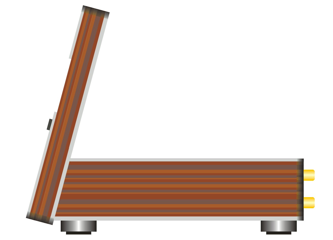

Can you give some informatons about the mechanical concept of the SD8-Player.
SD8-transport, DAC and volume control are housed in a tilted vertical panel measuring 160mm x 260mm x 15mm. It's mounted to a base measuring 180mm x 180mm x 40mm containing power supplies and connectors.
I attached some sketches.
Housing consists of sandwich construction of aluminum sheets and wood.
