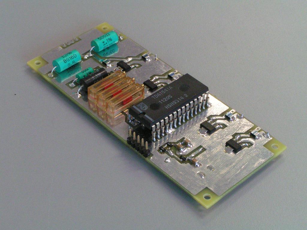

The latest version is the TDA1541A-MK10. It runs either on local shunt regulators powered through passive multi-order balanced filters or from passive multi-order balanced filters with embedded zener diodes.

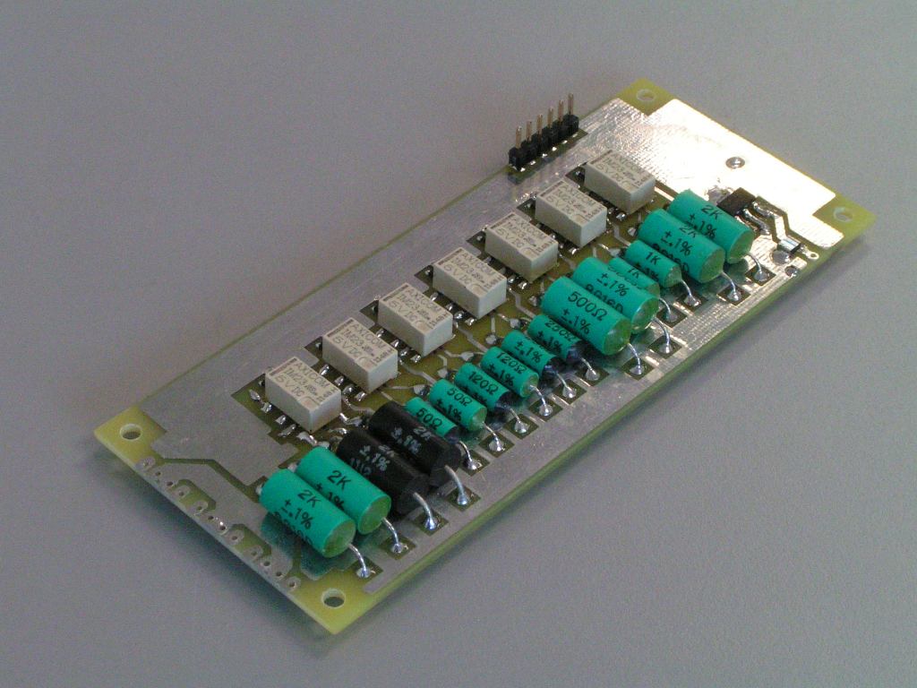

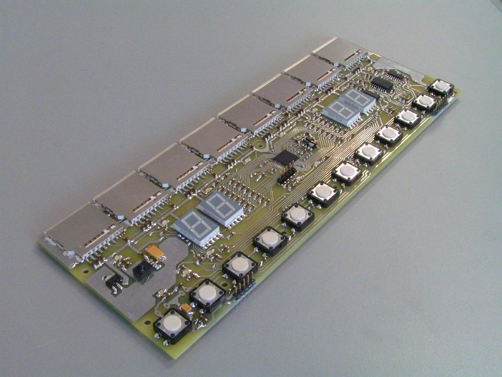

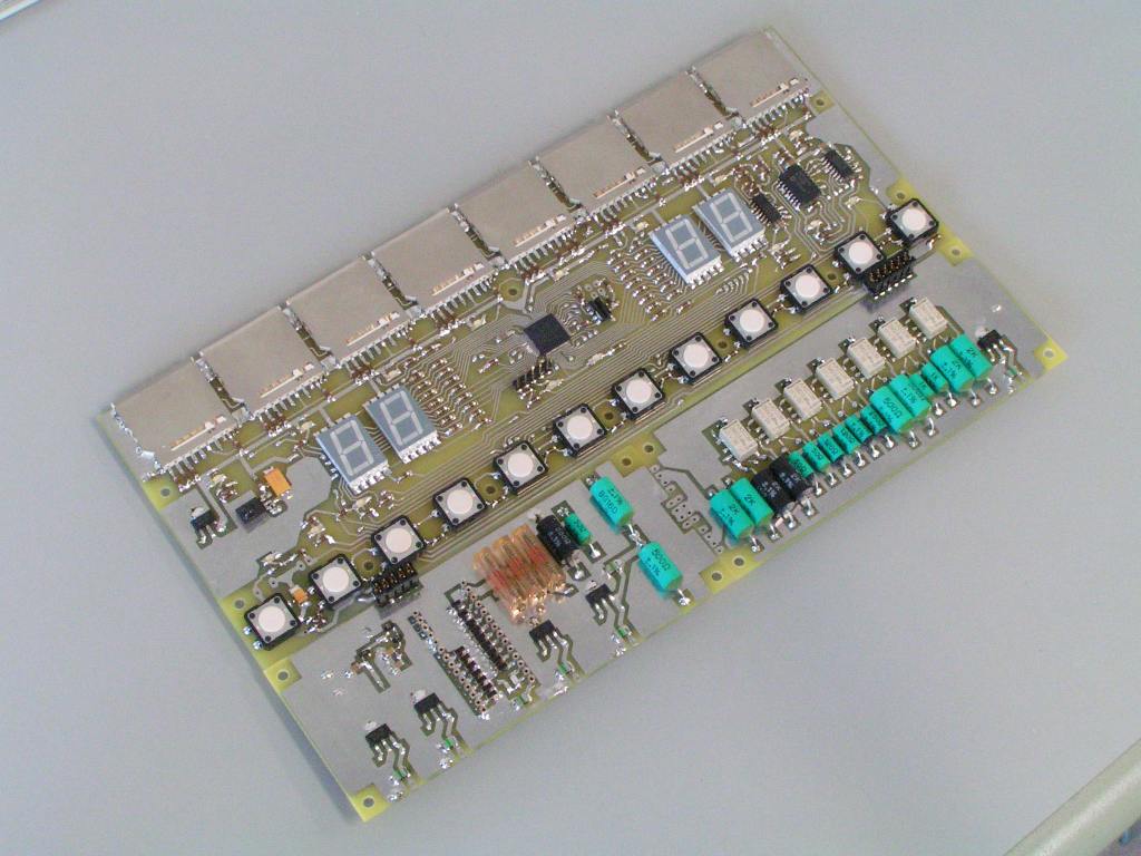

This module will be part of the SD8-player project (attached pictures).
First picture shows SD8-transport, TDA1541A-MK10 DAC and stepped shunt volume control modules as they will be mounted in the 15mm thick housing. Following pictures show the SD8-transport, TDA1541A-MK10 and stepped shunt volume control modules.
The SD8-transport offers local storage of up to 1 Tera bytes (using 128Gb SDXC cards). Theoretical limit is 8 * 2 = 16 Tera bytes. It has IR-USB interface for optional computer-based browsing, IR remote control and local keyboard. It runs on a single microcontroller. System clock is kept as low as possible (28.288 MHz) in order to minimize ground-bounce. Display is static (no multiplexing).
The TDA1541A-MK10 has 4 on-board discrete shunt regulators, masterclock / clock buffers / clock dividers, DC reference (DC-coupled output), RF JFET current buffers, and the latest soft-sync DEM clock.
The stepped shunt volume control is based on Rhopoint resistors and low power signal relays with gold-plated contacts. It has one AUX input for an external audio source. There are no relay contacts in the series with the signal path. It has 1 on-board shunt regulator.

There are some fundamental improvements in the MK10. This leads to a similar effect as if a blurry faint image is suddenly turned into a sharp realistic image with saturated colors and flood of detail.
Have you given away using the honeycomb mobius loop resistors?
The Honeycomb Mobius resistors are fine but it takes a lot of time to manufacture them and that makes them very expensive. These resistors are used in the MK10 (4 pieces), volume control (16 pieces) and Circlotron monoblocks (6 pieces). So I looked for a readily available replacement resistor with similar properties.
Are you still mounting the current divider caps directly to the dac legs under the chip?
Both is possible now, PCB or chip mounting. I used PCB mounting on the MK10 prototype for easy chip comparison.
I've never seen those green G.R. resistors before, might have to look into them, do they perform much better?
They are Rhopoint non-inductive wirewound precision resistors (0.01 ... 0.1%).

I use RS232 interface on the SD8-transport processor. Next I use a readily available RS232 > USB converter to enable USB communication.
However, RS232 TX and RX signals from the SD8-transport processor run through slotted IR sensors with at least 2mm air gap. This offers -full- galvanic insulation and vanishing low coupling capacitance between SD8 electronics and connected RS232 > USB converter.
SD8-player only requires short commands at low speed (9600 baud) so we don't need complicated high-speed isolators.
