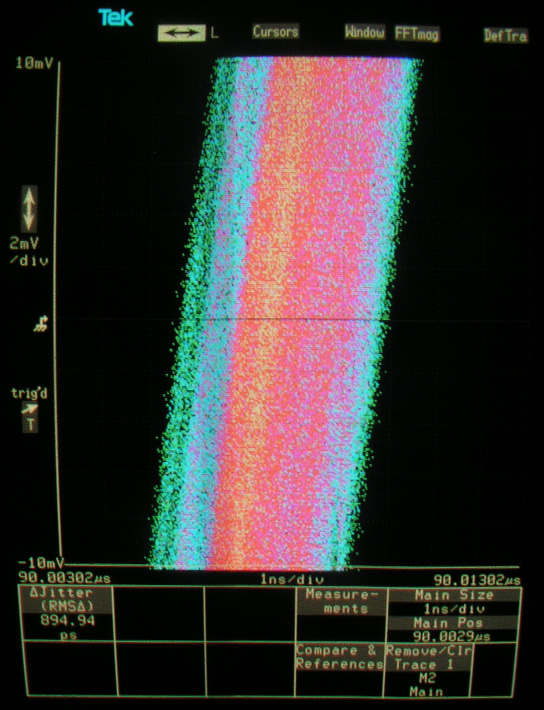

If I had to question one sort of audio measurement, I would name jitter measured with a analog scope.
One example of noise floor below.

In recent years I was very lazy but now I have a sampling scope with a horizontal resolution of 1ps/div and around 1ps intrinsic jitter.
Could help me to continue working on the digital section of my DAC.
I still have to get familiar with it.
This is 100kHz output from a "function generator":
