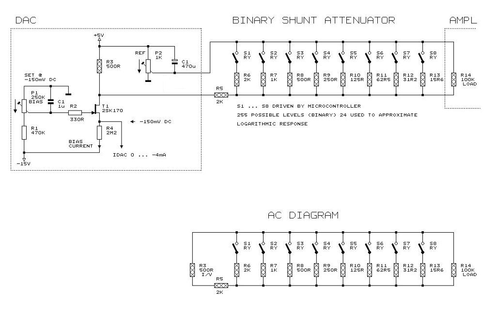

Hi marconi118,
The 500 Ohm passive I/V resistor is also part of a binary stepped shunt volume control. So I basically vary I/V resistor value by shunting it.
Hello, could you please post a principle schematics of this?
I attached a schematic.
In the MK9 I am experimenting with different JFETs and MOSFETs, JFETs require negative bias voltage, MOSFETs positive bias voltage.

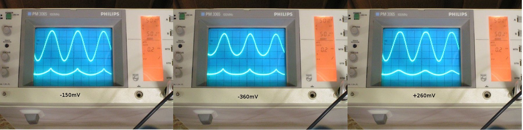

The effects of TDA1541A output compliance on output signal THD depends on the application.
Second picture shows oscillograms of the JFET current buffer.
Oscillograms show effect of varying DC level on DAC output. With this circuit I can vary DC level by changing JFET gate voltage (source voltage then "follows").
Upper channel shows output signal (using 1 : 10 probe).
Lower channel shows signal at the TDA1541A output ( using 1 : 10 probe).
Measured distortion is lowest @ -150mV with this application.
FET current buffer input impedance has limits (20 ... 50 Ohms). The impedance alo changes with drain current (impedance increases with decreasing drain current).
This explains the peak signal @ 500mVpp (iD = 0) and lowest level when iD = 4mA.
Adding a constant bias current reduces ac voltage at the TDA1541A output, but (RF) power supply noise and CCS equilibrium noise will mask LSBs. This only works when using a CCS with at least 100 MHz bandwidth, impedance greater than 2 M Ohm over this entire bandwidth and very low thermal drift.
The signal shape at the TDA1541A output pin can be explained by the fact that FET current buffers have certain impedance (20 ... 50 Ohm typical) and that gain reduces with drain current. So the peak signal occurs when TDA1541A output current approaches / equals zero (lowest gain).

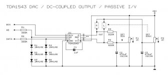

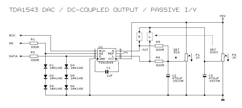

Hi maxlorenz,
Good. Now we need a current buffer fot the output of the humble TDA1543...I don't remember seing any... As it has only positive supply, I imagine Mosfet would be ideal...
TDA1543 output circuit is different from TDA1541A and needs no current buffer.
I attached schematic of a TDA1543 DAC with DC-coupled outputs and passive I/V conversion.
This is the best performing (and easiest to build) TDA1543 circuit I designed so far (tested on MK9 prototype setup with latest timing module).
R1, R2, D1 ... D6 are WS / DATA limiters (1.8Vpp).
C1 is a 1uF 1210 SMD film cap soldered directly to TDA1543 pins 4 and 5 as close to the plastic housing as possible.
R3 and R4 are passive I/V resistors that offer approx. 0.0025 * 820 = 2.05Vpp output signal.
P1 is passive I/V resistor bias voltage (adjust to 3.2V).
P2 provides DC-coupled outputs (no coupling cap required). Adjust P2 for lowest DC offset on R and L outputs. This would give around 2.2V on the wiper of P2.
TDA1543 requires a super clean 5V power supply (balanced or battery power supply) and ultra low jitter BCK signal with white noise residual jitter spectrum.
