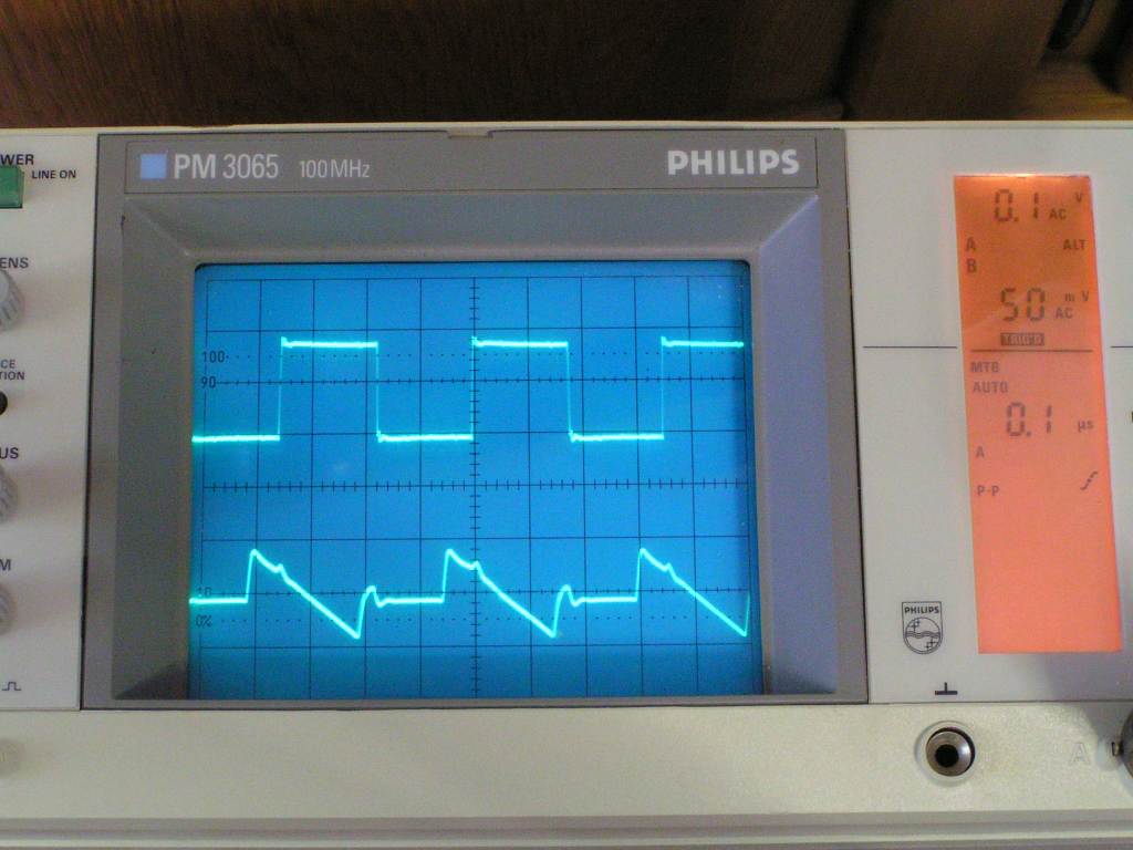

Hi roger57,
The DEM circuits are still part of the function of the clock board? I imagine you are not changing how these are generated and connected?
TDA1541A DEM oscillator is now soft-synced with 2.8224 MHz bit clock (attached picture). Sync signal is now taken from pin 2 (BCK) only.
Upper trace shows bit clock (amplitude equals approx. 1.9Vpp). Lower trace shows DEM clock signal (amplitude equals approx. 900mVpp). The spikes on the DEM clock sawtooth signal are caused by synchronization by BCK.
The bit clock is derived from the masterclock using two UHS D flip-flops that form a synchronous divide-by-4 Johnson counter.
Both, new masterclock module and better performing DEM clock resulted in more transparency and more unmasked flaws.

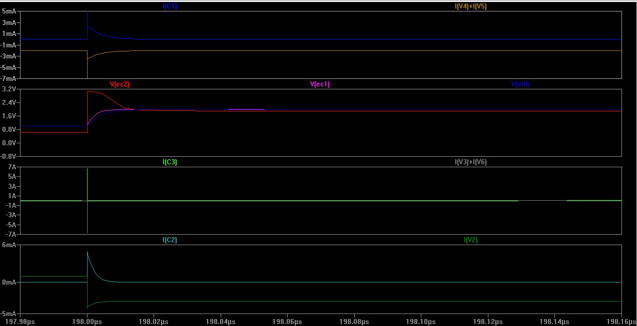

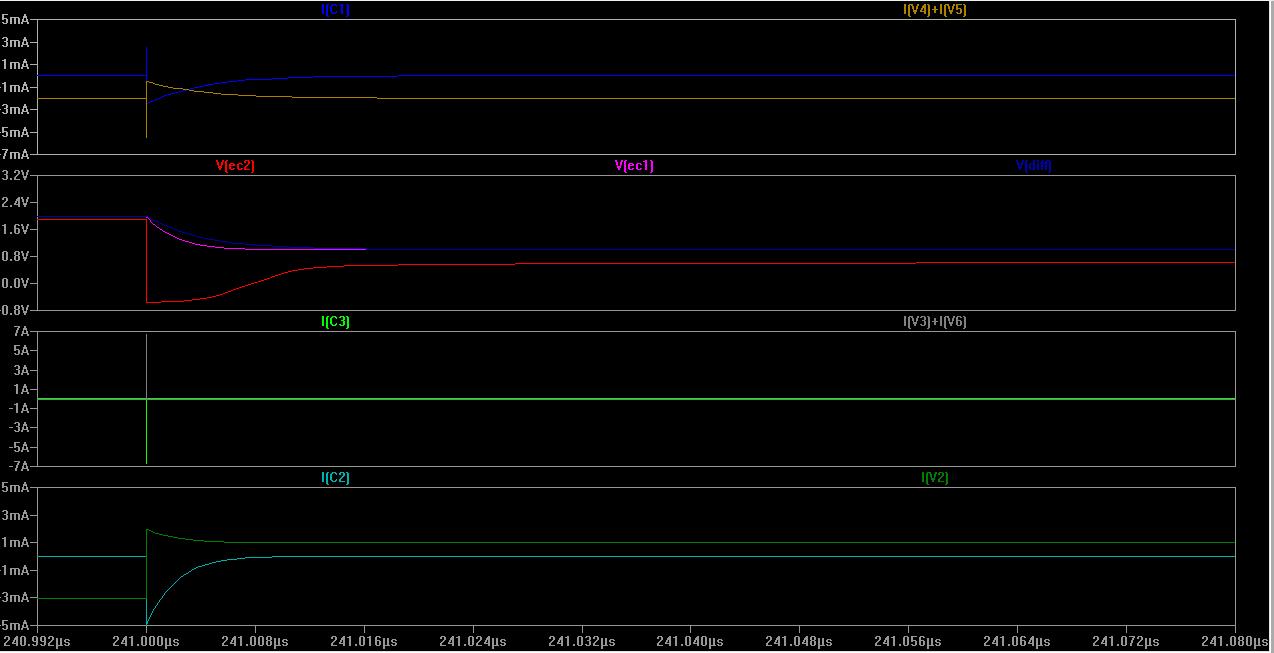

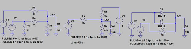

I did some playing around comparing some different level translator circuits for the 1541', assume the 10pf is the actuall input capacitance of the dac you can see how much is injected into it.
I think there might be room for some improvement with regard to the back to back diode solution.
Note tough the rise / fall times are intentionally set high (wich exacerbates things)

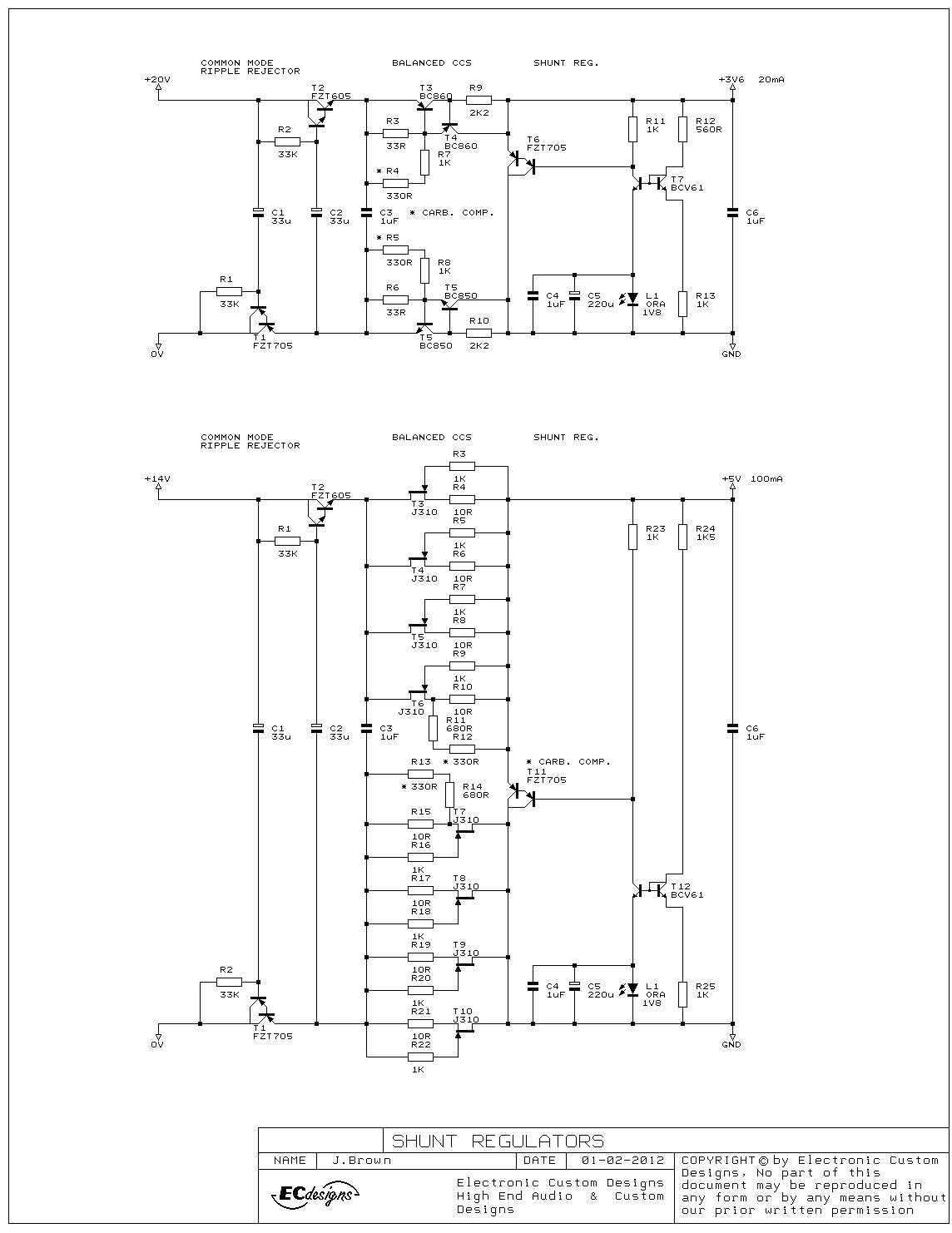

Hi roger57,
Also interested in your regulator specifics and what you have found there.
I attached schematics of common-mode shunt regulators I am currently experimenting with.
First diagram is the 3V6 shunt regulator for the sub miniature timing module. It is set @ 20mA. It consists of a common-mode ripple rejection circuit (T1, T2, R1, R2, C1...C3). This circuit provides a clean non-stabilized DC voltage.
Constant current sources are placed in feed and return lines, different types of CCS can be used here. The main function of these CCS is increasing impedance between load and transformer.
Regulator noise spectrum has big impact on sound quality, even if it's in the nanovolt range. I suspect this low level noise still manages to modulate masterclock and cause trigger uncertainty in logic circuits and D/A stage.
R3 and R5 (carbon composition resistors) are used as pink noise generators. Their signal is attenuated and summed to current sensing resistors R3 and R6. Regulator noise spectrum modulates the masterclock frequency. Since power supply noise cannot be reduced to zero, and the noise spectrum of power supply and masterclock combination may not be ideal, this noise spectrum tuning becomes necessary in order to approximate perfect tonal balance.
The shunt regulator is a straight-forward circuit consisting of a high gain Darlington (T6), filtered LED reference (L1, C4, and C5) and a temperature compensated transistor (T7).
The second shunt regulator is intended for TDA1541A +5V supply and low impedance reference voltage (DC-coupling), it is set @ 100mA. I used multiple JFET CCS in parallel here in order to achieve low voltage drop. It is also possible to use different CCS here, depending on input voltage / voltage drop.
Since these are "floating" supplies it is possible to connect them similar to batteries. This way the same circuit can be used for positive and negative power supplies.
The -15V shunt regulator has 2 LEDs in series and value for R24 is increased to approx. 3K.
The common mode ripple rejection circuit must be located as close to the transformer as possible in order to keep wiring carrying ripple / noise voltage as short as possible. This way ripple and interference is mainly concentrated on the mains power supply module.
The clean DC voltage is fed to the regulators using (shielded) twisted pairs. Shunt regulators must be placed as close to the load as possible, in order to achieve this they should be built as compact as possible, 10 x 20mm PCB for example. It is also desirable to fully screen the shunt regulator PCBs in order to maintain low noise levels (EMI).
