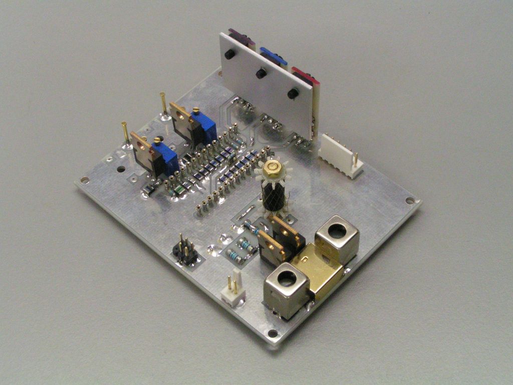

Latest MK6 has (charge compensated) 1uF 1210 size SMD film decoupling caps. Active divider decoupling caps are now 330nF 1206 size SMD film caps. Circuit is built on HF board and TDA1541A is mounted on an "open frame" socket in order to increase isolation resistance between the active divider decoupling pins.
I attached a photograph of this MK6.
For the digital section (SD-transport) I still use 1uF 1206 size X7R decoupling caps but I also plan to test 1uF film caps here.
Why do you never solder the TDA1541 chip directly to the board? Are you making too many changes all the time?
Easy DAC chip swapping for testing different chips. Verifying correct circuit operation prior to installing the DAC chip. Easy trouble shooting (damaged DAC chip). Easy access to the parts that are mounted directly underneath the DAC chip such as decoupling caps. Cooling, the socket allows airflow underneath the chip and helps to keep chip temperature more constant. Varying chip temperature affects bit accuracy (passive dividers). Avoiding thermal stress that would occur during soldering. This thermal stress could affect chip (long term) accuracy and reliability.
