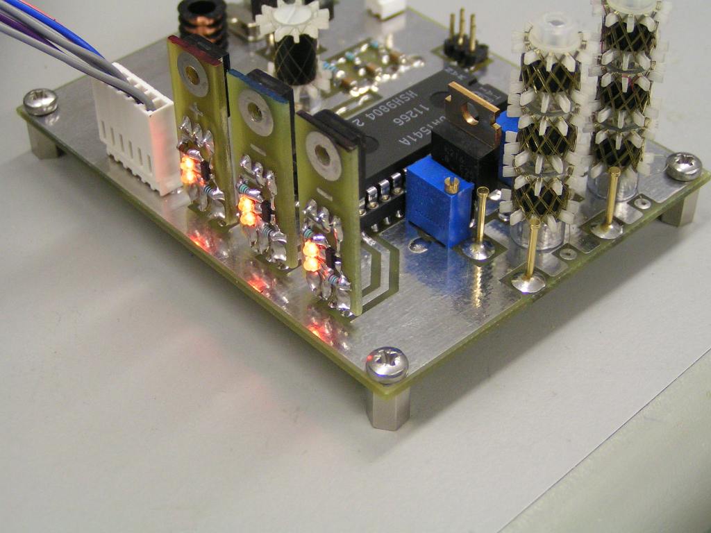

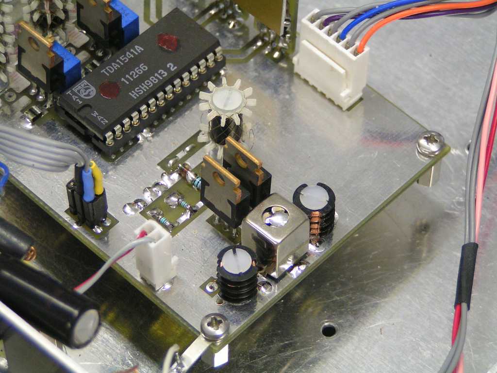

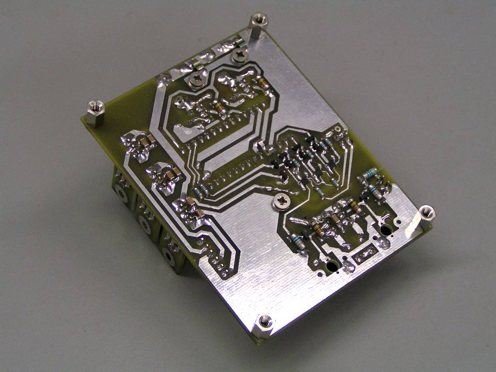

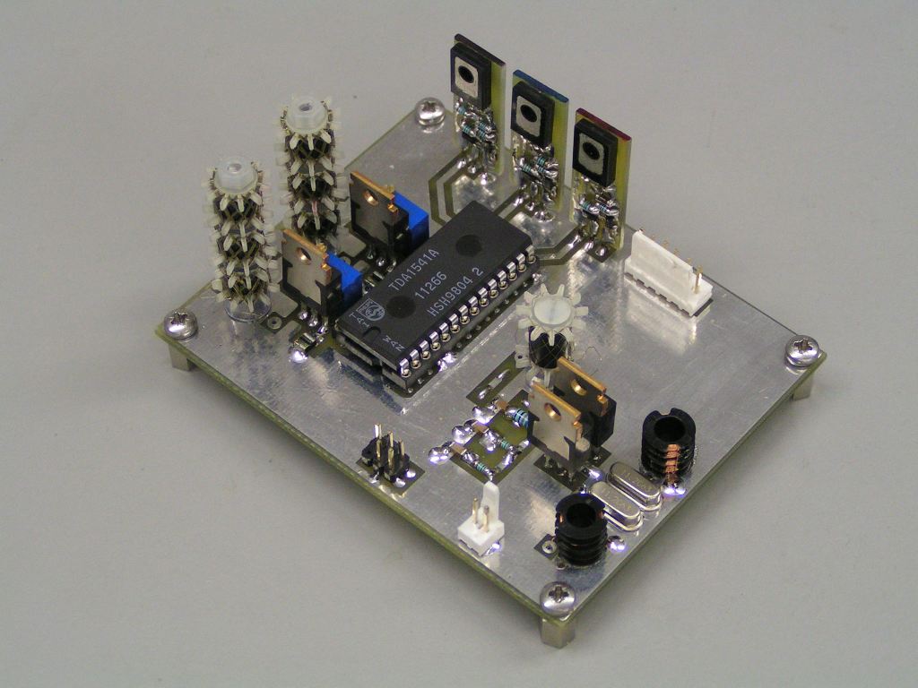

TDA1541A-MK6 prototype completed.
Hi galeb,
Here's another,
Yesterday I completed a TDA1541A-MK6 prototype PCB, see attached pictures.
The module is small, it only measures 94 x 72mm.
The discrete voltage regulator properties allowed removing all electrolytic capacitors and LC filters on the PCB.
The module basically contains +5V, -5V, and -15V discrete regulators, balanced masterclock, I2S synchronous reclockres, balanced DEM synchronizer, TDA1541A, and output stages.
The balanced masterclock is built around two power MOSFETs, two matched crystals, and two multi-segmented air chokes. The multi-segment construction lowers choke self capacitance. Masterclock output signals are rectified using RF Schottky diodes. Masterclock is powered from +5V using a RC filter. The resistor is a 40 Ohms Honeycomb Mobius resistor for maintaining low noise levels.
The synchronous reclocers are also powered through RC filters, 680 Ohms for the bit reclocker / DEM synchronizer and 1K5 for DATA and WS reclockers.
The 14 1206 size SMD film decoupling caps are mounted underneath the TDA1541A.
The output stage is the latest grounded gate MOSFET current buffer driving a 500R passive I/V resistor. MOSFET gate voltage can be adjusted with a trimmer in order to set required DC voltage at the DAC outputs. SMD 1uF film caps were used for gate decoupling. TDA1541A outputs are loaded with 220pF 805 size SMD film caps, this minimizes RF / HF noise and glitches.
The passive I/V resistors were further optimized (lower self capacitance) by using multi-segmented Mobius Honeycomb wire wound resistors. Plain twisted Mobius loop (non-inductive) of 5 meter wire results in approx. 270pF self capacitance. The Mobius Honeycomb construction reduces this to approx. 94pF. The multi-segmented construction consists of 3 segments with approx. 45pF each. This results in approx. 15pF self capacitance.
The I/V resistor low self capacitance allows for higher external capacitive loading (interlinks) and offers improved sound quality.
The coupling caps are placed externally. I am using 6.6uF charge compensated Mobius Hybrid caps at the moment. These offer improved performance at low level voltage changes and reduce typical film cap distortion.
In order to prevent ground loops when connecting external equipment like power amps, 1 : 1 or 1 : 1 : 1 studio isolation transformers can be used. These can also provide balanced outputs.

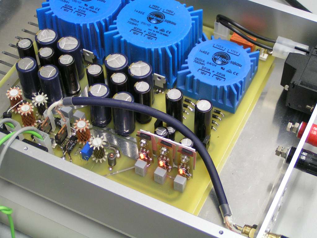

Circlotron questions
Hi ECdesigns,
According to your circlotron circuit. I have some questions to ask you.
- How to measure and adjust P1 and P2?
- How much power rating of R16 and R17?
Could you please post your photo of your circlotron amplifier?
Thanks & regards,
Hi ECdesigns,
Thanks & regards,
Hi MamyPoko,
P1 sets the bias current through the Circlotron output stage. It's easiest to use a cheap energy cost meter that has an indication for power consumption (watts). Make sure P1 is set to its maximum value before powering up.
and then slowly turn P1 until the meter indicates approx. 11 watts. Make sure to use a high quality multi turn pot for P1.
P2 sets the DC offset on the output, adjust for 0V DC. It may be necessary to repeat P1 adjustment after adjusting P2.
200 ... 500mW.
I attached a photograph of the latest version of the circlotron power amp.
200 ... 500mW.
