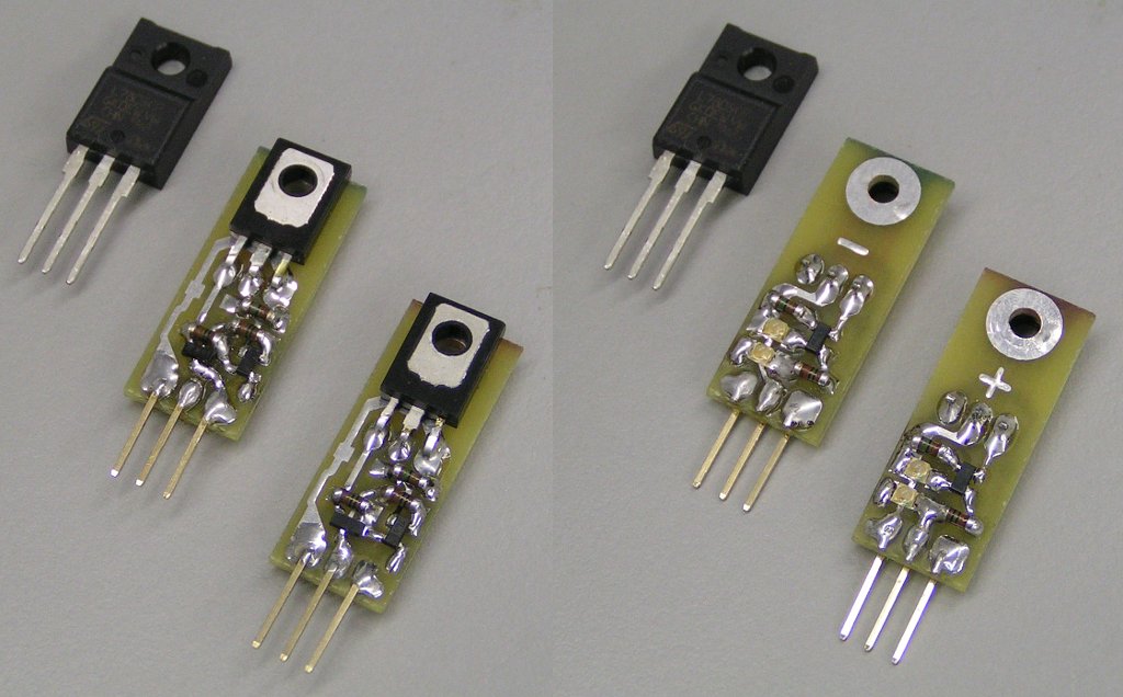

This week I tested discrete series regulators, these were designed for large bandwidth, low noise and fast tracking. PCB size is small enough (11 x 28mm) to replace 78XX and 79XX regulators in existing designs. The regulators are based on 2 current mirrors (BCV61 / BCV62), 2 transistors, 5 resistors, and 2 LEDs (reference), so 11 parts in total. I designed both, a positive and negative regulator. Short circuit protection is provided by combination of constant current source driving the series transistor, and series transistor DC gain (around 40).
Sound quality of these discrete regulators is a lot better compared to IC regulators. It appears as if IC regulators color the sound, add grain and limit resolution.

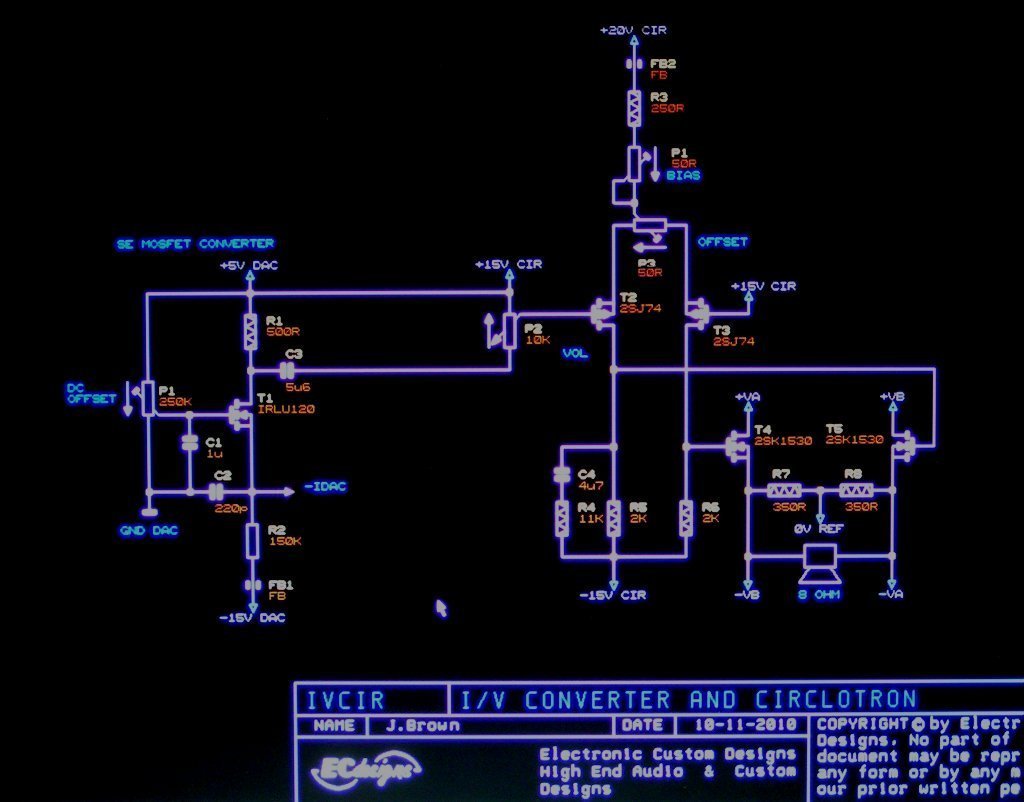

Hi gaetan888,
I attached a quick screen shot of analogue signal path schematics of my set, no JFETs required here. I only have 5 power MOSFETs in the signal path between TDA1541A and speaker.
I/V converter is built around T1 that's operating in grounded gate mode. Many different power MOSFETs can be used here. P1 taps suitable DC offset voltage from passive I/V resistor R1, blocks the audio signal using C1, and feeds it to the gate of T1. The "interference" that passes C1 only introduces ever so slight negative feedback as the interference is the audio signal itself.
DC voltage at the DAC can be trimmed down to zero volts with multi turn trimmer P1. C2 band limits the TDA1541A output prior to feeding the power MOSFET current buffer. Bias resistor R2 prevents T1 from going out of conduction by drawing 100uA bias current. R2 value is high enough (150K) to minimize -15V rail noise injection. C3 blocks DC and is the only coupling cap in the signal path. One coupling cap is always required (safety) in case the I2S stream stops for some reason and the DAC chip latches the last received data.
This converter has approx. 14 Ohm input impedance, this results in approx. 56mVpp at the DAC output. 50mVpp would be ideal (+/-25mV compliance) but it comes very close. This converter feeds all bit currents into +5V DAC power supply for best performance.
Note that volume pot P2 is connected in parallel with the passive I/V resistor R1. GND of both converter and power amp must not be connected. This removes the DAC +5V power supply from the direct signal path. So I am basically "measuring" the ac voltage across R1 only.
The thingy on the right is my latest Circlotron MOSFET power amp. PowerFETs T1 and T2 form a differential input stage (gain = 15). P1 sets the bias current (and voltage drop across R5 and R6). This in turn sets the bias current in the Circlotron bridge output stage built around Power MOSFETs T4 and T5. P3 sets the DC-offset voltage on the speaker output (note that this power amp is fully DC-coupled!). C4 and R4 fixes the gain difference between T2 (grounded source, high gain) and T3 (grounded gate, lower gain). R7 and R8 provide reference for driving powerFETs T4 and T5.
The Circlotron bridge output stage doubles the output signal across the speaker (measured total gain equals 30x). With 0.7V rms DAC output this results in max. 21V rms across the speaker. This enables max. output power of approx. 55 watts rms in 8 Ohms or 110 watts in 4 Ohm.
Because of the use of power MOSFETs exclusively (substrate mounted on heatsink), thermal memory effects are minimized. The few components in the signal path ensure both, very high resolution and transparency.

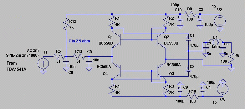

So I've mods an existing bjt I/V amp for a nos TDA1541A, there is an input and output 20khz low pass filters.
What do you think of my circuit ?
BJT version of the ZEN I/V converter with added filters?
Its a clever design but has drawbacks. Filters are debatable, I try to avoid them whenever possible (phase shifts).
The TDA1541A operates optimally when all bit currents flow back into +5V TDA1541A power supply. This is not the case here.
You need 2 very high quality wire wound passive I/V resistors. These resistors make or break sound quality as they perform actual I/V conversion.
TDA1541A only sinks current and sinks 2mA bias current, this might affect circuit performance.
Both C1 and C2 are over dimensioned, lower value film caps can be used instead.
R12 injects significant power supply noise into the DAC outputs.

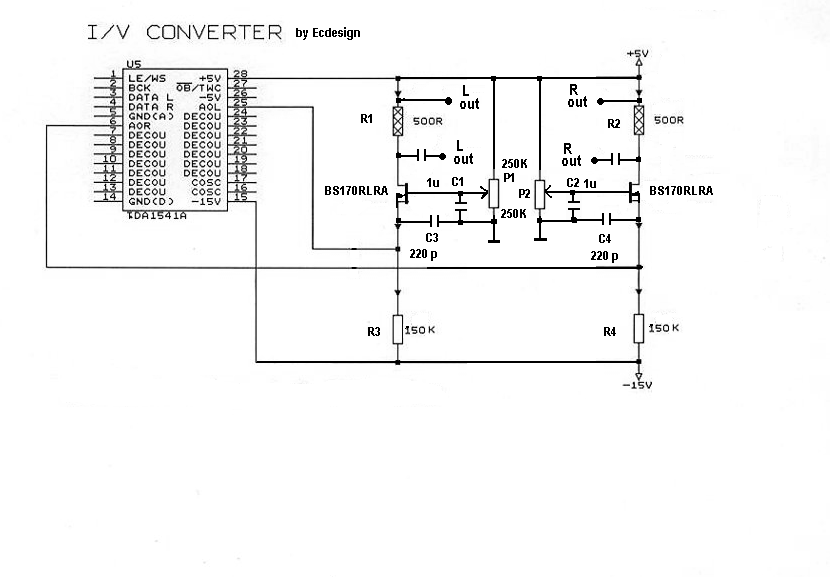

Hi gaetan8888,
I just tested BS170 in the converter and it works. Your redrawn circuit is ok.
I haven't re-checked this but the bias resistor (and resulting current) also affects converter input impedance. With BS170 output compliance of 50mVpp is fully met when using 5K bias resistor.
In practice it's a trade-off between meeting output compliance (low bias resistor value) and minimizing noise injection from the -15V rail (high bias resistor value). You can experiment with bias resistor values between 5K and 100K and settle for the value that offers best perceived sound quality.
I only have BS170R mosfets, is it ok ?
I've redraw your circuit so it be connect to the TDA1541A, to be sure I've understand it correctly.

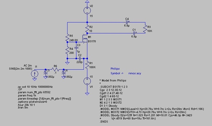

Hello John
Missing few parts to built it for now, but I've simulated it, using a 2ma sine current source to replace the TDA1541A
It's not as the real TDA1541A since that using more sine current source do overload it.
Here is the image and the Ltspice asc file into a text file.

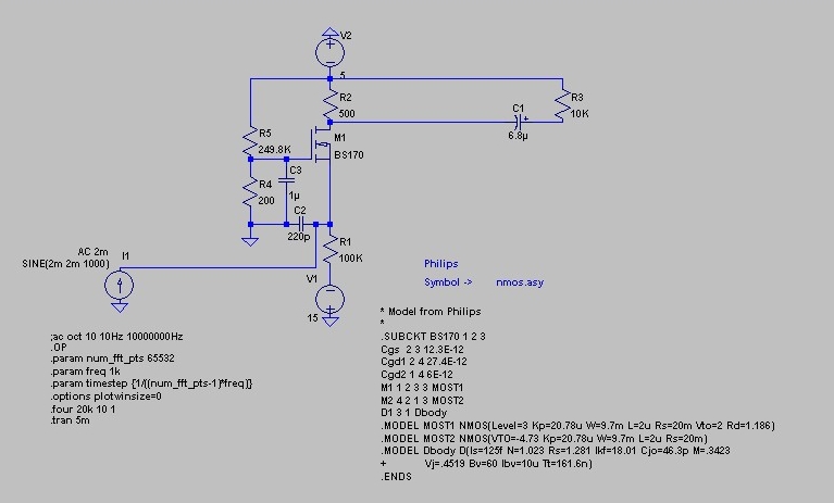

Hello John
I have done an error in my simulation, the 5 volt dc are inverted.
I will redo the simulation.

Max output power with 0.7V rms from the TDA1541A-MK4 module equals 0.7 * 30 = 21V rms. This results in max. 55 watts in 8 Ohms with given 15x input / driver stage gain.
Yes, approx. 25 watts in 8 Ohms.
You could try MOSFETs similar to these:
STMICROELECTRONICS|STE53NC50|MOSFET, N, SOT-227B | Farnell Nederland
Temperature compensation would also be required.
One MOSFET for each bridge half. I tested multiple matched MOSFETs in parallel, but this resulted in degrading (loss of resolution and transparency). Note that this design has only 4 power MOSFETs in total and has no global feedback to cover-up flaws.
Higher power consumption will also significantly increase power supply noise (transformer EM fields and rectifier switching noise). Stepped rectifiers would be a must, and the transformers need to be placed further apart to avoid coupling between the EM fields of both transformers powering the Circlotron output. In order to minimize magnetic coupling it would be best to use toroidal transformers that offer low external magnetic field.
Note that with a circlotron power amp the speaker (output) sits between both power supplies. Any (capacitive) coupling between both power supplies would then occur in parallel with the speaker / output.
I am interested by your Circlotron deign. I though, I have read that you biased this amplifier in class A operation. Somewhere you said 55W output.
Circlotrons can work in both class A or AB. I run it in class AB (200mA bias).
Output stage runs on 2 separate 25V / 25VA power supplies, this consumes 10 watts during idling (5 watts for each FET). This way I get around 25 watts rms in 8 Ohms. Differential input / driver stage runs on 18mA bias (class A) and offers 15x gain. The Circlotron bridge output stage doubles it to 30x.
Examining the power supply section in your post 3467, I presume the 25va transformers are for a lower output amplifier?
The class A operation interest me, so dissipating 100W of heat with 2 devices will make the temperature rise to unsafe limits.
What would be a maximum of devices before degrading the preformance?
Of course it will require sufficient heatsinking and adequate supply, but do you have any suggestions, or changes for such a project?

Discrete mini regulators
I attached some pictures of the completed discrete regulators that I plan to use in both, TDA1541A-MK4 and Circlotron.
I made a positive (78XX) and negative (79XX) version. The PCB measures approx. 11 x 28mm. Voltage is indicated by a color on top of the PCB.
Both voltage and max. output current (short circuit protection) are set by resistors. There are 2 sets of pads for voltage setting resistors for more accurate voltage trimming.
The regulators are pin-compatible with 78XX and 79XX regulators and can be mounted on a heatsink for higher output currents.
Low noise references (zener / LED) are used for CCS and error amp. These produce around 500nV noise, much lower compared to bandgap or XFET references.
Capacitors could be left out (low noise references and low impedance voltage divider) for achieving lowest possible sound coloration.
I also placed an extra filter between -15V rail and 150K bias resistors in the TDA1541A-MK4 module for better performance. The filter consists of 22K resistor in series with 10mH choke and a 470uF cap.
