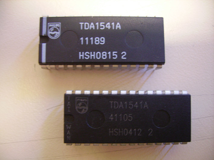

Hi all,
I have some units of the TDA1541A, and they all work. The dude is, if it is "remarked", because, it seems to be impossible that this chip was made from 2008, please, see enclosed. If someone knows something about this, just answer me please. I have 5 units manufactured from 2004, and they all work fine too. But these last ones I know that were made deliberately.
Kind regards,
Long life to the TDA1541:worship:

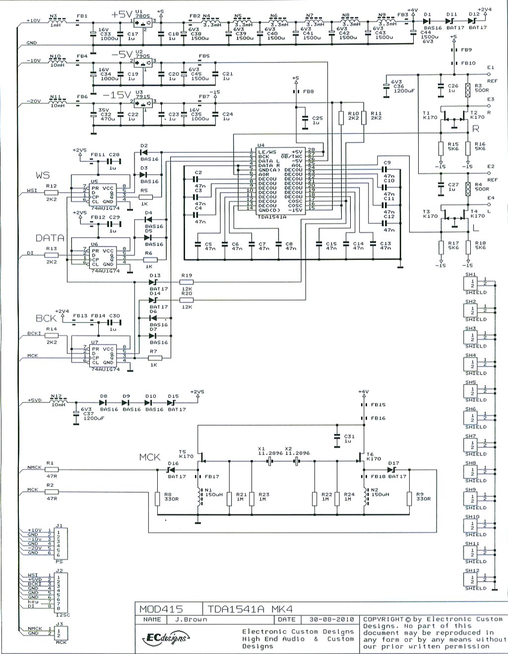

Final single TDA1541A DAC module, the TDA1541A-MK4.
After extensive (listening) tests and feedback from critical listeners, I decided the TDA1541A-MK4 will be the final single-TDA1541A DAC version.
I attached schematic diagram of the MK4.
Due to CAD system limitations, some parts appear double in the schematics (R15 ... R18 and R21 ... R24). This is caused by providing option for two different resistor types. In practice only 1 resistor is used.
Starting with the power supplies, +5V, -5V, and -15V regulators are same as with MK3 version, only ferrite beads are of different type.
The masterclock / bit reclocker supply filter has been modified to a 12th order LC low-pass. Additional voltage attenuators (D1, D11, D12 and D8, D9, D10, and D15) are used to derive required 2.4V / 2.5V for the synchronous reclockers.
TDA1541A decoupling caps are 47nF PPS 1206 size SMD, they are soldered underneath the TDA1541A for shortest possible wiring (RF decoupling).
DEM synchronizer consists of 2 Schottky diodes, 2 x 12K series resistors and 2 x 2K2 bias resistors. DEM clock rate = bit clock rate = 1.4112 MHz. because of this increased DEM clock rate, lower decoupling cap values can be used.
I/V conversion consists of 2 x 2SK170 in parallel (grounded-gate current buffer) driving a 500R passive I/V resistor. 5K wirewound bias resistors are added to ensure correct operation. Power amp (volume pot) connects between +5V and output. This removes +5V power supply from the direct signal path.
All I2S signals are now synchronously reclocked using very fast (low propagation delay / jitter) D flip-flops running on 2.4 ... 2.5V power supply.
latest I2S attenuators provide clean I2S signals that vary between +0.6V and +1.8V. This keeps on-chip ground-bounce low.
The new balanced masterclock with 2 outputs drives SD-transport and bit reclocker (only 1 clock load on each output). The crystals must be closely matched (same batch) and should have high Q factor.
Clock rectifiers D16 / R8 and D17 / R9 block the negative signal half of the masterclock outputs.
All chokes and masterclock / bit reclocker circuits are shielded.
The perceived sound quality from this MK4 is highly transparent and very natural. There are no audible (digital) artefacts nor "edge". Sound is very smooth, yet transient response is still fast. Due to the extreme black background (virtually inaudible background noise level), all details that are on a recording, including recording noise floor / spectrum will be clearly audible.

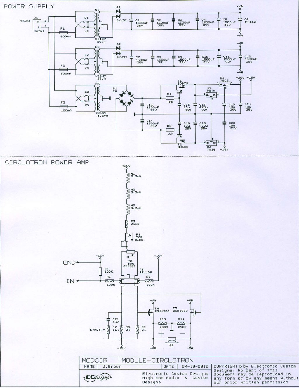

No it's quite different, I attached a concept schematic I am experimenting with.
Power supplies first, there are 2 main power supplies for the Circlotron (built around transformers N1 and N2). I used separate transformers instead of dual secondary windings in order to eliminate side effects of 5 ... 10nF typical stray capacitance between windings. This stray capacitance appears between both speaker terminals. Classical Circlotron stage requires 2 fully isolated power supplies.
The third power supply is for the input / driver stage only. First I remove ripple voltage (T1 and T2), next I create +20V, +15V, and -15V stabilized power supplies. The +15V (5V potential difference with +20V) is used as input reference voltage in order to enable sufficient output swing with this circuit.
By using a dedicated power supply for the driver stage, supply quality is not affected by the power stage. This enables very clean signal, even at high power levels. It also reduces both hum and noise to inaudible levels.
The circlotron power amp is about as basic as it gets. Plain differential stage (T3), DC-offset pot, bias pot and some chokes for both filtering and thermal compensation (PTC). Required gain is rather low (10 ... 20x) so a single differential pair will do fine.
Note that my main objective is obtaining highest possible resolution / best possible tracking of complex dynamic signals, not ultra low THD at 1 KHz sine wave.
The DC offset pot P2 is required to trim DC offset voltage across the speaker to lowest possible value. P1 sets exact bias current through the input / driver stage, and as a result of this, also the DC voltage drop across R8 and R9. These in turn control the bias current in the Circlotron power stage by varying Ugs.
I have around 17mA bias current running through R3. I use a watt meter to get some feedback about the bias current running through the Circlotron stage (approx. 150mA for each powerFET).
There is one catch with this simple input / driver circuit, symmetry. When driving this stage with a SE input signal, the ac voltage across R8 will be higher than the ac voltage across R9. Simply changing resistance value for either resistors would lead to imbalance in power stage bias currents as these are derived from voltage drop across these resistors.
So I used a RC circuit in parallel with R8 in order to maintain correct bias current and attenuating AC signal amplitude across R8 for correct matching with signal amplitude across R9.
When using balanced source, the RC symmetry circuit can be removed of course.
Actually it is similar to the latest I am also working on -- a simple gain stage followed by a Circlotron Source Follower.
As shown, the output impedance in balanced mode is 2x (1/Yfs) of 2SK1530, which will be around 1 ohm at 2A bias. For me rather too high. I suggest you look into devices like 2SK3497, maybe 2x parallel at 1A bias each, per circlotron side.

Hi maxlorenz,
I still think that power regulation/ripple rejection (and probably sound quality) could be improved on the different sections of the circlotron...but that is only a guess
Differential stages offer good PSRR, same with bridge output stages like the Circlotron. Power supply ripple and noise appears on both speaker outputs, and are rejected. The input / driver stage that already offers good PSRR is powered by a clean stabilized power supply. The input / driver stage only requires very little current (approx. 17mA), this also keeps ripple voltage very low. The input / driver stage also contains a hybrid choke (consists of multiple chokes and ferrite beads in series) in order to attenuate power supply noise and offer high impedance.
The H-bridge in my previous design also offered good PSRR but had the disadvantage of higher output impedance (2 powerFETs in series with the load), matching problems between N and P power FETs, and the need for two extra semiconductors in the signal path.
Very clever. It is good to use free advantages of nature..yet, cleaner rails won't hurt, I guess...I mean, as a DIYer, we always want to give a personal touch. 😀 (even if an experiment)

Thanks a lot for publishing the schematic. I'd like to use your reclock and dem circuits in my NOS dac. I only have the WS, BCK and DATA out of a CS8412 (used in master mode). No master clock is used, as I cannot send it back to the source. The clock out of the receiver is 2.8224 MHz.
1) 2.8224 MHz is maybe too high a frequency for the DEM synchronizer. Driving the CK input of U7 with the serial bit clock from the receiver and connecting Q and D together, I obtain 1.412 MHz out of the flip-flop. May I drive the BCK input of the TDA1541A with this signal?
2) Since I do not use a master clock, is there a point in re-clocking WS and DATA?
3) Which is the role of those anti-parallel diodes?

Hi Sandor,
BCK needs to remain 2.8224 MHz. DEM clock can be derived from BCK by using a divider, connect /Q to D input.
Without reclocking you will have 200ps MCK jitter (CS8412) plus SPDIF interlink plus source jitter. Without an ultra low jitter masterclock that shares the same time domain as the source, you will have no suitable clock signal for synchronous reclocking.
D flip-flop Q output = "1", and /Q output = "0", first diode conducts, output voltage equals 2.4 - 0.6 = 1.8V.
D flip-flop Q output = "0", and /Q output = "1", second diode conducts, pulling output low, however the 1K resistor connected to /Q feeds current through D2, so output voltage now equals diode saturation voltage of 0.6V.
The diodes, together with the 1K resistor connected to /Q create an attenuated I2S signal that swings between 0.6V and 1.8V. The TDA154x I2S input threshold voltage lies exactly in the center (1.2V).
This forms a simple, highly effective, and very reliable I2S attenuator.

Your I2S attenuator is a very clever circuit. Willing to implement this attenuator, even in absence of a master clock, I could use U5 and U6 all the same. The options for driving CP are:
1) using the 2.8224 Mhz signal from the receiver (pin 12 of the CS8412),
2) using the 1.4112 MHz signal out of the divider or
3) using the 11.2896 MHz signal out of pin 18 of the CS8412
Which option is best? Or should I better use a different attenuator?
