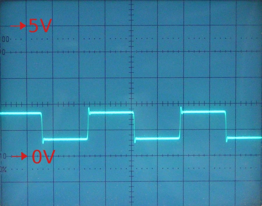

Hi phi,
There is a paradox, on one hand we need fastest positive transients (TDA154x output register triggers on positive transient of BCK) in order to minimize trigger uncertainty (and relating jitter). On the other hand we need slower transients to reduce the effects of ground-bounce. Like with most things, it looks we have to make a compromise.
Ok, I will try to explain I2S attenuator (and attached TDA154x input circuit) in detail.
Starting with TDA154x I2S input, it consists of a current source feeding 3 diodes that are placed in series. The junction between current source and anode of first diode is connected to the input pin through another diode, cathode facing the input pin. Input stray capacitance is specified at 15pF. The current steering logic is connected to the junction of current source and anode of the diode. You can find these specs and on-chip I2S input circuit schematics in the TDA1543 / TDA1541A data sheets.
Trigger level is typically 3 * 0.6V (3 diodes in series) minus 0.6V (input diode) equals approx. 1.2V, this trigger threshold varies slightly with chip temperature (diodes).
What I did was minimizing signal amplitude and providing 0.6V bias voltage level (this reduces ground-bounce). Positive transients are fast, negative transients are band-limited by a 1K resistor that is part of the new I2S attenuator. Furthermore I prevented simultaneous switching of I2S and DEM signals, this further reduces ground-bounce.
Input = 0, /Q supplies +2.4V through 1K resistor. Q = 0V and pulls 2.4V down to 0.6V by diode 1. Result: 15pF is discharged from 1.8V to 0.6V through 1K / 15pF RC filter (band limiting).
Input = 1, /Q output places 1K in parallel with 15pF, Q charges 15pF through D2 as fast as possible, max. amplitude equals 2.4-0.6 = 1.8V.
So we have fast positive transient from 0.6 to 1.8V and slow (band limited) negative transient from 1.8 to 0.6V.
In order to further minimize ground-bounce on the critical positive transient of BCK, DATA, WS and DEM signal transients are phase shifted to prevent simultaneous switching (and related increased ground-bounce).
Diodes D1 and D2 provide some compensation for temperature changes as well, ensuring reliable operation.

Thank's a lot for your thorough reply John !
Yes it's a bit of a paradox with noise, slew rate and jitter and I must admit that I have not really grasped it.
You want fastest possible slew rate to minimize unsertainty, but that increases bandwidth, noise level and ground bounce.
As you say, everthing is a compromize and the components available will decide what you can achieve.

I try to follow always the circuit posted by -ECdesigns- as is.
I have made some attenuators with variable resistors to fit different I2S sources, but since I am now lacking a scope, it is a bit risky.
It's no risk of to much attenuation. It just won't work.
But how one can fiddle with this without a scope is beyond my imagination. You just can't verify anything, can you?
Also, It's very hard to follow all of -ecdesigns- "findings" and "wow's" in all versions of the same circuit, so you need a scope to be really confident on what you do and achieve. Buy a scope and extend your hobby.

Hi Radioman62,
There is another thread about I2S attenuators, information about this subject is provided by Henk ten Pierick who seems to have contacts to people involved in TDA1541A chip development at former Philips Eindhoven.
All I can say is that the theoretical reason for using such circuits is reduction of ground-bounce at the I2S input circuit. This in turn leads to lower on-chip jitter. On-chip jitter introduces highest jitter levels followed by reclockers and masterclock. Therefore it is very important to achieve lowest possible on-chip jitter. Other reason for minimizing I2S induced interference is keeping DAC analogue outputs as clean as possible (on-chip crosstalk).
The audibility of the reduced on-chip jitter levels also depends on resolution of DAC output circuit and connected audio equipment. If these have too low resolution, the effect of such I2S attenuator might not be audible. One also needs to know what effects to listen for, the lower I2S interference levels in general lead to darker background and audible effects related to lower jitter levels.
Most applications simply dump 5Vpp TTL signals on the TDA1541x I2S inputs, resulting in maximum ground-bounce. My latest diode resistor I2S attenuators output a signal that varies between approx. +0.6V and +1.8V. I attached an oscillogram showing BCK signal. I added markers for GND and +5V levels.
I use fast synchronous reclockers on all I2S signals. I didn't divide the masterclock by 8 and 256 to derive BCK and WS because this would require 11 flip-flops that would need to switch synchronous, thus causing significant ground-bounce. This in turn would prevent achieving lowest possible jitter levels on all I2S signals. The synchronous reclocker alternative only requires 3 flip-flops, only 2 of these are triggered at the same moment to further minimize ground-bounce.
