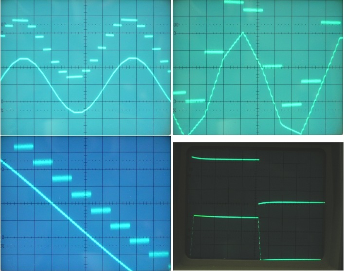

One can set up theories pro and contra about anything in digital sampling . For example get samples of a 22.05 kHz sine wave. If you are unlucky, you might get samples at zero crossings, so the sampled and reproduced signal will become zero. Shift the analog signal by 90 degrees with reference to the sampling clock, and you'll get full amplitude samples. Play back this digital stream on a NOS DAC and you'll get square wave. Use a brickwall filter @ say 25kHz and you'll get perfect sine wave. You get exactly the same results when the original analog signal were 22.05 kHz square instead of sine (although in this case you can't get samples at zero crossings since such do not exist).
I just wanted to illustrate with the above reasoning, that theories and single-signal measurements could be misleading. It is listening to real music that will tell more about the truth. Unfortunately the measurement instrument in this case is the human ear, which is uncapable of giving numerical results, and is influenced by many psychoacoustic factors.
If you want to get objective measurement results, you have to use a test signal close to real music program material. Such test signal IMHO is pink noise, combined with an FFT analyzer.
The frequency response must not be corrected because it might be flawed by sampling anyway ?
If that is your logic, then you could use opamps everywhere because opamps might have been used on the recording side.
Also why care about the quality of the speakers, you don't know how good the microphone was.
And hey - how jittery was the sampling clock ? So a crystal with a logic gate inside your cdp should perhaps do it for you.
Recordings are of the quality: "as is"
Our task is to convert the "as is" data into analog signals as accurate as possible.
That includes both a flat frequency response and a waveform that does not look like a staircase.

NOS vs OS
Unfiltered NOS offers highest accuracy in the time domain and poorest in the frequency domain.
Filtered NOS offers reasonable accuracy in both time and frequency domain.
OS offers highest accuracy in the frequency domain and poorest in the time domain.
Linear interpolation (multiple DAC chips in parallel fed by delayed I2S signals) works excellent at lower frequencies, but distorts higher frequencies causing early trebles roll-off among other things. It can work very well in combination with a digital brickwall filter like used by Cambridge Audio in their 4 x TDA1541A CD player.
The question would be what's most important for realistic sound reproduction, highest precision in the time domain or highest precision in the frequency domain. Based on many years of experimenting and listening to equipment designed by other developers it seems that accuracy in the time domain is much more important for achieving most realistic sound reproduction than we realize.
This is the reason why I choose unfiltered NOS. Compromise I have to make is reduced accuracy in the frequency domain as Bernhard pointed out.
The problem is, we can't have both, using 44.1 / 16 format, it's either one, the other or a combination of both. It looks like we have to make our own choices based on our personal preferences as there is no perfect way to go.
We also have to realize that sound quality is determined by audio component matching. Connecting some random equipment together is very likely to cause mismatches and resulting sound quality degradation. It is also very important to understand specific audio component properties in order to achieve optimal matching.
Example, unfiltered NOS won't work optimally with class-D or comparable switch-mode power amps as frequency spectra of both DAC and amplifier will inter-modulate.
