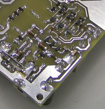

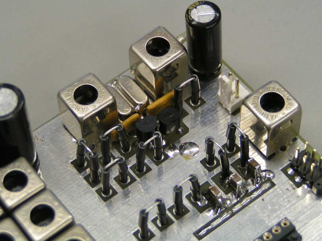

I attached some pictures of this balanced twin-crystal masterclock.

I attempted to solve this with the latest balanced twin-crystal masterclock. This masterclock has two outputs, so I connected the bit reclocker (3pF load) to one output and the SD-transport to the other (no clock buffers required).

The oscillator consists of two 11.2896 High-Q crystals, two matched low noise audio FETs, two 150uH hybrid chokes, and two 1 M Ohm resistors from gate to GND. Output signal is rectified using RF Schottky diode and 330R load resistor to GND.

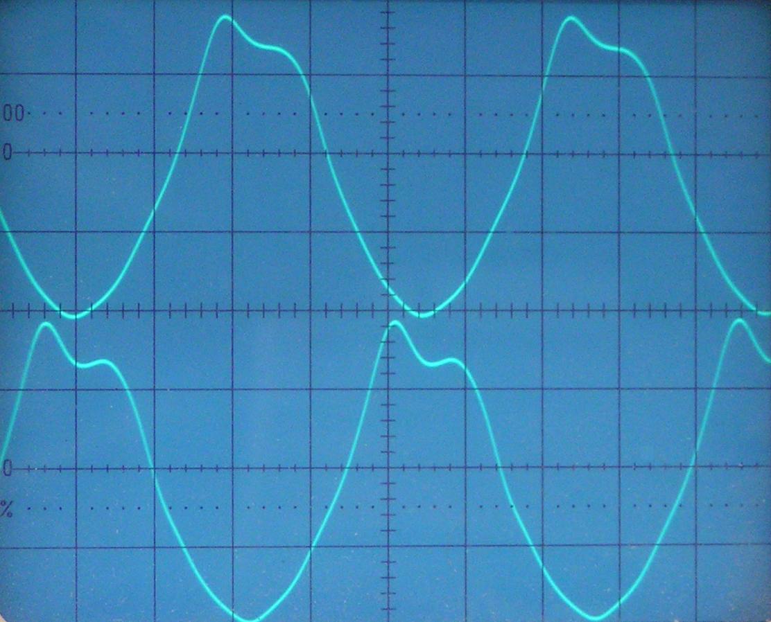

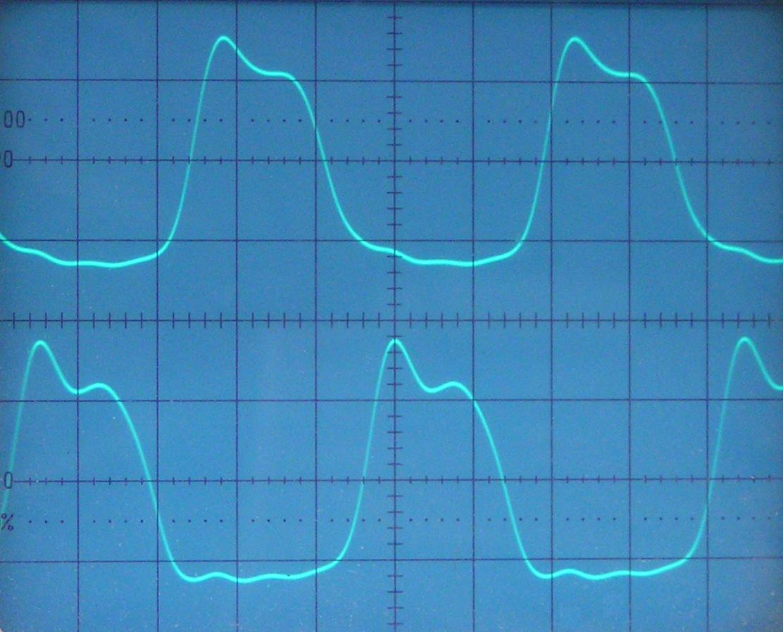

I attached oscillogram of signal at JFET source (1V/div, 5ns/div). The signal swings around GND (goes positive and negative) so rectifier is required to match connected CMOS load properties.
Second oscillogram shows both phase-shifted rectified output signals. Differences in waveform are caused by using two different probes (one of my Tektronix probes broke). Both probes were correctly calibrated using the Hameg scope built-in calibrator.
Positive transient rise time equals approx. 5ns. Synchronous reclockers and SD-transport trigger on this positive transient. Oscillogram shows output signals with 3pF clock loads and 15pF scope probe connected. So the scope probe introduces approx. 5 times higher load than the actual clock loads. This shows one of the limitations of measurements, and why circuits can perform different with or without probe attached. While measuring I also introduce a ground loop as both scope and oscillator are mains-powered.
Third oscillogram shows the balanced output signals before the rectifiers. The rectifiers basically "chop-off" the part of the clock signal that goes negative.

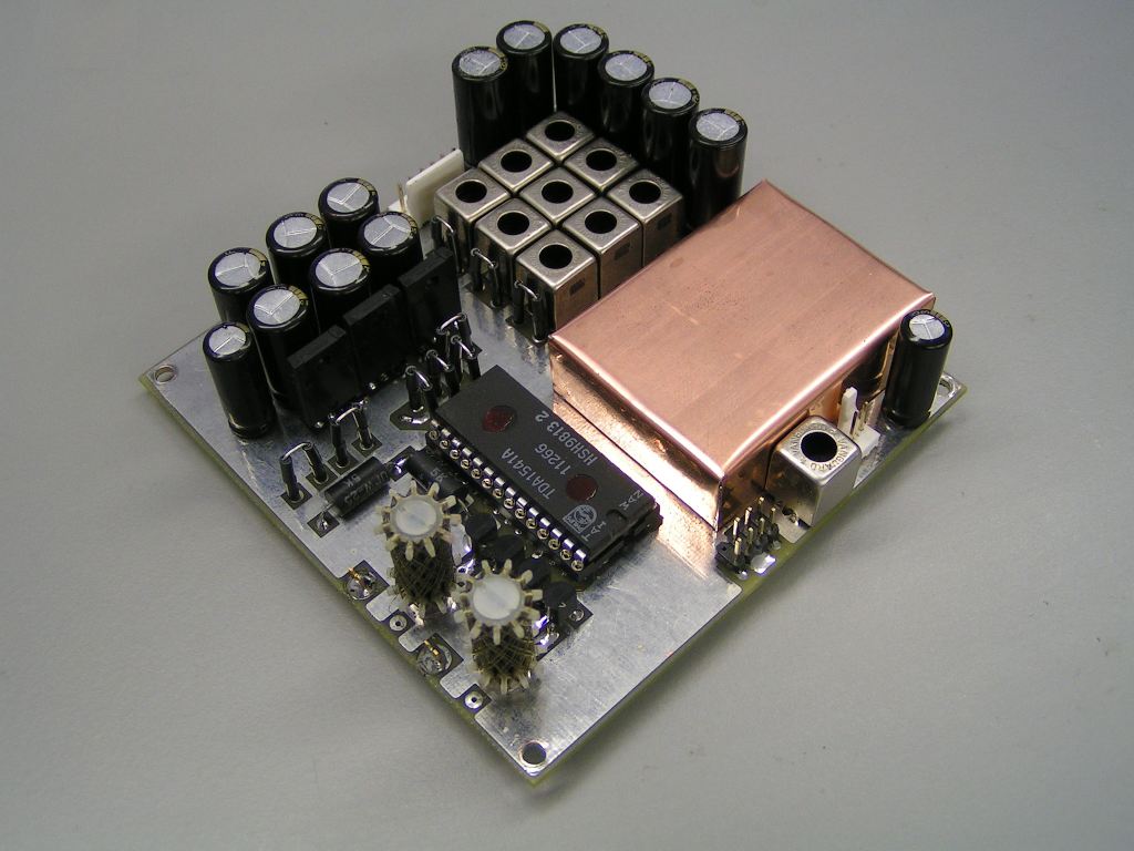

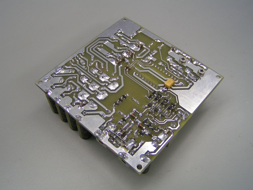

I have been testing the new TDA1541A-MK4 DAC module for some weeks now. The sound quality of this DAC differs significantly from the previous designs with the 4-crystal clock. First thing one notices is the relaxed sound, all detail and speed are still there, but the relation to the music is much more natural. I am testing the DAC on mains power at the moment.
First picture shows the component side, un-interrupted ground plane is used. I use two JFETs in parallel (lower noise) for each channel. I/V conversion is passive (500R Mobius / Honeycomb resistors). Bias resistors are 5K wire wound from Rhopoint / Tyco. I removed the active buffer and use +5V as signal reference. I tap the output signal directly from the I/V resistor, excluding the +5V power supply from the direct signal path. This results in fewest components in the signal path (one I/V resistor and one hybrid coupling cap). The TDA1541A (1998) is cryo-treated.
All chokes are screened now in order to minimize the effects of EMI. Heart of the circuit is a twin-crystal balanced masterclock, based on the 4-crystal masterclock concept. By connecting only a single, low capacitance clock load to each of the outputs of the balanced masterclock, clock buffers (and extra propagation delay / jitter) could be avoided.
Some ferrite beads are changed to different types now (not shown on this photograph) in order to further improve performance. Masterclock and bit reclocker are now powered through a 12th order low pass filter.
Second picture shows solder side. Here we can see decoupling caps, 3 synchronous reclockers (BCK, WS, and DATA), diode resistor I2S attenuators, and diodes for reducing power supply voltage to approx. 2.5V for the synchronous reclockers. DEM circuit consists of balanced DC-coupled circuit with BAT17, 12K and 2K2. It's driven directly from the bit reclocker (1.4112 MHz DEM clock). I2S and clock Wiring is kept as short as possible.
Third picture shows the MK4 with an experimental copper screen around masterclock and synchronous reclockers. I plan to replace this screen with a tinned metal screen.
