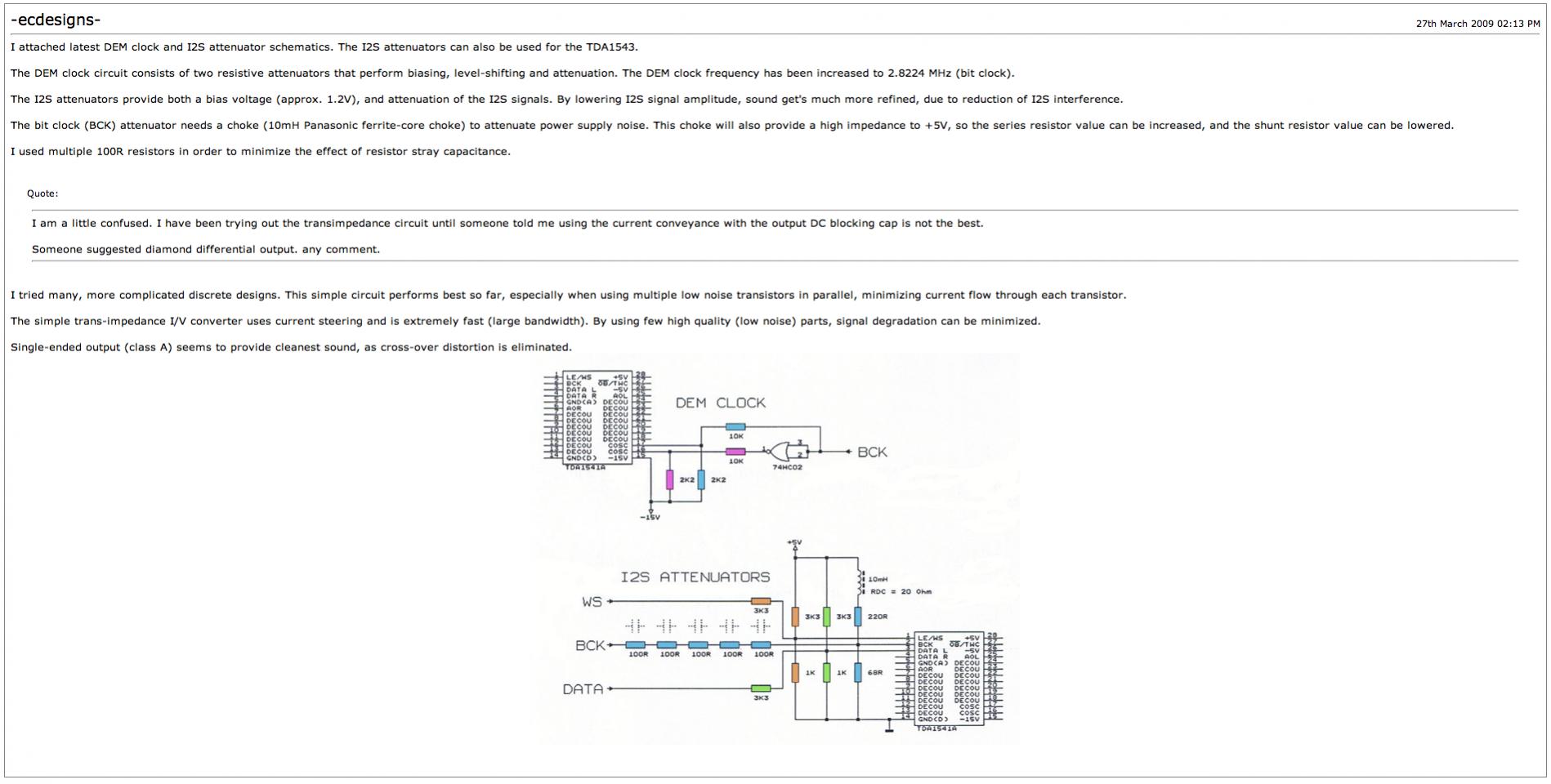

Hi Bigun,I attached a diagram of the stepped attenuator concept (repost).
Hi, thanks very much - I was away the last week on business so just saw your reply to my question.
you explained it perfectly. I like it and it's got me thinking about using it or something similar in my own projects.
Did you consider adding capacitors across each of the diodes to reduce h.f. noise further ?

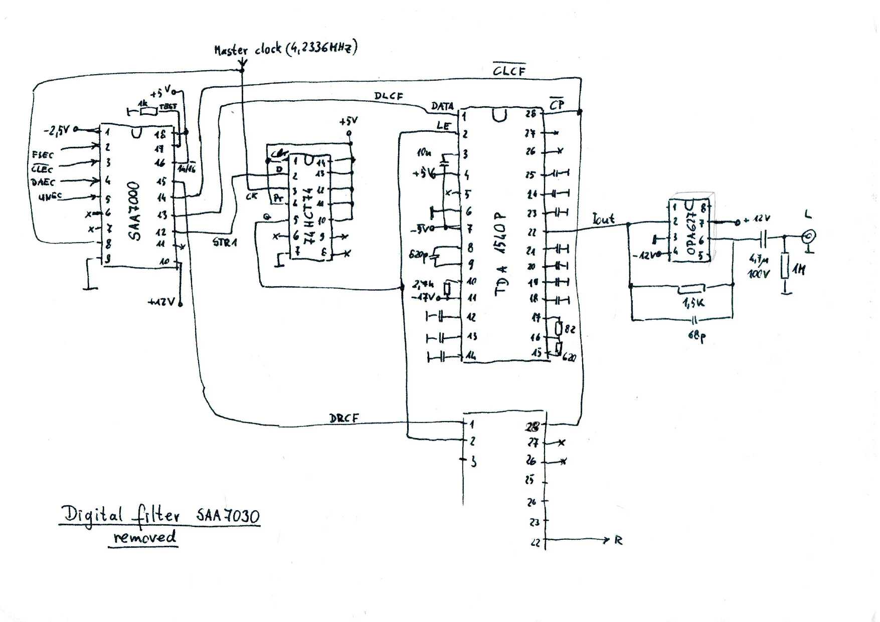

I'd like to try the syncronous reclocking and DEM clock as shown in post #3465 to my main cd player which uses the old TDA1540D DAC. It's a Revox B225 with TDA7030 (oversampling) IC removed and with a low jitter masterclock fitted. Original oscillator runs at 4.2336Mhz, so I had to use a 8.4672Mhz Tent low jitter followed by a 74hc74 to divide it by two. This clock and and all the 3 tensions feeding the DACs are separately and accurately implemented.
Can someone confirm this operation is possible?
I mainly have 3 doubts:
a) BCK frequency. I believe I should feed it at 1/4 of the master clock = 1.0584Mhz. If I remember correctly in the past I fed 1/4 masterclock (2.88Mhz) directly from the divider on a TDA1541, avoiding direct connection to the decoder IC (oversampling removed). This worked well. But I'm not sure if it can be done with the TDA1540 too.
b) DEM. This is something completely new to me. On the TDA1540 a 820pF capacitor is always used and datasheet reports a 160KHz typical frequency with it a minimum of 100KHz and a max. of 200KHz. I don't know if feeding the BCK through the 74AUC1G74 will generate a suitable signal.
c) as far as I can understand the master clock is fed to the BCK's 74AUC1G74 in order to syncronously reclock it together with WS and DATA lines. Is this right?
Thank you.
Hi fvale,
TDA1540 is a 14 bit mono DAC with external DEM capacitor (pin 8 and 9). The DACs run in 4x oversampling (44,100 * 24 * 4 = 4.2336 MHz bit clock). With NOS the bit clock needs to be divided by 4 resulting in 1.0584 MHz.
The DEM frequency limits (100 ... 200KHz) relate to 820pF external capacitor. It's not the absolute minimum or maximum usable DEM clock range.
I haven't tested the balanced DC-coupled DEM synchronizer on the TDA1540, it might need some adapting (resistor values). It is possible that the TDA1540 like the TDA1541A accepts much higher DEM clock rates. You can start with 176.4 KHz (bit clock divided by 6). Based on max. bit clock frequency (12 MHz) chip circuits should be fast enough to support 1.0584 MHz.
Yes, the 74AUC1G74 synchronously reclocks the 1.0584 MHz bit clock, and both flip-flop outputs (Q and /Q) are used for both, DEM synchronizer and TDA1540 bit clocks. LE and DATA signals of both TDA1540 chips also need to be synchronously reclocked for lowest jitter.

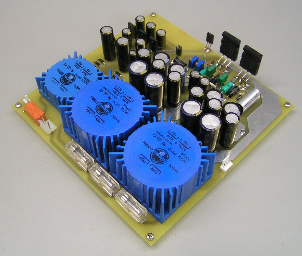

I built a MOSFET Circlotron power amp to replace the MOSFET bridge power amp, using a breadboard setup for testing. This Circlotron amp uses 2 closely matched power MOSFETs for the differential input driver stage and two more for the Circlotron output stage. The design is fully balanced, this means that power supply noise and hum is effectively attenuated, resulting in no audible noise nor hum, thus maximum clarity. There are only 4 MOSFETs in the power amp signal path, offering very high resolution. The power amp was specifically designed to offer highest reliability and low power consumption. At average listening levels, one monoblock only consumes approx. 14 watts from the mains.
At this resolution, all parts become highly critical, meaning their effect on sound quality becomes clearly audible. I had to use non-inductive wire wound resistors for lowest noise. The conventional bridge rectifier also caused too much switching noise (even with Schottky diodes), so I had to use 3-stage stepped rectifiers. Finally the Circlotron power supply smoothing caps put their "signature" on the sound, introducing the next problem. This problem was fixed with a similar method as used with the hybrid coupling caps.
Yesterday I finally completed MOSFET Circlotron power amp PCB lay out and prototype, attached photograph shows the result. It's a single PCB power amplifier, PCB measures 19 x 19cm. The module offers 25 watts rms in 8 Ohms and has a total gain of 30x. The largest part of the PCB space is occupied by the input / driver stage stabilized power supply and both Circlotron output stage power supplies. Both Circlotron output stage power supplies have hybrid smoothing caps that greatly reduce the audible effect of particular electrolytic capacitor types. This results in attenuation of typical capacitor resonance peaks and offer very clean sound. There are multiturn trimmers for DC-offset (this power amp is fully DC-coupled), and bias current. The small transistor to the left of the power MOSFETs acts as a temperature sensor for thermal stabilization. The amplifier was designed such way that loss of power in one or more power supply sections doesn't lead to damaging amplifier nor connected speaker. The stabilized driver stage power supply and temperature sensor provide high bias current stability.

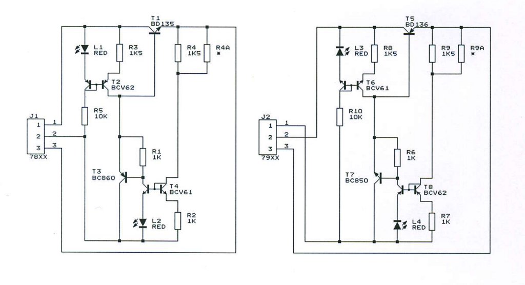

hi ernesternest,
I'd like to know if you are going to sell these regulators (or pcbs) and/or publish the circuit.
I attached discrete regulator schematics. The circuit on the left is a 78XX replacement (positive output voltage). The one on the right a 79XX replacement (negative output voltage).
Given values are for +5V and -5V output voltage. Output voltage can be changed by changing value of R4 / R9 or voltage of reference L2 / L4.
R3 / R9 set max. output current (lower value gives higher output current). Indicated values provide approx. 250mA max. output current (regulators are short-circuit protected).
The regulators require decoupling caps on both input and output pins, similar as with 78XX and 79XX regulators.

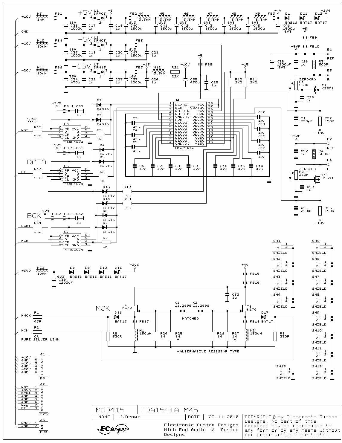

I'm now moving from MK4 I/V to MK5 replacing JFets by Fets (BS170 – couldn't find the IRLU120) and adding items, that came along.
How should one set the DC offset by using the added trimmer? Where to measure the offset?
In your most recent I/V scheme beside the usual signal connection via C3 you connect +5V DAC to +15V CIR. Is this mandatory for getting it to work with any amp or just important in combination with the circlotron? Implementation would mean separated ground between DAC and AMP in any case. Is this the reason and advantage?
Regarding the LEDs in your voltage regulators, you specify them to be red. So they are red SMD LEDs. Wonder, if there were further limitations.
Thanks and regards Ernst

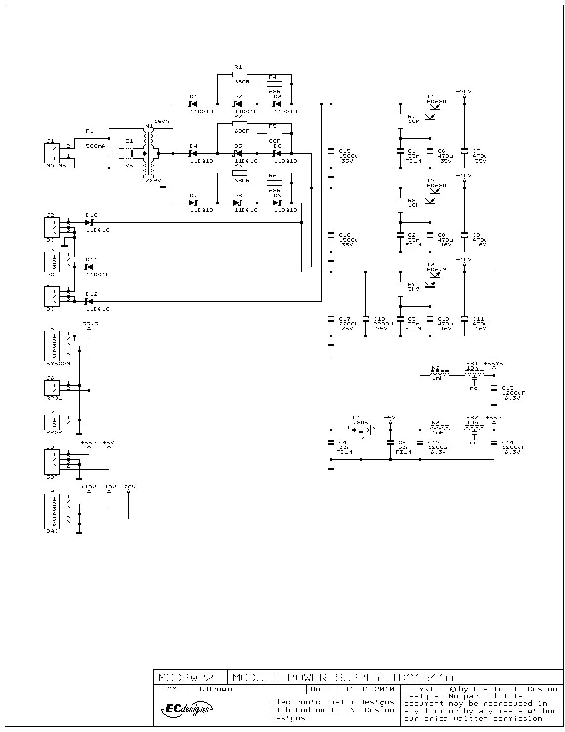

Project full schematics
Hi ernesternest,
First of all I added latest project schematics as reference:
DAC power supply, TDA1541A-MK5, and Circlotron power amp.
Missing parts are the 10K wire wound volume pot and the 3.3uF V-cap TFTF or hybrid coupling cap.
MK5 schematic shows the MOSFET output circuit in detail. Both C1 and C2 are added to attenuate higher harmonics and residual output glitch, this is necessary to prevent bandwidth problems with attached circuits.
Bias resistors R22 and R23 are connected to an extra RLC filter (R21, N12, and C35). This filter attenuates -15V rail noise. The bias resistors are required to prevent MOSFETs T1 and T2 from switching "off" by ensuring minimum bias current of approx. 70uA.
I suggest to use power MOSFETs like 2SK2391 or 2SK216 for example (there are many more suitable MOSFETs, I even got 2Sk1530 working without problems).
The precision multi turn trimmers P1 and P2 are adjusted for 0V DC between TDA1541A L (pin 25) and GND, and TDA1541A R (pin6) output and GND.
The DAC output voltage appears across passive I/V resistors R3 and R4. In order to tap this ac signal without adding +5V power supply impedance in series with this ac signal, +5V is used as reference instead of GND. tests showed clearly that using +5V as reference performs better.
The fully DC-coupled Circlotron uses combined differential input / driver stage. In order to achieve maximum swing, the gates are connected to +15V and the sources to +20V using 50R trimmer ans approx. 220R resistor. If the gates were tied to GND, I would either need an extra differential (MOSFET) pair, or I would end up with too low output swing.
Viewed from DAC / Circlotron absolute ground references, DAC reference is at +5V and Circlotron input reference is at +15V. When both units are connected together (coupling cap blocks DC) there would be (+15) - (+5) = 10V voltage difference between the GND of both devices. +5V of the DAC is connected to +15V of the Circlotron, but since there is no return path (coupling cap) no DC current can flow between the devices.
Yes they are red (or orange) 1206 size SMD LEDs from Kingbright, they are not critical.
