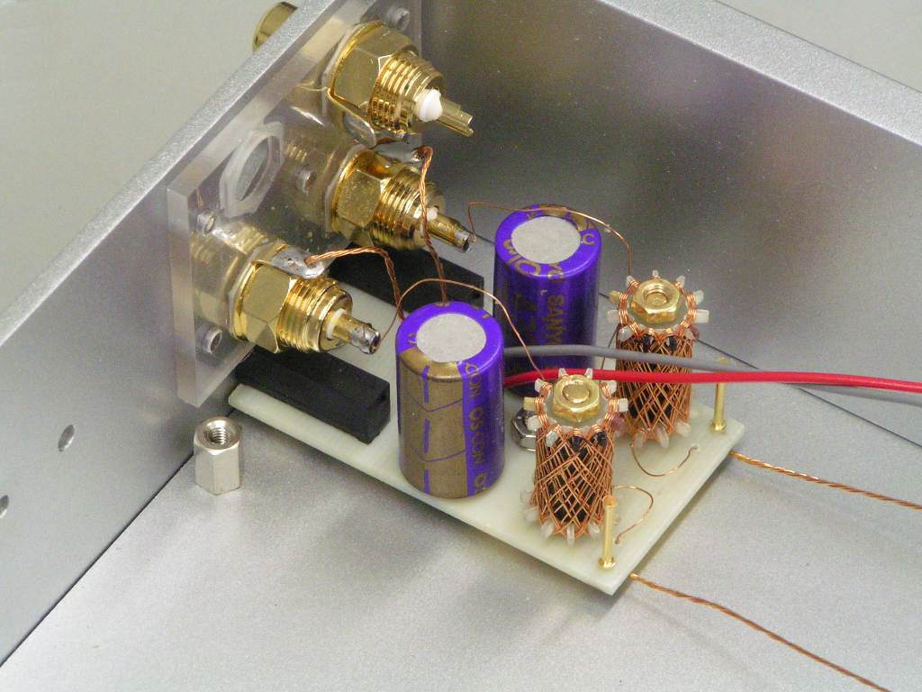

There is approx. 4V DC on each I/V resistor. So I simply used a 1K potentiometer and suitable decoupling cap to create an adjustable reference voltage. There is a separate reference voltage for L and R channel. This reference voltage now serves as "GND" reference for connected equipment.
By trimming each voltage so it exactly matches DC voltage on the I/V resistor, the DC voltage between I/V resistor and reference becomes zero. In other words, the DC component is removed without using a coupling cap.
The circuit is kept very simple, 1K multiturn trimmer. One side goes to GND, the other to +5V. Suitable decoupling cap is connected between wiper (minus) and +5V (plus). The adjustable reference voltage is now on the wiper.
I tried many semiconductor-based references like buffered bandgap references, diode references, OP-amp based DC servos and so on. As soon as a single semiconductor was used, performance immediately degraded. This was very audible with the double crown chip. I am currently using 1K 15ppm bulk metal foil trimmers and a 470uF/16V Sanyo Oscon decoupling caps.
I added a picture of this DC reference module. The two Mobius Honeycomb loops are in the signal path and are used to further purify the signal. This is done by running it through a 2 meter long thin solid-core OFC copper wire. The Honeycomb Mobius structure ensures the piece of wire remains non-inductive and compact. The idea is to improve flow properties of electrical charge.

Hi John,
I once considered such a solution for eliminating the output coupling cap. There are two issues, one minor and one not so minor, that I found.
First, a 'rail-splitting' resistive divider network will substantively increase the circuit output impedance. That's probably a minor concern in a low-level output application. The not so minor concern is that separate left and right offset zero'ing trimmers will be shorted together at the common left and right channel ground of any following amp or preamp input circuit - unless that input is floating or transformer-coupled. This common signal ground connection would equalize the voltage back at the two trimmer wipers inside the DAC, re-creating a D.C. offset there. One can't utilize a common resistive divider to create a single ground reference because the additional impedance on the ground return would be modulated by each channel's signal return current, effectively producing a particularly severe ground-loop.
How did you resolve such issues in your design?
Hi Ken Newton,
The trimmer value equals 1K, when adjusted for 4V DC there will be approx. 200 Ohms between +5V (where the I/V resistor connects) and reference voltage. For ac signals the remaining 800 Ohms will be in parallel (impedance between GND and +5V is almost zero). So added impedance will be 160 Ohms, this increases total output impedance to only 660 Ohms.
I could also use trimmers with lower resistance, 250 Ohm for example. Then the output impedance would only increase from 500 to 540 Ohms.
But since I use 470uF decoupling caps in parallel with this 160 Ohms, increase in output impedance is negligible.
Since both are decoupled with 470uF, crosstalk between the channels will be remain low. There might be a small DC offset increase that is acceptable in most cases. The DC offset increase depends on channel matching.
I made sure the channels match very closely.
