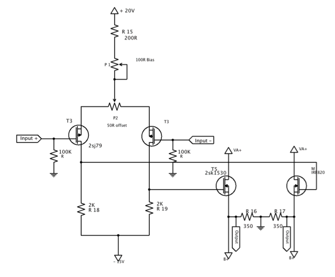

Thanks for your reply. Highly appreciate that.
Just to make sure that I understand you correctly. For balance input circlotron, the schematic should look like this. Is it correct?

Hi WT,
This schematic is not fully correct, the 100K resistors should connect to +15V that serves as input signal reference, just like in the schematic I posted. This is required in order to maximize output signal amplitude of the combined differential input / driver stage.
In conventional designs the (differential) input stage is referenced to GND, but has limited output signal amplitude. The (differential) driver stage then amplifies this signal.
My first Circlotron prototype had a differential input stage that did have GND as reference, this input stage was connected to a driver stage that would provide required output signal amplitude to drive the power MOSFETs. Problem was increased distortion and loss of resolution caused by the two extra MOSFETs.
What I did was removing the differential input stage, and using the existing differential driver stage to serve as input stage as well. Since I needed full DC-coupling there was little other option than adding an extra +15V power supply for input / driver stage reference.
The Circlotron power amp is powered through a number of transformers, so the circuit basically "floats" as it isn't connected to any other circuits. Then one can use +15V as reference, provided one doesn't connect GND of the audio source with GND of Circlotron power amp. So the GND used in the Circlotron circuit is only used locally, and serves as reference for the power MOSFETs.
This schematic is not fully correct, the 100K resistors should connect to +15V that serves as input signal reference, just like in the schematic I posted. This is required in order to maximize output signal amplitude of the combined differential input / driver stage./QUOTE]
Got this

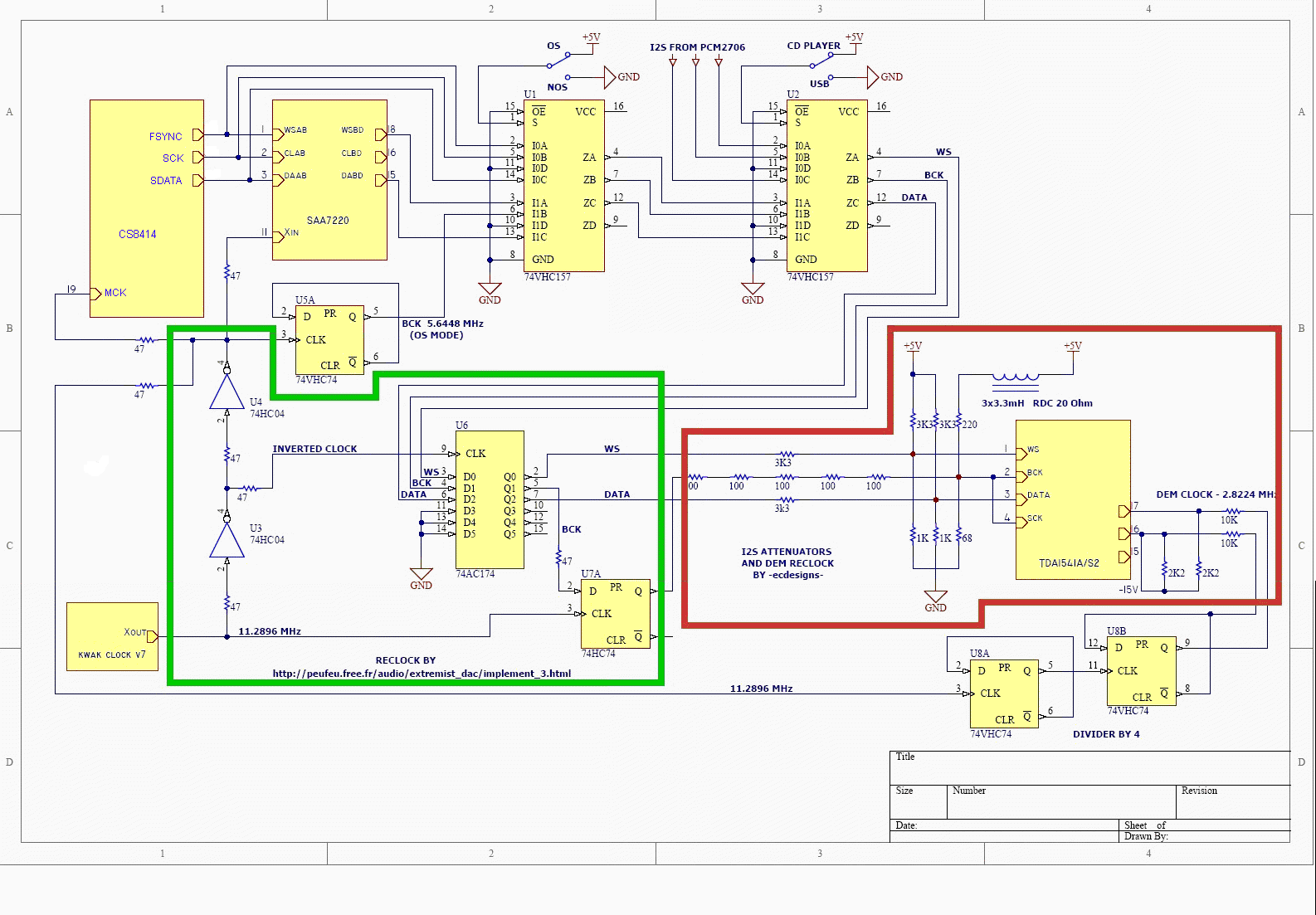

Hi
Does this TDA1541 reclock and dem clock circuit would work good ?
Any suggestions ?
The I2S attenuators aren't optimal, better use new I2S attenuator circuits from the TDA1541A-MK6. failing to use suitable I2S attenuators will lead to higher on-chip ground-bounce and resulting higher on-chip jitter levels.
Here are calculated max! jitter levels for 44.1/16 NOS with indicated resolution:
44.1/16 NOS, 0.1 LSB (15.5 bit resolution), 1 / (44,100 * 1) / (2^16 / (1 / 0.5)) = 173ps.
44.1/16 NOS, 0.1 LSB (15.9 bit resolution), 1 / (44,100 * 1) / (2^16 / (1 / 0.1)) = 34.6ps.
44.1/16 NOS, 0.01 LSB (15.99 bit resolution),1 / (44,100 * 1) / (2^16 / (1 / 0.01)) = 3.46ps.
Jitter specs get even more demanding as oversampling is used:
44.1/16, 8 * oversampling, 0.5 LSB error (15.5 bit resolution), 1 / (44,100 * 8) / (2^16 / (1 / 0.5)) = 21.625ps.
44.1/16, 8 * oversampling, 0.1 LSB error (15.9 bit resolution), 1 / (44,100 * 8) / (2^16 / (1 / 0.1)) = 4.32ps.
44.1/16, 8 * oversampling, 0.01 LSB error (15.99 bit resolution), 1 / (44,100 * 8) / (2^16 / (1 / 0.01)) = 432 femto seconds.
Failing to meet calculated jitter specs will lead to loss of resolution due to fluctuations in sample energy at the speaker.
One single 74HC04 inverter already adds approx. 35ps, the connected 74HC174 adds another 85ps. Comparators used in the KWAK clock will add 35ns (AD8561), or 45ns (MAX913). Oscillator jitter needs to be added too, this equals approx. 10ps with designs similar to this one.
So cumulated jitter of the clock generation logic equals 10ps (oscillator) + 35ps (AD8561) + 35ps (HC04 inverter) + 85ps (74HC174) = 165ps for BCK timing.
Assuming perfect DAC chip with zero jitter contribution and zero bit errors, and zero jitter clock distribution, it would just be possible to achieve 15.5 bit resolution. Adding practical DAC chip and clock distribution limitations will result in significantly lower resolution.
The timing strategy used in the TDA1541A-MK6 DAC module results in lower jitter levels:
Balanced, high amplitude masterclock with less than 1ps jitter (requires no comparator), SN74AUC1G74 with typical 3.5ps jitter, so total jitter equals approx. 4.5ps for BCK timing.

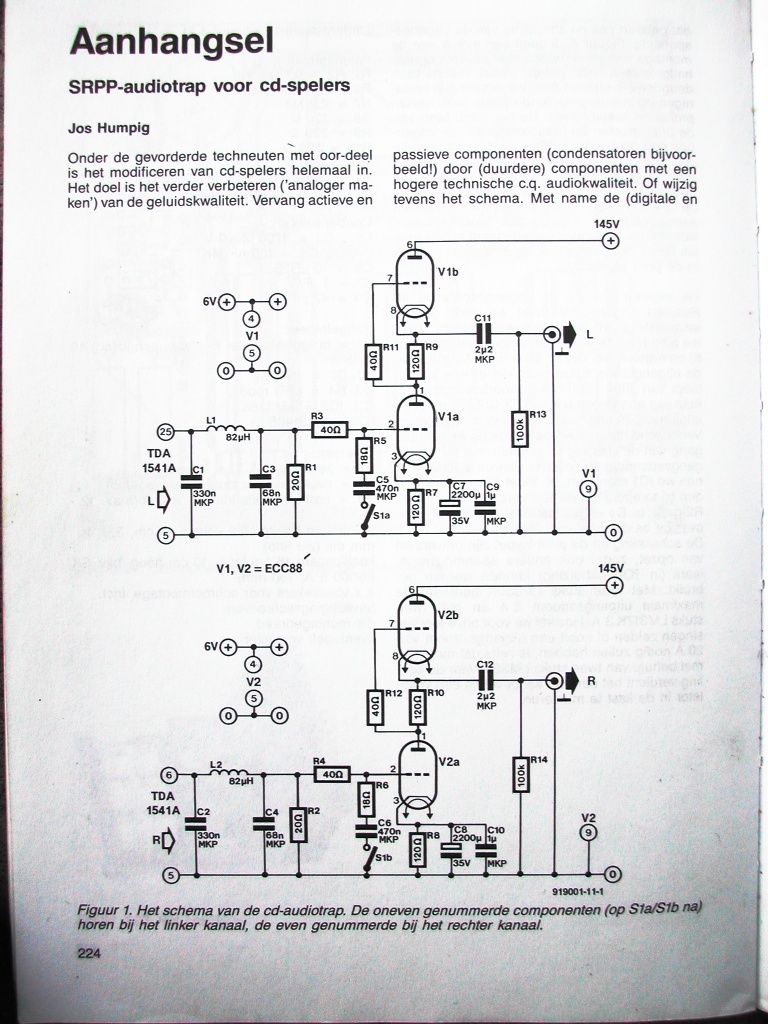

Here it is ..from a dutch book from 1992 "elektuur Buizenversterkers"
(note: Buizenversterkers = tubeamplifiers)
Its a SRPP stage with Ecc88 at the pins 5-6 right channel and 5-25 left channel
The page with Dutch tekst:
Current output needs to be very low ohms 20 Ohms R1 R2
With a Bessel filter C1,L2,C2 and R1 De emphases with S1
Most Cd players don`t need it
Psu is very complex for stability and more longlife current for the tubes
6v filament instead of 6,3 hmmm don`t like that course it hurts the dynamics (try to get it on 6,3V is my opinion) AC filament sounds better then DC (not to be applied into Phonostages )
If you need any explanation on this Dutch .... try me or another dutch reader 😀
Hope i did it right to add a tubestage on digital 🙄
Back in 1992 there where pcb boards and print layouts .... but nowadays?
Hope you enjoy the input 😉

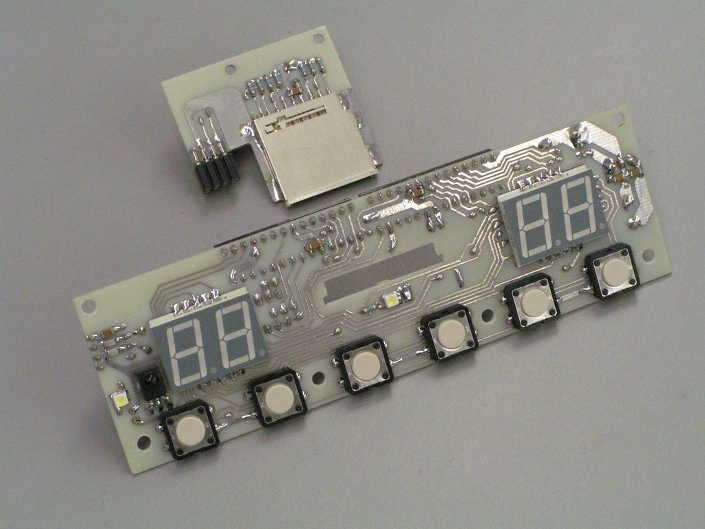

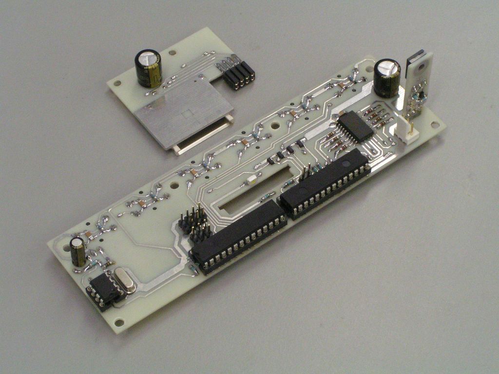

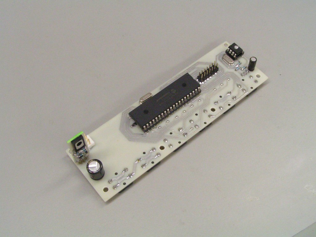

There is a new SD-transport module (MK2) with new improved firmware. Jitter is further reduced by factor 2. There is also a new power supply (MK2) for the SD-player.

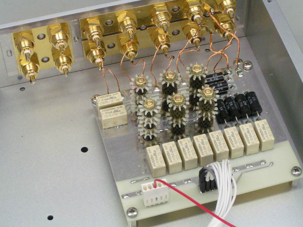

I am about to complete a matching stepped shunt volume control unit based on non-inductive wire wound resistors exclusively.
I attached some pictures of these new projects.

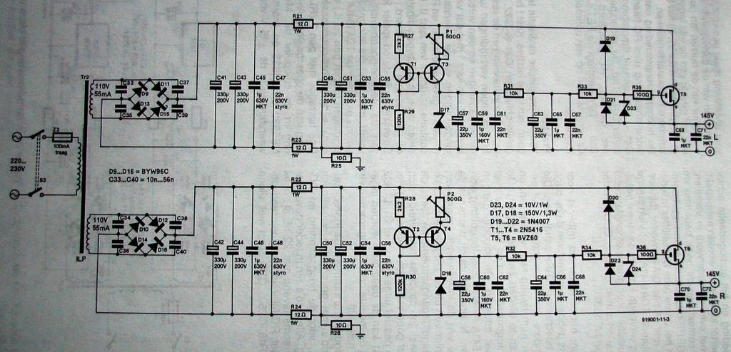

Hi dutchaudio,
I don't like Elektuur designs, the fun usually ends as soon the power is applied.
For tube circuits ask the expert:
John Broskie's Guide to Tube Circuit Analysis & Design
I am afraid not.
TDA1541A is rather picky about circuits connected to it. Exceeding TDA1541A output compliance of +25mV and -25mV with respect to GND will increase distortion. In order to minimize on-chip jitter levels at the D/A stage, ripple voltage on the 5V and -15V power supplies need to be minimized. For this reason it is important to direct all used and unused bit currents back into +5V. This means that a passive I/V resistor must connect to +5V rather than GND.
In order to preserve transparency, resolution and low noise (hum) levels, amplification is not desired at all. It is best to generate output signal directly across a passive I/V resistor, 500 Ohm passive I/V resistor will offer 2Vpp without any active amplification. The 500 Ohm impedance is low enough to skip active buffers that would also add substantial distortion.
Digital audio sources produce pulse sequences rather than analogue signals, therefore it is necessary to remove each and every part from the signal path that can introduce distortion (both amplitude and phase). There is no active circuit, no matter how well designed, that can outperform a short piece of wire.
In short, full DC-coupling throughout the audio signal path. If this is not possible, then place the distorting parts at the end of the signal path (speaker crossover).
The issue with TDA1541A output compliance can be fixed using a grounded-gate power MOSFET buffer between TDA1541A output and passive I/V resistor that connects to +5V. DC-coupled output can be obtained by use of an (adjustable) reference voltage that serves as signal reference.
