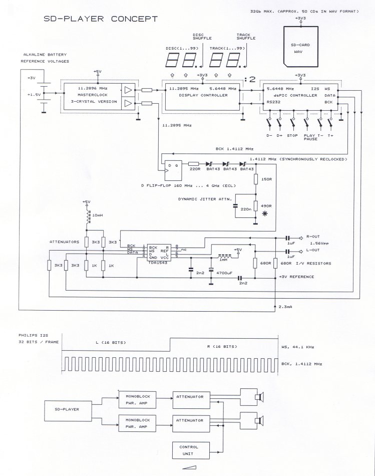

I'm very curious about your further improvement in the I2S jitter reduction circuit and how would it behave in a CD-player integrated DAC...would it be possible to give some more info on this?
I added a concept diagram of the SD-card player, it includes a dynamic jitter reduction circuit for BCK. Photograph of the working prototype was recently posted.
The master clock is a simplified version of the 12-crystal master clock that is going to be used in the TDA1541A-based SD-player. These master clocks use a tuned crystal filter (3rd ... 12th order) This filter is used for both the oscillation and for filtering the output signal. This way very clean sine waves with low distortion can be obtained.
Since mains-powered reference voltages would be way too noisy, I used a 1.5V alkaline reference voltage instead. The power supply (5V) is less critical. The master clock now performs like if it was running on a clean battery power supply, while barely consuming any power from the battery reference voltage (150nA max.).
The master clock is built around a discrete HF buffer with high input impedance. This buffer is powered by a constant current source. It also has dual discrete HF output buffers that were specifically designed to avoid any frequency shift due to capacitive loading, thus isolating the master clock from connected loads. This helps to maintain extreme low jitter levels with varying loads
The digital audio source is a SD-card player. The SD(HC) memory card is read by a dsPIC controller, and the data is converted to I2S by an on-chip DCI module. There is a separate display controller that also divides the master clock by 2 (required for this application).
The dsPIC BCK output signal (1.4112 MHz) is fed to a fast single D flip-flop (160MHz ... 4GHz), synchronously reclocking BCK with the master clock, using a dedicated clean buffered output. This provided best audible results (jitter is already too low to measure with my test equipment), it was much better than using a synchronous divider (divide-by-8).
The already extremely low jitter is further attenuated in the dynamic jitter attenuation circuit. This circuit mainly tackles the lower jitter frequency spectrum (this is a problematic range for crystal oscillators).
The Schottky diodes perform clock signal interruption below TDA1543 digital input bias voltage, this greatly reduces interference. The attenuated clock signal appears across the 150 Ohm resistor. The clock signal also drives an integrator, composed of 220nF and 490 Ohm (approx. values). The integrator derives an average bias voltage that fluctuates with the master clock duty cycle (jitter) and thus manipulates the bias voltage. This determines the exact moment the TDA1543 output latch triggers. The required corrections are extremely small.
This means that BCK still has certain jitter amplitude, but the DAC sample timing jitter would have dropped. This configuration integrates both source and DAC, this enables very high performance and completely eliminates interface / interlink issues.
Unlike many transport / DAC combinations (external DACs), this player only has one clock source (single time domain) and one related clock jitter spectrum. This turned out to be crucial for optimal performance.
Both DATA and WS signals have a resistive I2S attenuator, a choke is added to attenuate power supply noise. The attenuators are required to achieve a clean analog output signal, without them, sound quality degrades significantly (sound smearing).
Same applies for Vref (pin7) if this pin is connected to anything, sound quality degrades dramatically. This is caused by ground or power supply noise polluting both bias current source and DAC output current, then it's over. So never ever connect this pin!
Same applies for paralleling multiple TDA1543, this will increase interference levels and jitter amplitude. If multiple TDA1543 chips must be used in a design (balanced DAC), they must be completely separated and have separate attenuated I2S signals. Even then it's very difficult to maintain low jitter and I2S interference levels.
I use 680 Ohm passive I/V resistors, this gives enough signal to directly drive my power amps (100K input impedance). Since I only use one TDA1543, I need a reference voltage for these I/V resistors. This is also required to use the actual DAC output current (that flows to GND).
Mains power supplies are too polluted for this, and a "floating" supply is required. So I simply used 2 penlight alkaline batteries (I needed one for the master clock anyway). Current consumption (TDA1543 powered-up) equals 2 x 1.15mA = 2.3mA. When the player is shut-down, the TDA1543 no longer draws any bias current, so the battery can simply stay connected. The master clock only consumes a few hundred nano amperes when shut down, and even less when operating. So the batteries should last a long time.
Despite grossly exceeding datasheet 25mV output compliance, distortion stays low (checked with a Marconi distortion meter). I also tried other I/V converters, including the trans-impedance converter, and a fast Op-amp. The passive I/V converter clearly performed best with this chip, so that's why I used it.
The SD-card digital audio source generates Philips I2S with 32 bits / frame, this provides a continuous data stream without periodic interruptions like with 64 bits / frame. This provides two advantages, first the bit clock frequency can be halved (less ground bounce), and second, the DATA flow is more fluid, causing less interference.
At the bottom is the block diagram showing the highly criticized volume control.

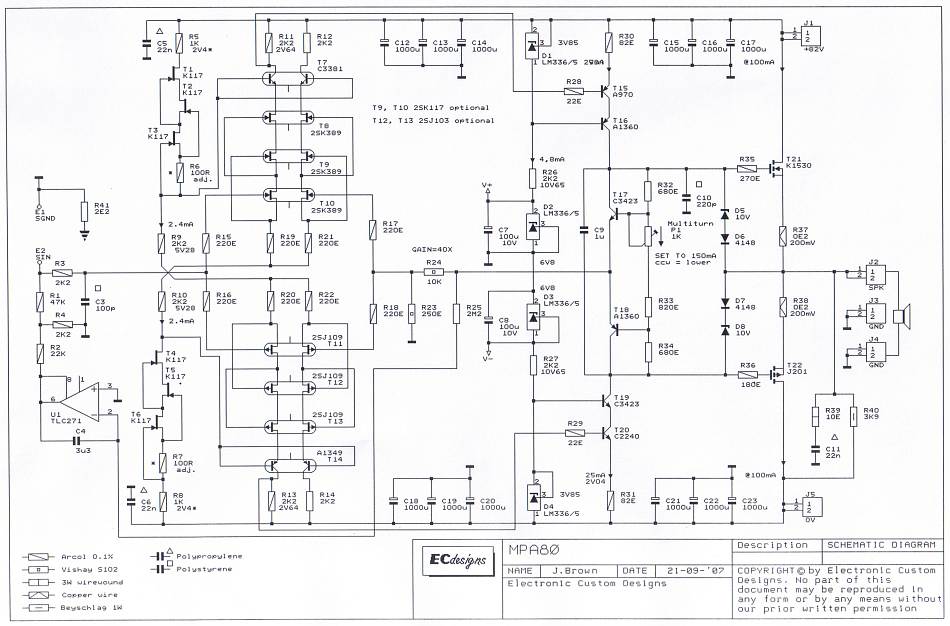

I use home-made, fully complementary cascoded-cascode power amps. These have local feedback (not affected by back-emf from the speakers).
I attached a schematic diagram of this amplifier. It runs on a single power supply and has floating GND. The input is DC-coupled, so the 1uF coupling cap is the only cap in the signal path between DAC and amplifier.
