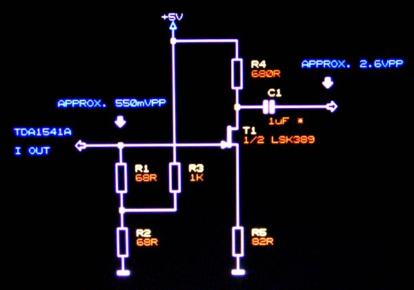

HI ECDesigns,
With regards to the transimpedance circuit, T1 provides virtual ground through the Vref at T1 base.
However, the Idac comes from the sum of Ic and Ib of T1. Ibase of T1 can vary between 0 to 13uA for a Ic of 0 to 4 mA (from the datasheet of 2sk2240) . Therefore Ibase is introducing 'noise' into the circuit depending on the magnitud of Idac.
I wonder if you have any idea how to overcome this.
I was thinking to use JFET given the fact JFET gate current max out at 1uA.

TDA1541A biased passive I/V converter schematic
Hi ccschua,
Try attached schematic, you can use other JFETs, but then resistor values of R4 and R5 may need to be changed.
Hi ccschua,
There is 550mV at the DAC output on your diagram, and the datasheet prescribes a voltage compliance of +/-25mV. Isn't there any mistake?
BTW, how rigid is the voltage compliance value? I mean there is nominal distortion at +/-25mV, slightly more at +/-30mV, gross distortion at +/-50mV, or is there a kind of hard clipping at a given voltage level? I suppose there are some internal junction diodes, and the distortion characteristics follows some diode law. Has anybody measured the distortion vs. output voltage? It is an easy measurement, the variable parameter is the resistance of the I/V resistor. I always believed it should be around 10 ohms or below.

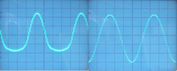

Hi oshifis,
Grossly exceeding output compliance results in asymmetrical clipping (approx. 800mVpp), at lower levels it's merely a bias problem (asymmetric output signal) causing increased distortion as specified in the data sheet. This is caused by TDA1541A output circuit (diode-transistor bit switches).
The bias circuit around R2 and R3 fixes this, and allows for hihger ac output amplitude while maintaining low THD. The actual passive I/V resistor consists of both R1 and R2 in series (136 Ohm), providing approx. 544mVpp. So R2 is part of both, I/V resistor and bias circuit.
The resistive bias circuit adds noise, this ends-up at the I/V resistor, and the signal does look noisy on the oscilloscope. But the same happens in the JFET amplifier stage, but now inverted as the JFET amp inverts. So now it's possible to neutralize both effects, leading to a clean output signal despite power supply noise levels (increased PSRR).
So the 544mV ac signal is no mistake for sure.
I attached some oscillograms, the one on the left shows how the distortion looks like when ac signal amplitude is too high (I/V resistor tied to GND), this is a 450mVpp signal, on the right a 540mVpp signal, also on the DAC output, but now using the additional bias circuit.
The distortion sets-in slowly, starting with distortion (soft clipping) at the lower part of the 1 KHz 0dB test sine wave. When the bias circuit is adapted, and I/V resistor value is significantly increased, the signal clips symmetrical at approx. 800mVpp.
Thanks for the explanation. One thing is not quite clear: is your bias circuit providing the 2 mA DC bias current flowing into the DAC output pin? If this is the case, Philips could have relaxed the +/-25mV restriction on their data sheet, in the special case when an external 2mA bias is applied at the output pin.

i also have made this ultimate DEM reclocking published by EC in one of my TDA1541A cd-players
my first experiment was not very good because having a Kwak Clock 7, I took both the normal and inverted clock signal directly from the AD comparator telling to myself that the inverted signal might work very well without putting an extra load (the hex inverter chip) to the normal clock signal thus not introducing
extra jittery loads. But this turned not to be the best choice because i obtained sound distorsions on the low level signals (the quiet passages and the end of tracks)...after this i experimented by changing some values for the 2,2k resistors going to the -15V but distorsion still there!
After this i decided to add a hex inverter (74HCT04) to the normal clock signal and obtain the inverted signal from this.
I did this setup and distorsion still there (with initial 1k resistors to -15V) puting 1,2k in series with the 1k and obtaining the Magical 2,2k value - Distorsion gone !!
It seems that EC tuned very well this circuit obtaining the optimal values because every small deviation produces distorsions !
After that i decided not to extra load the BCK going to the NOS DAC (masterclock/4) and i sent to the hex inverter chip the masterclock/2 coresponding to a 5,8 mhz signal from the divider chip.
5,8mhz and inverted 5,8mhz going through 10k to the DEM pins seems to me the BEST Solution!
It gives more focus to the sound and crisper highs just like changing a plain TDA1451 TO a S2 double crown version of the same chip.
I'm very happy with this mod together with short I2S path and I2S attenuators so BIG thanks to EC for sharing with us his great findings
