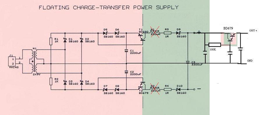

Recently I run into some hum / hissing problem with the simple IV and I only discover this when I tried it on my fren's setup. There is a clicking noise of less than 1second interval.
I wonder if the following will work
for the trans IV output,
floating charge transfer -> capacitance multiplier -> LM3X7 -> Super Shunt -> transimpedance ..

Dear Ccshua,
Both charge transfer circuits are brilliant. The floating one is supposed to be best.
Please remember that C3 will see double the voltage. You may consider attaching your regulator's "ground" to CT's V(-) to benefit from the floating approach.
M
Dear Ccshua,
