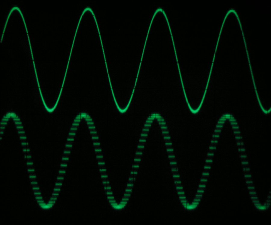

Hi rolls,
Full 144dB dynamic range (24-bits) is not required for practical playback unless you don't mind permanent hearing damage (jet engine at full blast produces approx. 140dB).
So the dynamic range has to be reduced to avoid too loud (peak) signals. Practical dynamic range is more like 50 ... 70dB.
Audio sets produce noise, and the weakest audible signal depends on noise level. Suppose the audio set has zero noise, the weakest audible sound would then be determined by human auditory system and ambient noise levels.
There is also the resolution limitation imposed by sample rate and timing jitter!
I attached an oscillogram of two 1 Khz sine waves, what signal do you think has highest bit depth?
You can have a dynamic range of 93db only and still a resolution power of 24bit, it means that the steps are finer, one step is 1 divide by 2 to the power of 24.
In other words, the binary word is not zero when it "leaves" noise
