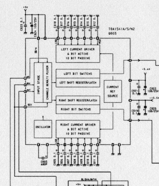

Hi UV101,
Whats your thoughts on Pin 4?
TDA1541 pin4:
DATA left channel input (pin 27 connected to -5V, simultaneous mode).
System Clock input (pin 27 connected to GND or +5V, time MUX mode).
TDA1541A pin4:
DATA right channel input (pin 27 connected to -5V, simultaneous mode).
Not used (pin 27 connected to GND or +5V, time MUX mode).
Unused inputs must be connected either to GND or VCC. When leaving an unused input unconnected, it could pick-up interference. In this case, it's most likely that pin4 will pick-up interference from pin3 (DATA).

Found this on a old thread about S2's. It says they were all produced for Marantz CD7's and the diagram shows pin 4 as sck.
http://www.diyaudio.com/forums/showthread.php?postid=1807175#post1807175
I've also read sevaral articles that stating that the sysclock input was still used in A ver chips
This was a very big improvement for me
Hi UV101,
My Sony CD player has a plain TDA1541, it also has pins 2 and 4 connected. I think this is done for compatibility, so both TDA1541 and TDA1541A work in the same PCB without PCB modification.
I can't imagine Philips would have changed the TDA1541A-S2 chip function for Marantz, only chip grading (selection).
If you connect pin 4 to GND (Time multiplex mode), and you still have sound, it's obvious that this pin has no function in this mode (it's not used to clock the output latches).
However, it's possible that applying clock signals to pin4 (that is capacitively coupled to the TDA1541A internal circuits when not used), could affect on-chip interference levels, and I assume this would also be audible.
So the effect you are experiencing could be a change in interference levels at the DAC analogue outputs.
