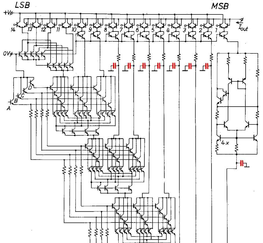

So could it be possible to tune (linearize) the 6 MSBs of a TDA1541A by injecting adjustable constant currents at the decoupling pins? A perspective of converting a plain 1541 into double crown, triple crown..-ecdesigns- said:Current sources may be perfect in a simulation, but in practice there is significant (power supply) pollution present that's extremely difficult to reduce to required nV / nA region. The simple constant current sources, based on a JFET are far from perfect and output current still varies with power supply voltage fluctuations.
You can easily test this by attempting to tune TDA1541A bit errors by feeding an external constant current into the active divider decoupling pins, and these are only the 6 MSBs!
Hi oshifis,
I attached part of the TDA1540 internal schematics (IEEE JOURNAL OF SOLID-STATE CIRCUITS, VOL. SC-14, NO. 3, JUNE 1979). TDA1541A schematics are similar, but this one has 10 passive current dividers and 6 active current dividers.
On the top right there is the current reference source, all binary weighted bit currents are derived (divided) from this reference current source. So if the output current of this current source changes (drift), all bit currents will change accordingly, preserving bit accuracy.
This constant current source also directly provides MSB current (2mA). It's mirrored against -15V, and then enters the first active divider (not shown).
There are 3 active dividers visible, they are driven through shift-register outputs A, B, C, and D. The speed the shift register is clocked, is determined by the DEM clock frequency.
Each active current divider consists of 4 transistors (passive divider) supplying 4 coarse (almost equal) currents to the switching matrix. The switching matrix connects each active divider output to each passive divider output alternatively, using a specific switching pattern. This way the active dividers perform time-averaging, meaning that the active divider outputs derive 4 closely matched output currents from 4 not so closely matched input currents. Two of these outputs are always tied together:
Example:
Input currents, 0.51mA, 0.48mA, 0.46mA, 0.49mA. After time averaging, 4 output currents are derived, each of these output currents equals (0.51 + 0.48 + 0.46 + 0.49) / 4 = 0.485mA. Since 2 outputs are connected, the output currents are 0.485mA, 0.485mA, and 0.97mA.
In other words, despite tolerances in the 4 passive divider input currents, the derived output currents will be closely matched due to time averaging. The currents are dynamically tuned to close tolerances.
There is a catch, if the time intervals between switching (DEM clock) vary, for example 5us, 0.49us, 5.1us, and 0.48uS, the passive divider tolerances aren't fully corrected, and bit errors occur. That's why it's important to keep the DEM clock jitter as low as possible as DEM clock jitter might result in higher bit errors.
Back to the TDA1541A-S2, running on the standard free running jittery DEM clock that prevents close matching of the 4 input currents. The only way to still get closely matched currents at the active divider output is to have equally close matched outputs on the passive dividers. Using above example:
Input currents, 0.485mA, 0.485mA, 0.485mA, 0.485mA. After time averaging (time intervals aren't equal), the output currents are still 0.485, 0.485, 0.485, 0.485.
The MSBs will have biggest impact on bit errors, the slightest errors here, and accuracy degrades quickly.
So the TDA1541A-S2 is only a plain TDA1541A that has slightly closer matching of the passive dividers that feed the switching matrix. So with the given jittery DEM clock, it still manages to provide slightly higher bit accuracy. But much more important, it will have lower ripple current on the active divider outputs too.
On the other hand, when we feed a plain TDA1541A chip with a highly accurate, low-jitter DEM clock that runs in sync with BCK, all DEM clock time intervals will be closely matched. This will result in similar performance as the S2 chip with closer passive divider current matching.
Passive divider tolerances also translate to increased ripple current on the active divider outputs. These outputs are filtered using an internal resistor, and an external decoupling capacitor (marked red).
The bigger the passive divider tolerances, the higher the ripple current amplitude. In order to prevent this, the DEM clock can be increased by approx. factor 10 (from approx. 200KHz to approx. 2.8224 MHz). Now it's easier to filter the active divider outputs and reduce ripple current (noise).
So TDA1541A performance can be significantly increased by ensuring DEM clock jitter is very low (equal time intervals), and DEM clock switching frequency is significantly increased (lower ripple current). Max. DEM clock frequency is limited to approx. 7 MHz,
Other factor that increases output current noise levels are the I2S signals. Even minute voltage fluctuations (ground-bounce) can affect the highly sensitive output signal. And since I/V conversion has to take place sooner or later, noise on the GND reference will degrade accuracy.
This is why it's very important to take whatever measures to minimize I2S induced ground-bounce. On chip, high-speed current steering logic is used (+/- 400mV levels), so here interference is already minimized.
In practice this means reducing I2S signal levels to approx. 400 ...600mVpp levels. The I2S inputs require a bias voltage of approx. 1 ... 1.4V, so this bias voltage has to be provided too. Using the SD-card player, it's possible to lower ground-bounce even further by using 32 bits / frame, resulting in 1.4112 MHz bit clock (ground-bounce decreases with decreased voltage and decreased frequency).
Recently I derived this bias voltage from the TTL level I2S signals, so bias voltage slightly varies with duty cycle (jitter). This affects the exact moment the TDA1541A will trigger, and it can be used to compensate for timing jitter, effectively reducing sample timing jitter. It's also important to interrupt the I2S TTL level signal current flow when it drops below approx. 1V, this is required to prevent full discharge of the I2S input stray capacitance, minimizing current surges. This new I2S jitter reduction circuit has resulted in most significant increase in TDA1543 / TDA1541A sound quality since I started this project.
Example:
