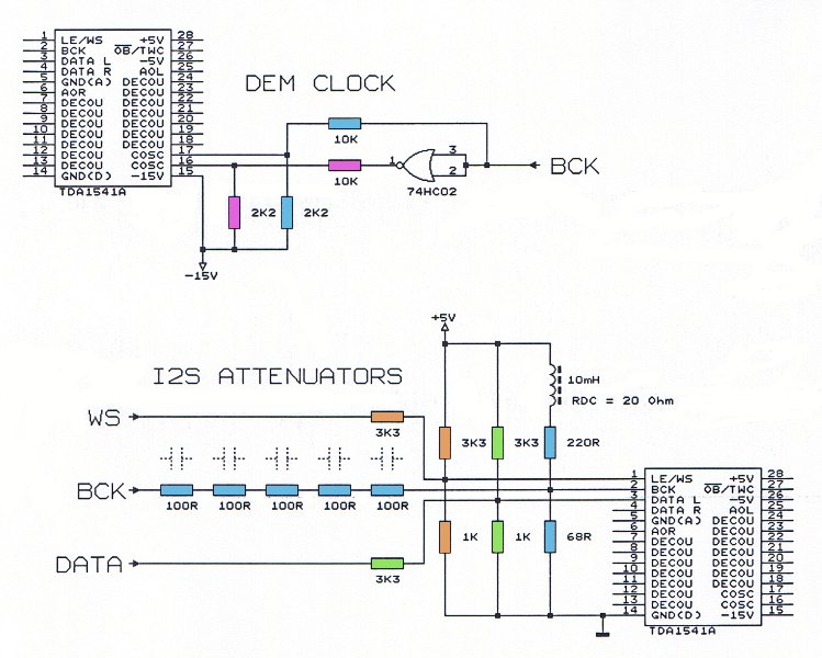

I attached latest DEM clock and I2S attenuator schematics. The I2S attenuators can also be used for the TDA1543.
The DEM clock circuit consists of two resistive attenuators that perform biasing, level-shifting and attenuation. The DEM clock frequency has been increased to 2.8224 MHz (bit clock).
The I2S attenuators provide both a bias voltage (approx. 1.2V), and attenuation of the I2S signals. By lowering I2S signal amplitude, sound get's much more refined, due to reduction of I2S interference.
The bit clock (BCK) attenuator needs a choke (10mH Panasonic ferrite-core choke) to attenuate power supply noise. This choke will also provide a high impedance to +5V, so the series resistor value can be increased, and the shunt resistor value can be lowered.
I used multiple 100R resistors in order to minimize the effect of resistor stray capacitance.
I tried many, more complicated discrete designs. This simple circuit performs best so far, especially when using multiple low noise transistors in parallel, minimizing current flow through each transistor.
The simple trans-impedance I/V converter uses current steering and is extremely fast (large bandwidth). By using few high quality (low noise) parts, signal degradation can be minimized.

great news dear EC !
if you say it's the best DEM reclock circuit tested by you so far i believe you 🙂
so you have used 74HC02 as an inverter for the inverted 2,8 mhz signal? is this the best logic that can be used in this application?
Also i would like to know your opinion on the posibility of using directly the inverted Masterclock from the KWAK CLOCK 7 obtained from pin 7 of the AD8561 comparator so this way an inverter wouldn't be needed any more.
Or is it better to obtain the inverted signal from the non-inverted one used for the BCK ?
My last question - do we need some extra buffer to drive the 2,8 mhz masterclock simultaneously to BCK and to the DEM clock inverter to minimise interference and jitter?

Hi luxury54,
I just used this inverter for testing, doesn't seem to be very critical. It's also possible to use a single inverter, NAND, or NOR gate (Fairchild tiny logic series).
This should work fine, clock load is minimum (10K series resistors).
The DEM clock circuit load is minimal, so extra buffering doesn't seem to be required. But if other circuits require the master clock too (SPDIF receiver / reclocker), an extra clock buffer is required.
I use the un-buffered master clock output to drive the TDA154x (through 500R series resistor that's part of the attenuator)
The un-buffered master clock also drives a clock buffer through 1K series resistor. This clock buffer is used to drive the DEM clock, the microprocessor-based tracker, and the CS8416 SPDIF receiver.

Hi ccschua,
74HCT04 is ok, resistors must be 10K and 2K2, no other values.
For the DEM circuit, how about a 74HCT04. Can this work? I dont have 10k, but 12k. Do I need to increase the 2.2k to 2.7k?
