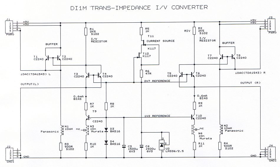

Hi ccschua,
I added the schematics from the converter, used in the D1M.
There are two voltage reference sources that are used for both channels. U2 provides the 2V7 reference voltage, required to get approx. 2.7 - 0.6(Vbe) = 2.1V for the TDA1543 current outputs.
The 2V7 reference voltage also drives a second 1V2 reference source, required for the bias current sources. I am still not sure if sound quality is best, with or without these bias current sources. The voltage references are fed by a cascode current source (T11, T12).
The bias current sources have ferrite beads (from a 10nF Murata filter) in the emitter leads in order to present a relatively high impedance for HF interference signals. This is required to minimize pollution of the DAC output current.
The trans-impedance converter is straight-forward (T3 .. T6). I used transistors in parallel to reduce noise. The I/V resistor quality is VERY important as I/V conversion largely depends on I/V resistor properties. For me personally, only bulk metal film is good enough.
The output buffers are single-ended in order to completely eliminate cross-over distortion and push-pull circuit mismatch. This application also requires current steering (extraction of signal from the I/V resistor), so bipolar transistors had to be used. Again two transistors were placed in parallel to reduce noise. The chokes (N1, and N2) are added to create a high impedance for increasing frequency. This significantly lowers the output power at these frequencies, and will effectively suppress HF interference. The value in the schematic (10mH) can be lowered (depending on connected load).
The required supply voltage is approx. 2V1 plus the max. output signal amplitude (approx. 6Vpp), so minimum supply voltage must be at least 8V1. The output signal amplitude can be increased by increasing both power supply voltage and I/V resistor value.

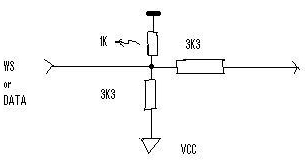

-ecdesigns- said:Hi maxlorenz,
I wish it was that easy, clock buffers increase master clock jitter, the more cascaded buffers the worse this will get. Similar, connecting too many loads (clock buffers) to the master clock gives problems too. Clock buffers have a certain capacitance between both input and output, and there is always (on-chip) ground bounce, meaning that interference can travel both ways.
I currently use following bit clock distribution scheme:
Master clock > bit clock attenuator (330, 330, 100 Ohm) > TDA1543, shortest possible bit clock path.
Master clock > 390 Ohms > UHS buffer > 1K > load.
I now use 3.3V power supply for the TDA1543, so the 5Vpp bit clock needs to be attenuated. Without attenuation, the bit clock will attempt to "lift" TDA1543 3.3V power supply, resulting in increased interference.
The "dirty" loads are connected to the clock buffer using relatively high 1K series resistors, this reduces the power of the interference signals flowing back to the master clock output. I used 390 Ohm series resistor between master clock and buffer for similar reason.

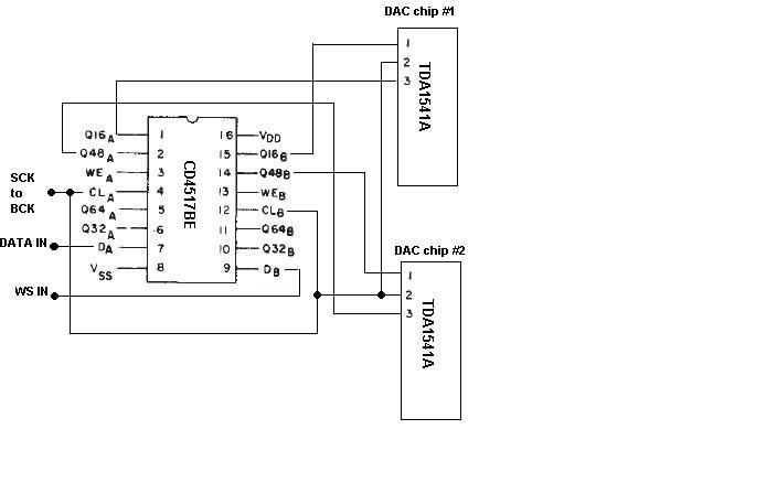

Hello
Yes, DAC with only 2 pcs TDA 1541A
There was a schematic in the thread.
I think, in that schematic, it should be ;
Fsync for the first TDA 1541A and FS32 for the second TDA 1541A
Sdata for the first TDA 1541A and SD32 for the second TDA 1541A
I would use CD4517BE
Thank
Bye
Gaetan
http://www.diyaudio.com/forums/attachment.php?postid=964927&stamp=1153319421
Hi gaetan8888,
For 2x and 4x interpolation only a single CD4517 is required. Not all brands are fast enough @5V power supply, TI works fine.
The propagation delay of the CD4000 series doesn't require to invert BCK when running @ 44.1 KHz.
Bit clock will remain low for 177ns, CD4517 propagation delay (TI) equals approx. 200ns typical, so this is similar to inverting BCK.
This timing is important as it determines the exact moment the DATA or WS signal is stable. The TDA154x latches both WS and DATA on the positive going edge of BCK, the 4517 does the same, and without propagation delay or bit clock inversion, both DATA and WS could change on the exact moment BCK goes high. This would cause data corruption.
But because of the propagation delay, both data and ws signals appear on the shiftregister outputs approx. 200ns later. This means that both DATA and WS from the shift-registers are stable when the bit clock goes high, so the TDA154x chip will clock-in valid data.
The CD4571 has 2 separate 64-bit shift registers with taps on every 16th output (16, 32, 48, and 64).
In order to latch all connected DAC chips on the positive going edge of BCK, a pre-delay of 16 pulses can be used.
2x interpolation (2x TDA1543 / TDA1541A)
Register #1, data input to DATA, DAC chip #1 data input to output16, DAC chip #2 data input to output48
Register #2, data input to WS, DAC chip #1 WS input to output16, DAC chip #2 WS input to output48.
4x interpolation (2x TDA1543 / TDA1541A)
Register #1, data input to DATA, DAC chip #1 data input to output16, DAC chip #2 data input to output48, DAC chip #3 data input to output 32, DAC chip #4 data input to output64.
Register #2, data input to WS, DAC chip #1 WS input to output16, DAC chip #2 WS input to output48, DAC chip #3 WS input to output 32, DAC chip #4 WS input to output64.
Note that the bit clock / WS frequency are limited due to CD4517 specifications. TI specifies minimum 3MHz, and typical 6MHz @5V, so 44.1/16 operation is guaranteed (2.8224 MHz).
Hi gaetan8888,
Yes that should work, propagation delay for CD4517 (TI) equals 110ns (10V) and 90ns (15V) typical.
Don't forget I2S attenuators and DEM clock synchronization.
Make sure to use a separate clock buffer for driving the CD4517, and use good power supply decoupling (create separate impedance zone). This is required because 128 flip-flops inside this chip will switch simultaneously and produce plenty of interference.
Is it like this ?
I presume that using more than 5 volt supply for the CD4517 would change the the propagation delay.

Hello John
Do I need one I2S attenuators for the WS input and another one for the DATA input of each TDA1541A, and so I would need four I2S attenuators ?
I did found an I2S attenuator done by Max, in the thread, is this one are ok, and I should put 5v on the 3k3 resistor vcc pin ?
I include an image of that I2S attenuator.
And for the clock buffer for driving the CD4517, I could use a 74F00 with the pin 1 for input and the pin 3 for output ?
Thank you
Bye
Gaetan
Thank you
Bye
Gaetan

Hi gaetan8888,
Yes this attenuator diagram is ok, use one of these for all DATA and WS signals (you will need 4 of these). Then use two more for BCK, but now using lower resistor values. The VCC of these BCK attenuators are connected to 5V using a 10mH choke, and the 330 Ohm resistor Vcc (that's now connected to the 10mH choke), is decoupled to GND using 1500uF/6.3V. This is very important in order to attenuate 5V power supply noise.
74F00 is a NAND gate and it inverts, you need a NON-inverting buffer like the 74F125 for example. These are also available as a single buffer (Fairchild tiny logic series), but these are SMD.
Also use Damping (series) resistors on both buffer input and buffer output. Experiment with 100 Ohm ... 1 K Ohm.
-ecdesigns- said:Hi ccschua,
The TFTF caps are very expensive indeed, and using these only makes sense when your entire audio set is already performing at a very high level. So I suggest to try some cheaper caps first, Intertechnik Audyn plus, or TIN foil are good and affordable, Obligato (dry caps) aren't bad either.
First I notice changing the cap really change the sound a lot. it is very audible. I dispense the Solen and try the Mundorf Elko Glatt and immediately can hear the details more.
Can I know if I use the single ended I/V for the TDA1541A, how to do the CCS since I can only give 0.7V drop across T1. Do u think if I use 2SC2240 (Toshiba) will be better ?
