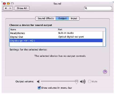

Hi zoran,
First you must make sure that your specific powerbook G4 supports mini-Toslink (this might be optional, not sure).
Next get a mini Toslink (3.5mm) to Toslink interlink, don't use those adapters as they increase jitter and significantly reduce optical output.
There is a metal (gold-plated) tip on the 3.5mm Toslink "connector". As soon as this Toslink 3.5mm connector is inserted in the earphone socket, it will make contact, and the mac will detect a digital output. Without this plug inserted, it switches to analogue output.
Hope this helps.
Hope this helps.
I also tryed with a cable one side normal toslink and
another is already for mac hardware, (without adapter)
still nothing changes...

Hi zoran,
Have you checked, System preferences > Sound > Output?
This shouldn't be such a problem at all, especially not with a mac.
The user manual refers to the 3.5mm headphone socket for digital output. So this should be the correct socket for mini-Toslink.
If your powerbook G4 version has on-board digital output, it must show up in the system preferences.
Yes EC,
I checked hundered times...
but option bar for digital outout does not apeared..?
I have 2 laptop with different OS X
and the same thing about spdif out... nothing at all?
I tryed with a adapter
cable without adapter...
and nothing.
this should be like this but it is not...
and nothing.

Zoran said:Yes EC,
and nothing.
Is that screenshot yours?
MacTracker shows that not all PowerBooks G4 have optical out. (www.mactracker.ca )
Jeroen

it is not my screen shot...
I have only
first line option.
authomatic recognition of headphones/line out when jack apllyed, and internal speakers when pull-out...
without second line digital out
third line is from other sofrware option not from mac os x...
I have only
first line option.

According to my version of macTracker :
Only the PowerBook G4 (1.67GHz) introduced in Oct 2005 has dig out.

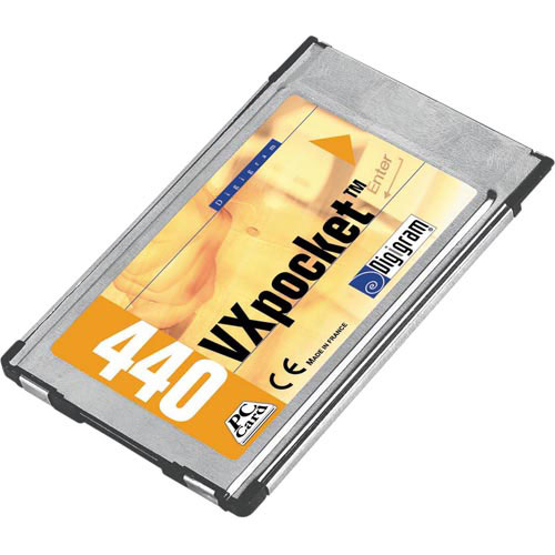

Hi Zoran
I suggest you not to try firewire or usb !!
Your mac powerbook has a pcmcia slot (I think and hope).
I use a pcmcia VXxpoxket V2 soundcard. (Digigram)
It has coax spdif in and out.
On the input I feed it with an external battery powered clock.
(this clock sits in my diy ad converter)
(btw there is no difference between the V2 and the first version only de connection cable differs, the V2 has an extra headphone out in the cable connected to pin 2 from the line xlr outputs !!)
The spdif in and outputs are unbalanced. I balanced it (110 ohm) with a pulse trafo.
I tried all kinds of firewire stuf even the RME Fireface 800 that I happely sold to a rockgroup in Berlin !!. The vxpocket with external clock outperformed them all.
Onno
Hi Zoran
Zoran said:I will try to obtain digital out from the firewire [/B]
Onno

Digigram VXpocket is look like a great piece...
