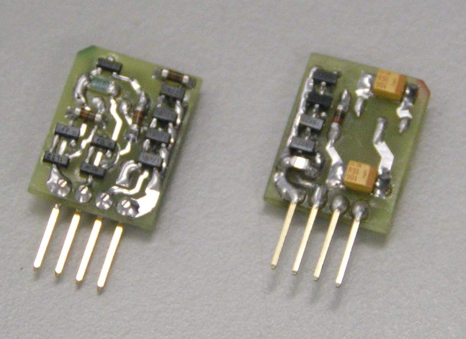

Meanwhile the new voltage regulator modules for the D1M were completed. I attached a photograph of these compact regulators showing both component and solder side. The regulators consist of a capacitance multiplier using a triple-darlington, a constant current source, also based on a triple-darlington, an external 10mH choke, and finally a shunt-regulator, based on 8 x TS431 in parallel. The modules are intended for low output currents (up to approx. 100mA). I use multiple of these regulators in the D1M, output voltages are set at 3.3 or 5 Volts.

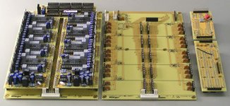

I still have the following PCBs that could be interesting for experimenting:
- DI8 mainboard
- TDA1541A PCB
- I/V converter PCB
- Interpolator PCB
I attached a photograph of the mainboard that can hold up to 8 TDA1541A modules, the interpolator, and 2 I/V converter PCBs.

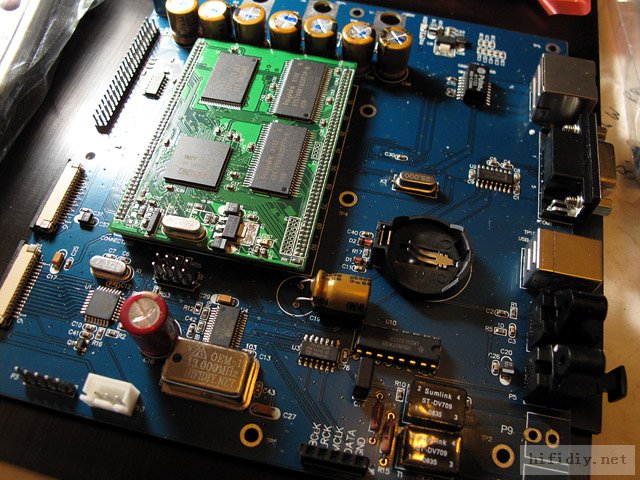

HIFIDIY.NET HDD APE player
Here is the HDD player from HIFIDIY.NET, using ARM9 embed system with I2S output, it is not using CPU clock to generate the I2S since it's higher jitter. (external clock 13M TXCO?)
