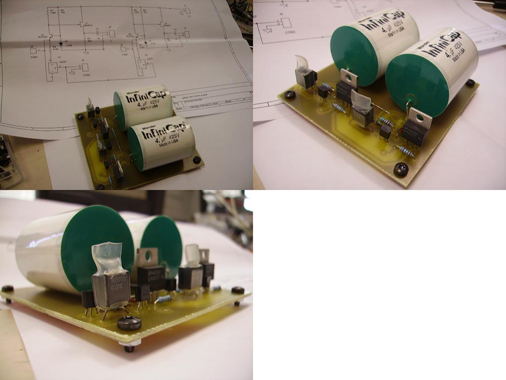

Guys, you should really, really check-out EC's charge-transfer PS on amplifiers!
Today I finished to mod two stereo UCD180 ClassD amps (without the gyrator part of the circuit) that feed my active Tannoy Autograph enclosures (Beyma coaxials) and the change in sound is astonishing.
Clean, clean (safe a buzz that always has anoyed me: the tweeter has 105db/W/m sensitivity; but this year I will tame it!) and detailed.
For this I bought power Mosfet and high current Schottkys, plus Panasonic TSHA (or THSA) 10000uF/63V caps for C1, which were the cheapest (but good) caps I found. The bass is deeper and more articulated, but the whole improvement is not at all like doubling the capacitance as I've done that before and I remember it was rather dissapointing.
So, instead of buying super expensive PS caps, I recommend buying regular industrial type and try EC's mod.

Hi Doede,
I simply connected the "Mosfet type" or version 1 of the charge transfer PS to the existing rectifier bridge (yeah, I'm cheap); D3 is a Soft recovery rectifier diode and D4 is a high current Schottky whose number is longer than this thread...R4 connects to C2 and that is...just as in ecdesigns' diagram
http://picasaweb.google.com/lh/photo/rOgiSl8IVgPdqOcKLPkbNA?feat=directlink
Tell me if this did not help...cause I'm "at work" today with little spared time...
