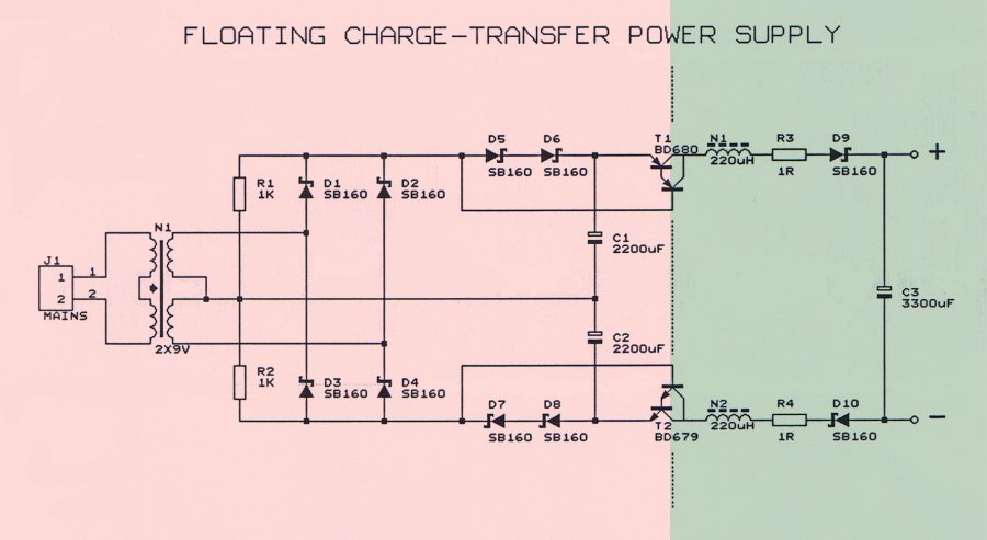

Hi dddac,
If I understand correctly you mean replacing the NPN transistor with a PNP transistor that feeds the current into a passive I/V resistor to GND. The problem is that the TDA1543 must run on lowest possible supply voltage (lowest on-chip ground-bounce), so I run it at 3.1 volts, this is really crucial for best performance. I have to generate approx. 6Vpp (or more) directly across the I/V resistor, and I also must make sure the current flows into the DAC (TDA1543 output signal is current sink). The reason that the TDA1543 can supply current from the plus into GND is due to the built-in bias current source. I want to tap the real output (current sink), instead of the mirrored bias current (ibias - iDAC).
I tried a current mirror (DAC output current is mirrored, and flows to an I/V resistor connected to GND). This functions, but resulting sound quality is harsh and grainy.
By using the latest trans-impedance circuit, I have to use a clean power supply, but with the discrete series regulator feeding a power shunt (approx. 0.05 Ohm impedance), and adding an LC filter (10mH / 23,500uF) power supply is really no problem. The 23,500uF consists of two 5.5V supercaps placed in series.
TDA1543 pin 7 is left unconnected, this is done to avoid modulating the bias current (and indirectly the output current) with external noise / interference. This ensures cleanest output signal. Yes I did compensate for the zero DAC output current, when you study the photograph of the stereo trans-impedance module, you will discover a current source that ensures that T1 remains saturated, even when DAC output current reaches zero. By varying this current, ac signal at the DAC output can be trimmed down to approx. 10mVpp, this ensures meeting TDA1543 25mVpp ac output compliance.
The reference voltage for these current sources is derived from 2 diodes in series (BAS16), fed by a 2.7V precision bandgap reference.
This cannot be achieved by manipulating bias current through pin 7 (tried that), besides, this would prevent cleanest possible output signal.
Yes the simplicity definitely pays off, just look how compact the stereo converter module is. Very short traces, very low inductances. Minimum amount of parts in the signal path. This is a circuit that remains stable over a large bandwidth.
I tried other versions, including the design of Rudolf Broertjes. The simple version posted here seems to provide best sonic performance. Every external current added to the DAC output current will increase the risk of adding noise / distortion, or even invoke spurious HF oscillations. If the external currents are in the same magnitude as the DAC output current, things become highly critical. Other problem is ensuring stability over large bandwidth.

Hi John,
quick question regards the Charge Transfer circuit. I have built exactly as per the attached Schematic:
and can get a smooth DC voltage out when using various AC transformers, however I can only seem to get an initial DC voltage that only seems to charge up when I connect and disconnect the transformer.
a bit more info re the CT circuit. I am getting the 1st cap fully charged and can only get the 2nd cap to charge when I put the DMM probes on pin 1 of the SJ380 and gnd
Hi Builder brad,
Seems that the 2SJ380 is not conducting (gate is not pulled to GND when transformer output voltage drops). This current runs through R1, R2, and R3
You might check if the gate receives a pulsed signal, if not, D5 might have developed a short circuit, and C1 prevents a pulsed DC voltage at the gate of Q1.
You could also try to reduce both R1 and R2 values.
Hi John,
that was quick!
there is not that much of a pulsed signal on the gate, as I am using a bridge rectifier - certainly looks like there is always a couple of volts on the gate.
I will have a play about and report back
that was quick!
Floating CT power supply test
Hi all,
Today I tested the floating charge transfer power supply for the D1M. This one also interrupts GND, so the output voltage truly floats.
I attached the concept schematic diagram.
There is a rectifier bridge (D1 ... D4) using schottky diodes (11DQ10 will be ok too), creating a plus and minus voltage, charging C1 and C2 through D5 ... D8. These diodes are required to create pulsed DC signals for driving both darlingtons, and set the exact switching level. Both R1 and R2 are used to provide a base drive current for the darlington switches. The charge across C1 and C2 is transferred to C3. N1, N2, R3, R4, D9, and D10 are used to attenuate switching noise.
After powering up, magic was in the air 🙂
Hi all,
