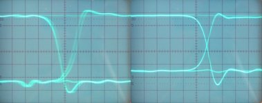

Hi mr whocares,
The I2S signals are fine, and could be used when the DAC is placed in the same housing as the CDPROII, still the I2S signals would have to be synchronously reclocked with a low jitter masterclock, prior to feeding them to the DAC chip. Glue logic may be required to match the format used.
When using the external D1M DAC, I would tap the ebu/spdif signal from the CDPROII electronics, preferably TTL level. Next I would synchronously reclock this ebu/spdif signal with a low jitter masterclock that's also used to clock the CDPROII electronics. I would then feed this cleaned-up SPDIF signal to a Toslink optical transmitter.
I would use real glass-fibre Toslink interlinks, NOT the cheap ones with single clear plastic core. This reduces unwanted reflections.
The D1M has a double SPDIF receiver front-end. The first SPDIF receiver cleans-up the Toslink signal after the Toslink optical receiver, the second performs the actual decoding. Both SPDIF receivers run in slave-clock mode. I attached an oscillogram illustrating SPDIF cleaner efficiency.

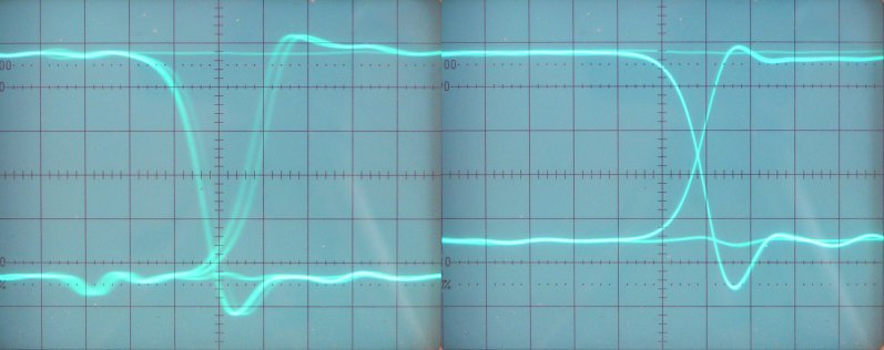

Left oscillogram shows a typical SPDIF signal (Toslink), using a cheap plastic interlink of 10 meters and a lousy Toslink digital audio source. On the right is the same signal after passing the SPDIF cleaner. When using shorter, high-quality, real glass-fibre interlinks, things will only get better.
The CDPROII has an on-board pulse transformer. Even the best pulse transformers have coupling capacitance between both primary and secondary windings (low enough impedance for HF interference to pass). The pulse transformer also has a large bandwidth, so all HF interference can travel together with the spdif signal into the connected DAC. This can be easily verified by observing the received SPDIF signal (phase) noise.
Toslink has limited bandwidth (approx. 10 MHz) this helps to reduce unwanted HF interference from reaching the DAC electronics. This bandwidth is more than sufficient to transport the SPDIF serial data (up to 96 KHz bit rate). 96 KHz bit rate requires approx. 6.144 MHz clock signal that's still within Toslink bandwidth.
The D1M already runs on Toslink. It can also accept USB, using an external USB to Toslink converter. This provides USB option with full galvanic insulation as well. It supports 44.1, 48, 88.2, and 96 KHz sample rates. Since the D1M has CS8416 SPDIF receivers (that can even be swapped with any other receiver because of the modular design), SPDIF coax could also be used.

if you do not recommend to connect the i2s output of the cdpro2 directly to the d1m, what would be the best way to do that? using directly the cdpro ebu/spdif output?
(btw, this output does not require pulse transformer)
do you still consider a toslink for the new d1m?

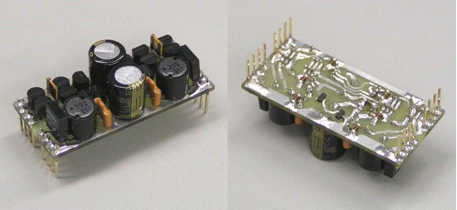

Back on topic, Today I manufactured and tested the final module for the new D1M, it's the stereo trans-impedance I/V converter / buffer module.
I attached a photograph of this module, on the left is the component side view. The electrolytics in the center are decoupling caps for the precision reference voltages. I/V resistors are modified 2K5 bulk metal foils from Vishay. The black bulk metal foil resistors, and the round chokes are part of the single-ended output buffer. The light brown Murata filters are used to stabilize precision correction current sources that prevent T1 (in the schematic) from going out of conduction and ensuring TDA1543 output compliance. Both T1 and T2 consist of 2 transistors in parallel in order to further reduce noise levels. The module is designed to run on a super-clean 9.2V power-shunt regulator. It connects directly to the TDA1543 outputs, and requires an Intertechnik 4.7uF polypropylene / TIN foil coupling cap on the output. This cap was chosen for very detailed, crystal clear trebles, and optimal transparency.
Photograph on the right shows the solder side, there are some SMD resistors and some reference diodes for the correction current sources. The gold-plated pins were pressed into the PCB using a special bench press, then soldered on both sides. The whole module (PCB included) was manufactured, assembled and tested within a few hours.

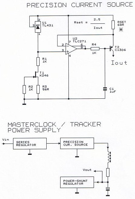

The multi-rate masterclock / tracker module is fed through a high precision current source that's based on a TL431 voltage reference and a low-noise OP-amp. The current source connects to a low-pass filter (40mH and 100,000uF) and then feeds a 5V power-shunt.

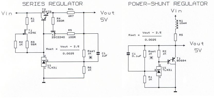

Hi jameshillj,
No, of course not, I attached a schematic diagrams of both discrete series regulator and power shunt.
The series regulator is based on a TL431 voltage reference. RCL, R4, R5 and T3 are an optional current limiter. If no current limiting is required, RCL is bypassed and T3, R4, and R5 can be left-out. Voltage is set with Rset, circuit shows a 5V regulator. For 12V output for example, Rset would need to be (12 - 2.5) / 0.0025 = 3800 Ohms. The constant current source around T1 feeds the voltage reference, it could be replaced by a resistor, but then performance would drop.
The power shunt on the right is basically a buffered TL431 shunt regulator, BC684 can handle up to approx. 4 amps, it needs to be mounted on a suitable heatsink when using larger bias currents. I added a choke (optional) in series with the power-shunt for attenuating power supply noise.

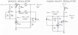

Would it be asking too much to see these TL431 based reg ccts? The TooleShunt Reg is not so simple now, and your designs appear small enough to use everywhere.

Thanks John for the ccts and the info.
Fascinating, and so simple, particularly in comparison to the developing Toole shunt Reg.
Could I further ask - how would you go about inverting these for the -ve voltages for the 1541A, the Kwak clock and my present Rudolf I/V output stages (+/- 18V)?
And, on your previous post, you mentioned that the 1543 chip is fed directly from the master clock at the 11.28Meg w/out reduction to reduce buffer and divider jitter, if I got that right - does the same apply to the 1541A chip (both NOS, naturally)?
Many thanks , and looking forward to the continuing developments of those amazing original dac chips.

Yesterday I tested Vcap (teflon and tin) coupling caps with the D1M (special thanks goes to erikdebest). D1M sound quality really excelled, leaving me completely stunned, it's a HUGE difference. The 2K5 passive I/V resistor is a modified Vishay S102J bulk metal foil resistor.
TDA1543 is now running at 3.1 volts, and I2S signal levels (including BCK) were lowered to approx. 400mVpp. The modified shunt, driving the TDA1543 and I2S attenuators has approx. 0.05 Ohm impedance now. The master clock tracker power supply uses a precision constant current source, connected to a discrete 9.6 volt series pre-regulator. The precision current source drives the power shunt (0.025 Ohm impedance) through passive LC filters. I attached a schematic diagram of the precision current source, and the block diagram of the master clock power supply.
Yesterday I also completed a new charge transfer power supply, it has both plus and minus interrupted (dual charge-transfer circuits). I plan to test it with the D1M.

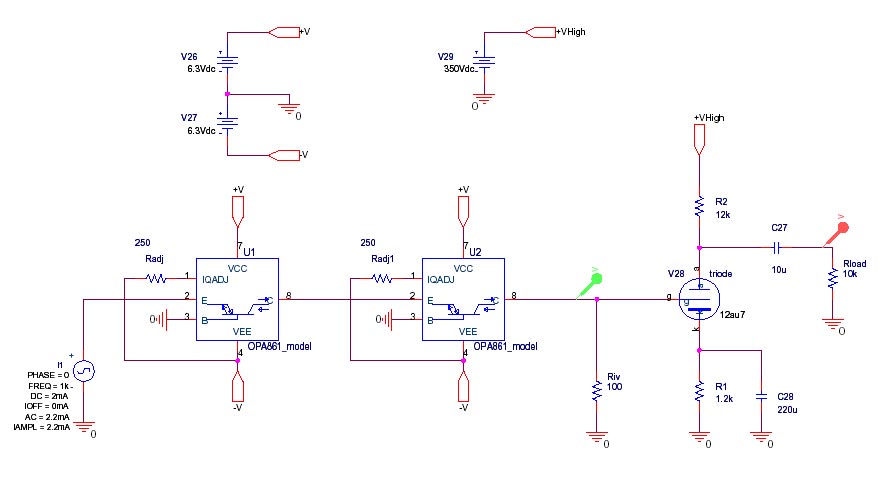

Someone asked for iv with ecc82...
I hate to admit it, since I used to be so pleased with tube sound quality, but the latest trans-impedance I/V converter module easily outperforms highly-tuned tube-based I/V converters by a VERY large margin.
- Distortion (THD) is way lower.
- Virtually zero phase errors (large bandwidth / high stability).
- The sound is highly transparent, and tonal balance is virtually perfect.
- Noise / interference is way lower.
It's also very difficult to find a "good sounding" tube. They are either to harsh (grainy) or too laid-back and midrange-forward. There is also a big quality difference between plain tubes and factory selected matched / balanced tubes. ECC82 isn't the best choice either, there are better tubes, but availability could get problematic. Some of the best tubes are out of production and are becoming very rare / expensive. When using a tube output, it's best to use a trans-impedance circuit like Guido Tent did (CD player kit).
