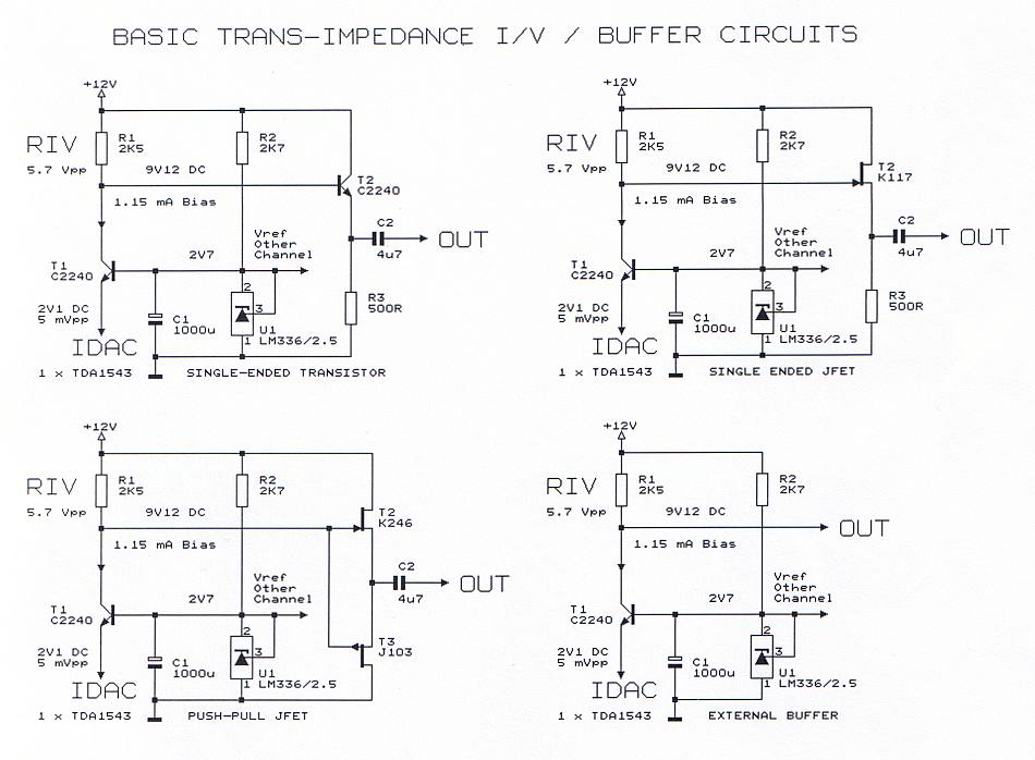

The trans-impedance I/V converter / buffer uses no active amplification ? I already read about 2V output without any active stage but only 25mVpp on the TDA1543, that sounds a bit mysterious to me.
How do you do that ?
And that ?:
24K Ohm resistor for 20W rms
I mentioned that the I/V resistor is not connected directly to the DAC chip output.
Take a NPN transistor, emitter goes to TDA1543 current output, basis goes to 2.7V reference voltage, and the I/V resistor is connected between collector and a positive voltage that's high enough for desired ac voltage across this I/V resistor.
This way, max. ac voltage at the TDA1543 current output is approx. 5mV max (approx. 2 Ohm load impedance), while the ac voltage across the I/V resistor can be way higher. I managed to get 90Vpp across a 39 K Ohm I/V resistor and a power supply of 100 volts.
I used a 2K5 I/V resistor in the D1M, with TDA1543 2.3mA full scale current this generates .0023 x 2500 = 5.75Vpp or 2.03V rms. The ac voltage across the I/V resistor is buffered of course.
And that ?:
Sorry my mistake. With 24K Ohm I/V resistor, a single TDA1543 will output 0.0023 x 24,000 = 55.2Vpp or 19.52V rms. The power supply for the I/V resistor should be around 60 Volts. This voltage is high enough to drive a unity gain power buffer. The power buffer then drives the speaker. Using 24 K Ohm I/V resistor, output power into an 8 Ohm load equals (19.2 x 19.2) / 8 = 46 watts rms.
That high V connected to the I/V R lets out the Digipots probably, because they run on low V. 🙁
Hello John,
would you detail this a little bit plsease...i would like to make an experiment with your indication
I only would like to achieve that 2 Vrms on the TDA1543's output,so please tell me with the use of that 2k5 resistor,what should be the AC voltage across that I/V resistor and what do you mean about "buffered of course" ?
Also ,do you recomend a specific NPN transistor for this job?
Thanks !

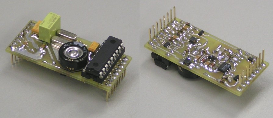

Talking about master clocks, the new multi-rate tracker / master clock prototype module is ready, worked first time. I attached a photograph.
The green part is a sub-miniature relay that toggles between both crystals (11.2896 and 12.288 MHz), the relay gives best performance, the electronic switches I tried increased jitter. The 100,000uF supercap in the center is required, without it, performance drops significantly. The 18-pin chip on the right is the "brains" of the multirate tracker. The required firmware was written by my brother, to give you an idea of his programming skills, he managed to modify the old tracker program in less than a quarter of an hour. Here he said, when he handed me the programmed micro controller, it should work like this. With some disbelief I put the chip in the test circuit, and guess what, the program worked first time.
This is not a straight-forward program, the micro controller runs on the selected master clock in order to minimize interference / inter-modulation. It has to maintain accurate timing for precise frequency measurement, while changing it's own clock frequency through the 12-bit DAC and VCXO. The program has to take into account that the micro could run on 2.8224, 5.6448 MHz, 3.072 MHz, or 6.144 MHz clock frequency. While doing so it has to determine the source sampling speed, and calculate relative correction factor to maintain real-time tracking. The program has to remain stable while toggling between crystals or changing clock division factor.
The picture on the right shows why the component side had only few parts. The VCXO master clock is built around a WF10192 clock chip, and a dual varactor. The power to the crystal is limited. The oscillator produces a nice low jitter sine wave that's then divided to achieve required bit clock. The WF10192 has an integrated divider that provides :1, :2, :4, and :8. The division factor can be set using 2 pins.
The square 100uH chokes are used for power supply filtering.
The module requires a reference clock (256fs) from the SPDIF receiver that runs in slave-clock mode. The module drives a "locked" LED indicating successful lock to applied sampling rate.
There are 3 sub-power supplies, one for the micro, one for the VCXO master clock, and one for the clock buffer. This way, crosstalk between these power supplies can be minimized. Screening will be added later, in order to reduce sensitivity to EM interference.
As you can see, I managed to put this tracker on the same module size as the single frequency tracker.

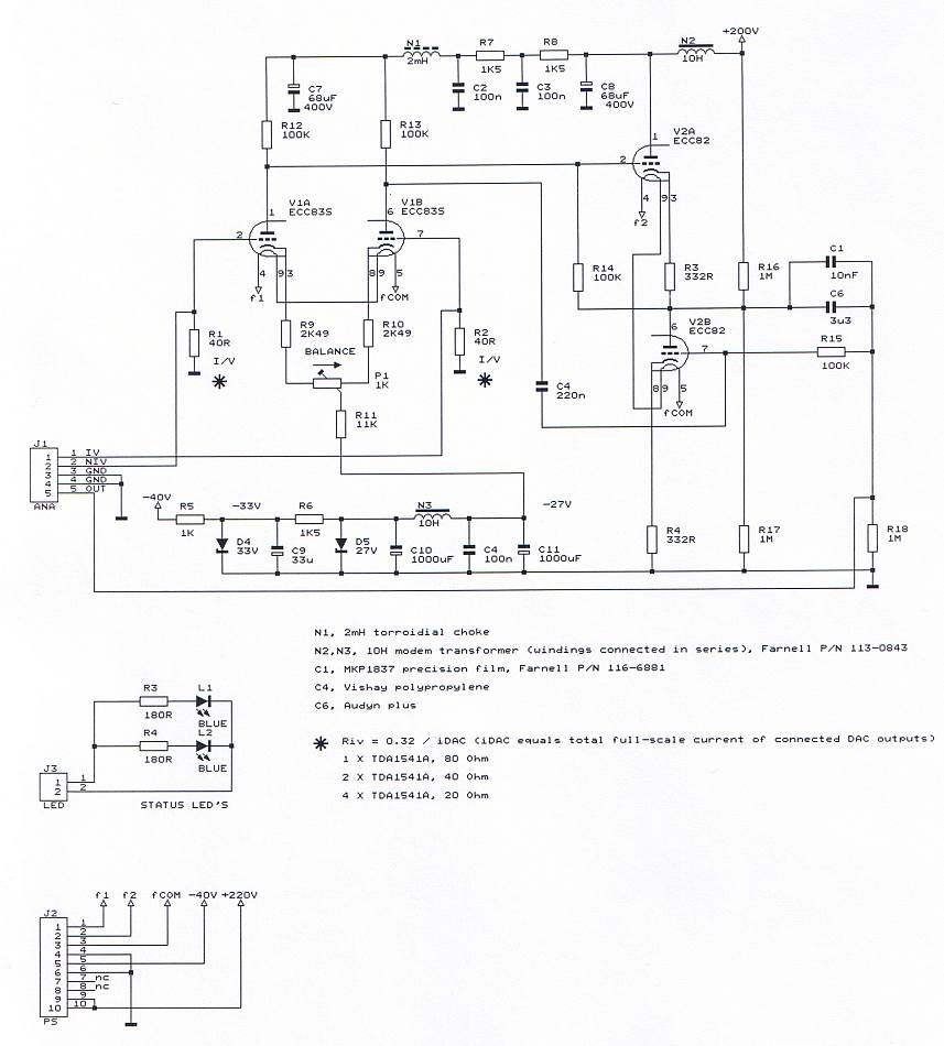

I attached the differential-input tube amplifier schematics, used in the DI4T reference DAC. It uses 2 I/V passive resistors / channel (they are drawn in the schematic).
I personally wouldn't use (audio) Op-amps anymore, not even the best available today. The key issues are the required feedback loop, poor quality on-chip parts, and circuit complexity (difficult to predict and control circuit response). OP-amps rely on the feedback loop to keep distortion low. If the feedback loop fails (locks-out), distortion will increase rapidly, and might turn a 0.0005% THD OP-amp into a 10% THD OP-amp. The OP-amp connected to the DAC output will also be confronted with a very large bandwidth signal, so audio-OP-amps are likely to fail here.
The best I/V stage so far is the discrete trans-impedance converter, as it performs no active amplification. The DAC current isn't amplified, and the ac voltage is simply generated across an I/V resistor. All that's required now is buffering of the voltage across this I/V resistor.

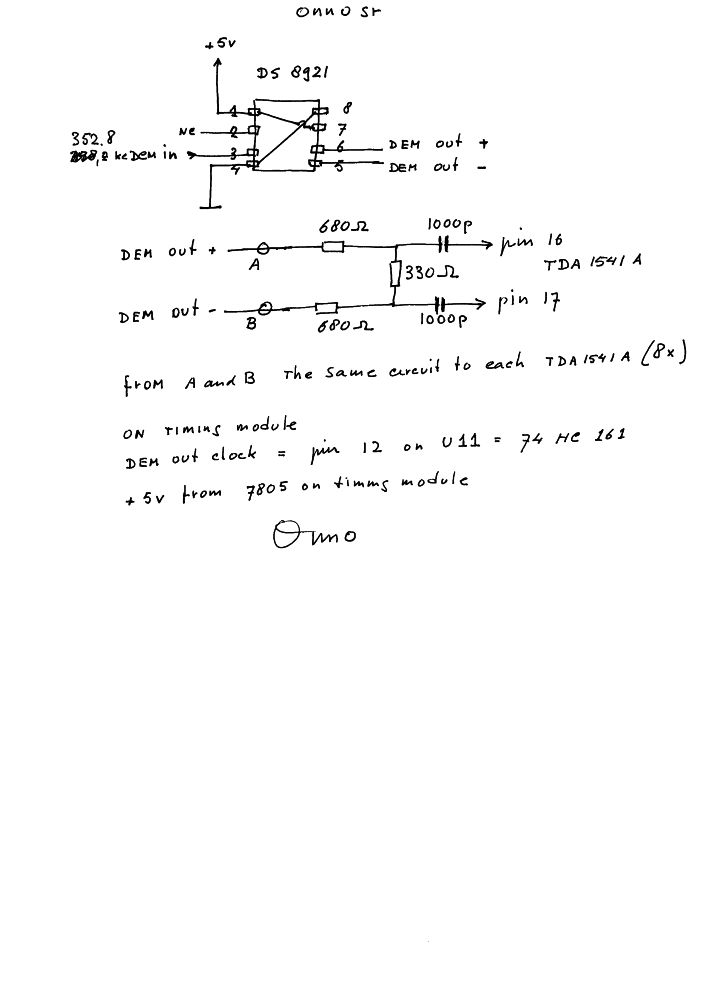

Balanced DEM clock on DI8M
Attachted a solution for balanced dem clock on 352,8 kc
for the DI8M.
I tried a 74HC04. but the inverted chain has a time delay.
Audio not impressive.
Further I tried a 74HC86 for real balanced output.
It works but on the scope a lot of spikes and not a nice square wave. Audio did not impress me.
Then I tried a DS8921 and bingo : clean on the scope and a very noticable clean result on the audio. I like it.
Onno

For a balanced current buffer I found The Circlotron, or floating bridge amp. Would it work?
Yes, why not. It would halve the required ac output voltage at each trans-impedance converter.
The last differential amp he published for the DI4M (now apparently bettered by the D1M) has the other qualities you ask for...but it is optimized for the DI4M...
I attached some basic trans-impedance circuits that could be used for further experiments. The D1M is running on a highly optimized version, based on similar techniques. Note that the DAC current sink runs straight through T1 (that's kept in saturation), and directly flows through the passive I/V resistor R1. So basically iDAC = iRiv. I have to add that the 12V supply must be as clean as possible. The low-noise bandgap reference is required to provide approx. 2.1V DC at the TDA1543 output (2.7V - 0.6V).
The same circuit can be used for the TDA1541A, Vref now needs to be 0.6V (resulting at approx. 0V DC at TDA1541A output) . Simply use a silicon diode or a matched transistor connected as diode for replacing U1. TDA1541A has 4mA full-scale output current, so Riv needs to be lowered to 1K41 for achieving 2Vrms.
