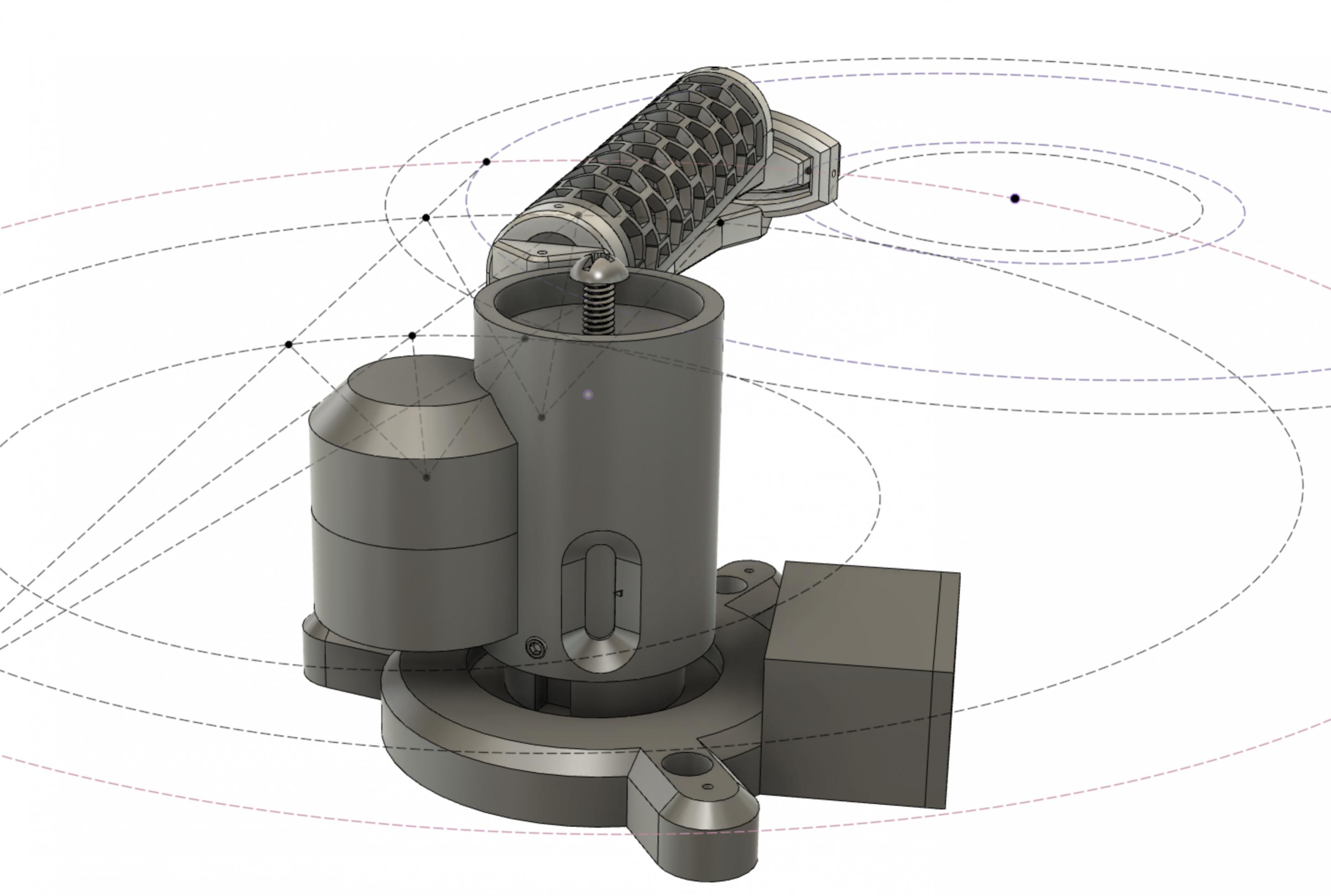

3 point plane
There's a fixed shim behind the bolt so the shim and two set screws created a three legged stool. The bolt is to fasten the 3 points to the armboard. The base is not flat or flush mounted. With such arrangement you get L-R-F-B tilts.
How about in the case of the front is too high even the set screws are all the way up?
I studied Schröder LT again. LT has one fixed mount screw in the back and two adjustable set screws in the front. It is clear that Frank thinks the adjustments need to be left and right side only, not front and back. In my opinion, the adjustments should be all way around. On my 6B, I added three set screws. The level can be adjusted 360 degrees. I am also trying to modify 6C to have an easy adjustment mechanism. Frank, if you are reading this thread, please correct me if I miss anything.
Two screws are enough for a "360 degree" adjustment.
Thanks DD! I have to say it is an elegant design although I still prefer 3 set screws. Attached is the base design for my 6C for now.

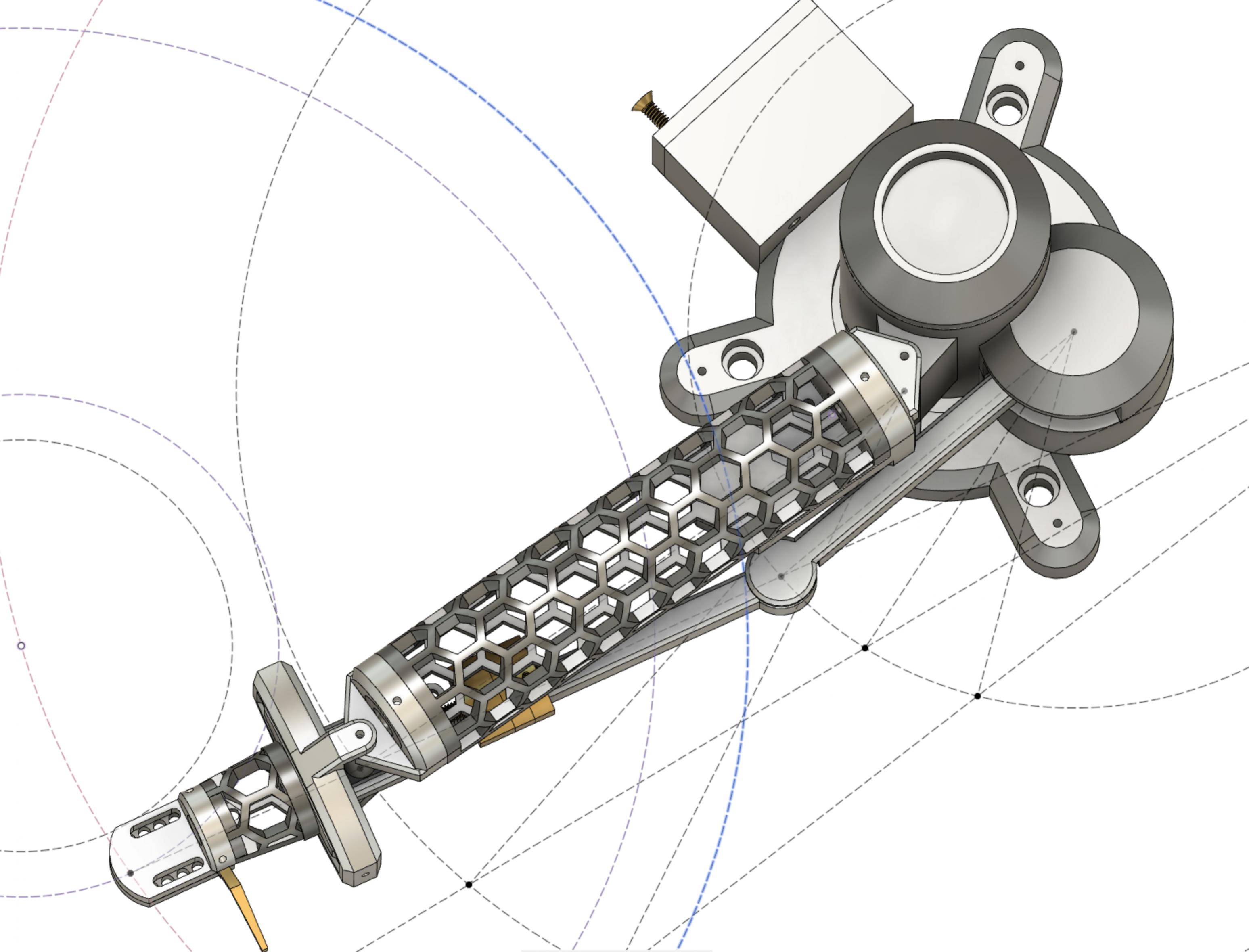

Nice drawing! How do you adjust the height of the column or VTA?
Thats nice sci-fi looking arm .Thanks DD! I have to say it is an elegant design although I still prefer 3 set screws. Attached is the base design for my 6C for now.
I guess you already may have thought of it but I wonder if weight can still further be reduced. Will be easy on bearing. Dont know why one bearing point is moved near headshell ? I think all bearing at pivot (near base/far away from headshell) will act as a 'fulcrum' when stylus point is in the groove so the force/s required to move the bearing attachments will be considerably less.
I also understand the tapering tube (Tonearm wand) will be stiffest but see if following image worth considering. It is based on NAD flat wand tonearm but little modified. The front light blue section is flat and remaining is triangular shape to give vertical stiffness which was lacking in NAD tonearm. All these and Broad end at the rear will somewhat avoid torsional movements.
Regards
Please see the drawing. I plan to use a 1/4" screw in the center of base tower to adjust the height. There is a channel between the base and the tower. Two set screws for locking the tower. I also add a small window on the tower with a height indicator so I can know the position of the tower.

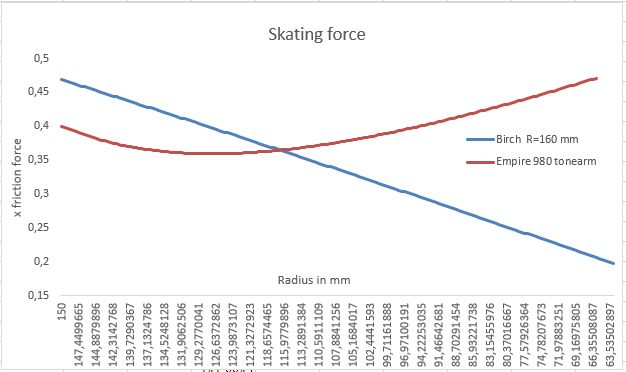

linear skating force
That's a rather linear drop off which means it's much easier to compensate or counter the force with some simple device like a stringed weight, magnet, spring, or offset side force, etc...
I have a feeling the sum of the fiction and whatever overlapping forces in the four horizontal bearings might have created some embedded counter force already that, in practice, it's not even noticeable.
A comparison of skating forces
Contestants: Empire 980 tonearm and Jim's (Super10018) Birch tonearm
I don't know how do you get the blue line and am highly doubt the results since it is not possible that my 6B has higher skating force than a regular pivot arm at 150 mm radius. If my 6B arm's skating force is larger than the skating force of a regular pivot arm at 150 mm, my 6B will skate. In fact, the 6B arm doesn't skate at any radius.
No matter what the reasons behind the non-skating behavior, a non-skating arm is a non-skating arm. It is safe to say that my 6B doesn't skate.
Physics is not a matter of beliefs.
You do not try the string test but you are sure what is possible and what is not.
A tonearm welded to the plinth would not skate either, so it is of interest why a tonearm does not skate.
You could measure the skating force of your arm with the simplest antiskating device: a weight on a string on a pulley.
First you could determine with a blank disc the weight which causes the tonearm to skate inward, then the weight which causes the tonearm to skate outward. The skating force can be determined: (Fout-Fin)/2

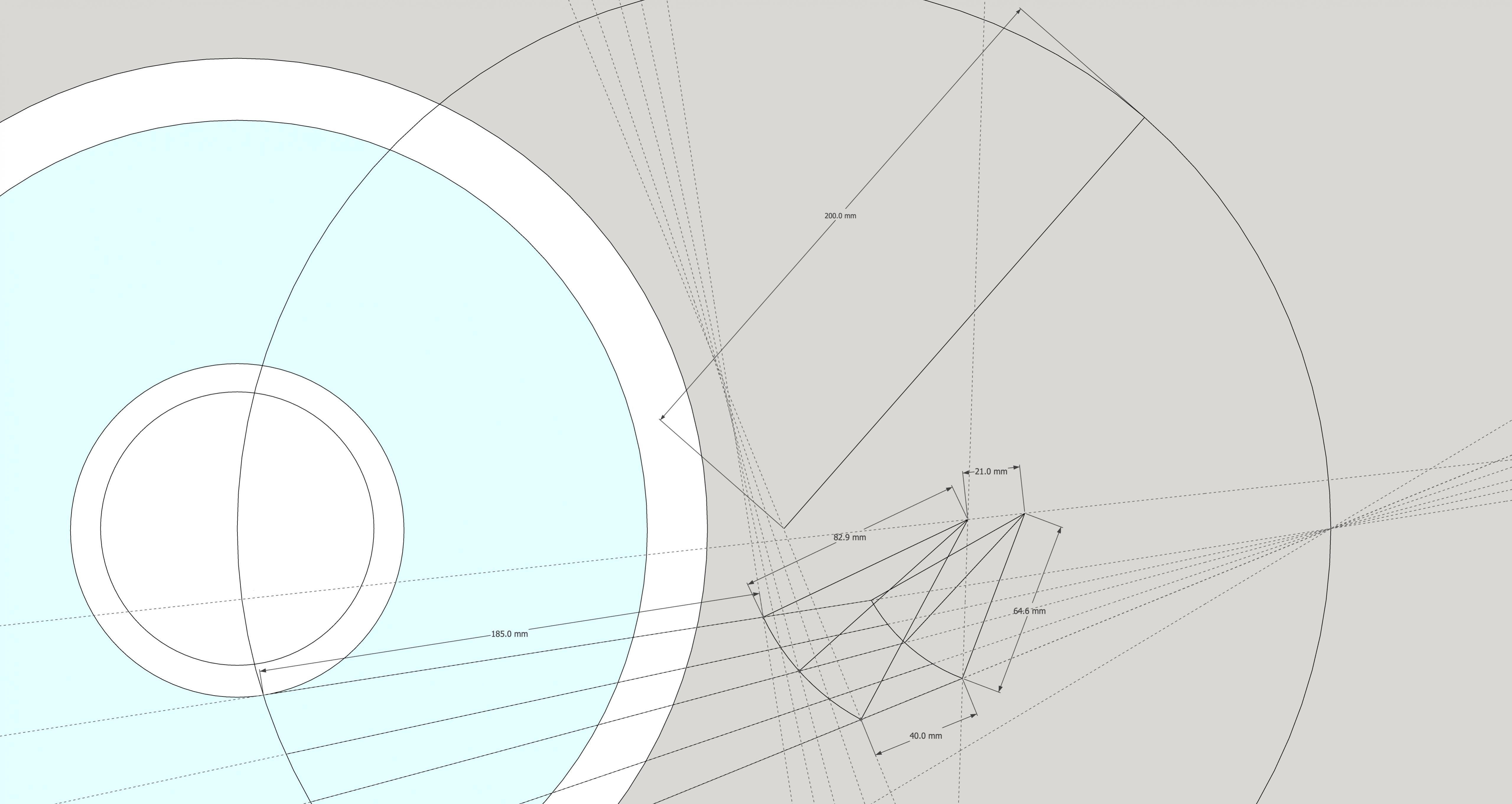

Jim, if I can perhaps do a multibody physics simulation for you?
This might clarify that the reducing angle of the effective length/tangent force vector is the deciding factor in the magnitude of the skate force. To me the biggest win for Birch like arms as they reduce SF where it matters the most, and why it looks so linear.
If you could confirm your geometry, I can set it up.
For this to work, I have to make you moving pivot horizontally unconstrained, so we can see the force at work and not the geometry.
2wice,
That would be nice if you can do it. Please see attachment. If you need other information, please let me know.
