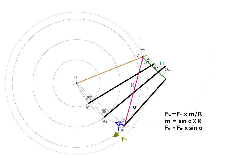

Ok. Here is your formula.
Fsk=Ffr sin(α)
For my 6B, α=0. sin(0)=0
Fsk=0.
Skating force is 0.
Is this correct?
No. With Birch type tonearms, you have to calculate with the angle between the tangent to the path of the stylus and the line from the stylus to the spindle. With traditional tonearms, this is equal to the angle written in Rumpelmann's article.

In addition to my comments above, you took offset angle out from Rumpelmann's equation without any considerations. It is completely wrong and unnecessary. Even using original formula, offset angle is zero for my 6B.
Not true. I took out the tracking error. This is the answer to your next question too.
As I wrote, the offset angle in traditional tonearms is equal to the angle between the tangent to the path of the stylus and the line from the stylus to the spindle (+tracking error), so I did not "take it out".

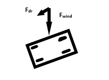

It is not rocket science. Let's take a frictionless wagon on which the wind blows and exerts a force Fwind.
The angle α between the wheels and the direction of the wind is 110 degrees. What is the magnitude of the force Fdr which drives the wagon?
Fdr = sin (α-90) x Fwind
Same with stylus.
Excuse the drawing.

Now, it is getting even worse.
Fs =Ff •sin(Θ)
Θ is offset angle. Θ=22 degrees.
sin(Θ)=sin(22)=0.374
Fs=Ff •0.374
For pivot arm, its skating force is constant. Clearly, it is not correct.
In any cases, I appreciate your efforts to calculate the skating force of my 6B. However, the formula you used is NOT for PT arm at all.
I want to emphasize again. It really doesn't matter what you took out or what you added in, the formula in the article by Klaus can't be used for calculating the skating force of PT arms without modifications. If you want to use this formula, you have to understand clearly about effective length, tracking errors, and offset angle for PT arms, and establish the relationships between these factors.

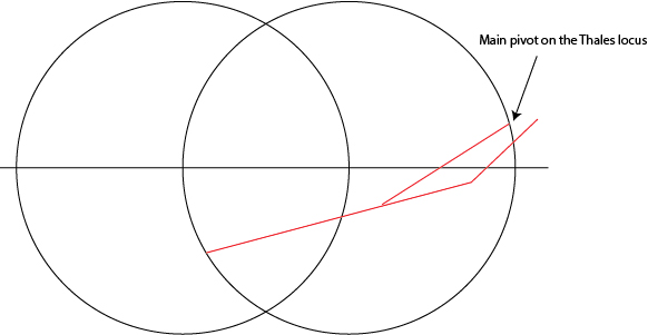

I don't know how to do the math but I am confident that when it comes to skating force in a hypothetical frictionless arm the main pivot, the fixed static one that's supporting majority of the mass, should be as close to the Thales locus as possible to achieve the least skating force. And if the main pivot is located at the locus, it would have zero skating force.
I am not sure what you mean. Please see attached image. Does this image represent your view correctly? The main pivot is on the Thales locus.

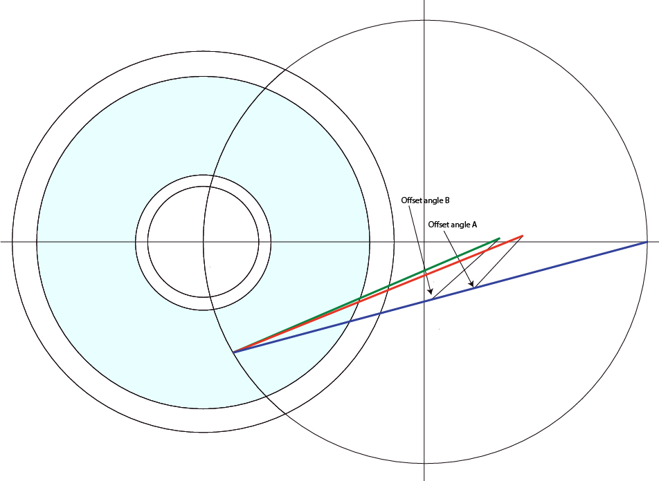

That is a good question. What is the effective length of a PT arm? Please see the image. I take the geometry of my 6B as example. Everything is about my 6B arm in order to avoid any confusions.
The green and red lines are traditional definitions of effective length. The blue line is non-traditional definition of effective length. For the blue line, its pivot is a virtual pivot. All these three effective lengths vary.
Furthermore, what is the offset angle for a PT arm? By traditional definition, there is no offset angle for a PT arm for my 6B. However, if we can define the offset angle in non-traditional sense, there will be two offset angles, A and B as in my drawing. The offset angles vary cross the surface of the record.
Yes. Everything can be calculated. But not in the way what alighiszem tried to do.
If we try to discuss that topic further, we need to have agreement what is the effective length for a PT arm. Frankly speaking, I don't form an opinion so far although I lean toward the blue line as the effective length for a PT arm. So, what is the offset angle for the blue line? I don't form an opinion either.
What I was trying to say is the formula used by alighiszem can't be used for calculating the skating force of my 6B without any modifications.
Your effective length is the green line, it is the outermost and 1st fixed pivot in the mechanism.
The offset is the acute angle between the green and blue lines, not the angles marked, it gets smaller approaching the spindle, not bigger.
