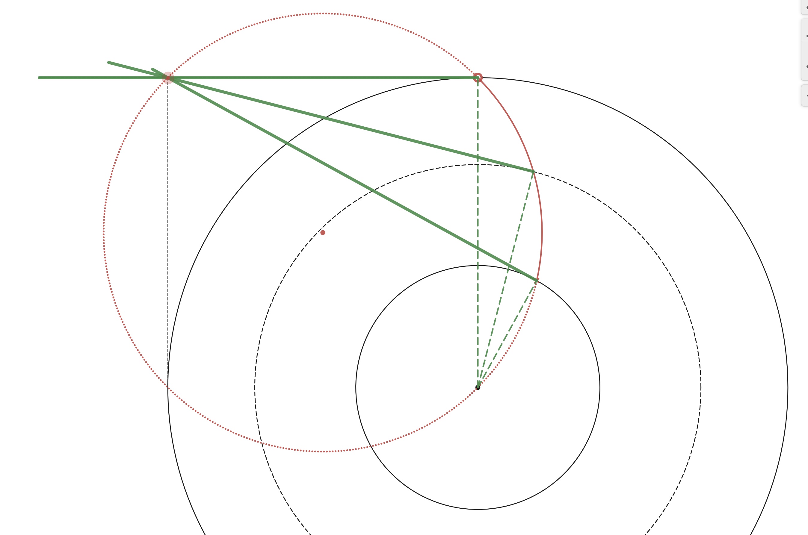

In every tonearm based on the Thales circle the effective length is the radius of the Thales circle.
This is wrong. Here is an example of a pivoting tangential tracking tonearm. The effective length increases from the outer groove to the inner groove. This has to be the case for the stylus to remain tangential to the groove on the Thales circle.
Bon said:The effective length increases from the outer groove to the inner groove. This has to be the case for the stylus to remain tangential to the groove on the Thales circle.
Hi Bon,
The effective length of the pivoting tangentially tracking tone arm I have designed, never changes. The stylus/cantilever of any tangentially tracking tone arm is NEVER tangent to the groove!

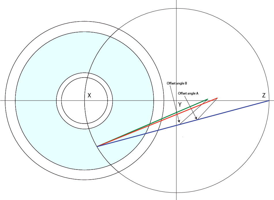

Let’s examine alighszem’s statement.
Please see the diagram. The radius for the Thales circle is XY while the diameter is XZ. The blue line is arm effective length( let’s assume it is the effective length for now in order to carry on this discussion). Obviously, his statement is incorrect. The effective length is neither the radius of the Thales circle nor the diameter of the Thales circle.
As I suggested early, let’s forget the geometric concept, effective length. For the purpose of analyzing skating force, all we need are force vectors, and the interactions of all the force vectors.

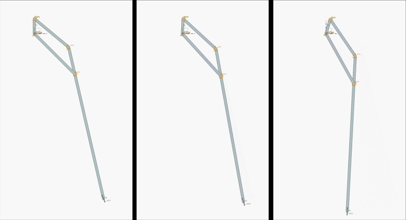

I did the simulation slightly different, the mechanism is seized, this allows the velocity to represent the SF at a single point instead of a range in translation as in the previous simulation. 2nd pivot is lifted, so we can see the velocity instead of reading a reaction force in numbers. The magnitude of the velocity is directly proportional to the SF at that position. Obviously exaggerated, there is no mass, so no inertia or friction for damping.
Green - Red - Blue
You can deduce that the SF reduces towards the spindle fairly constantly, it is nearly linear, my previous calculation showed a slight increase in the rate of change, but it was not much. Very similar to Al's calculations but with a little bow downwards at the end, might just be a scaling issue on the axes.
I did note something in the Geometry, if the distance between the fixed pivots is increased by 0.7mm the sum of the adjacent sides is equal to the sum of the opposing sides, so I did that. It does not change the outcome.
Not sure if it is of any interest.
SFx3
Green - Red - Blue
