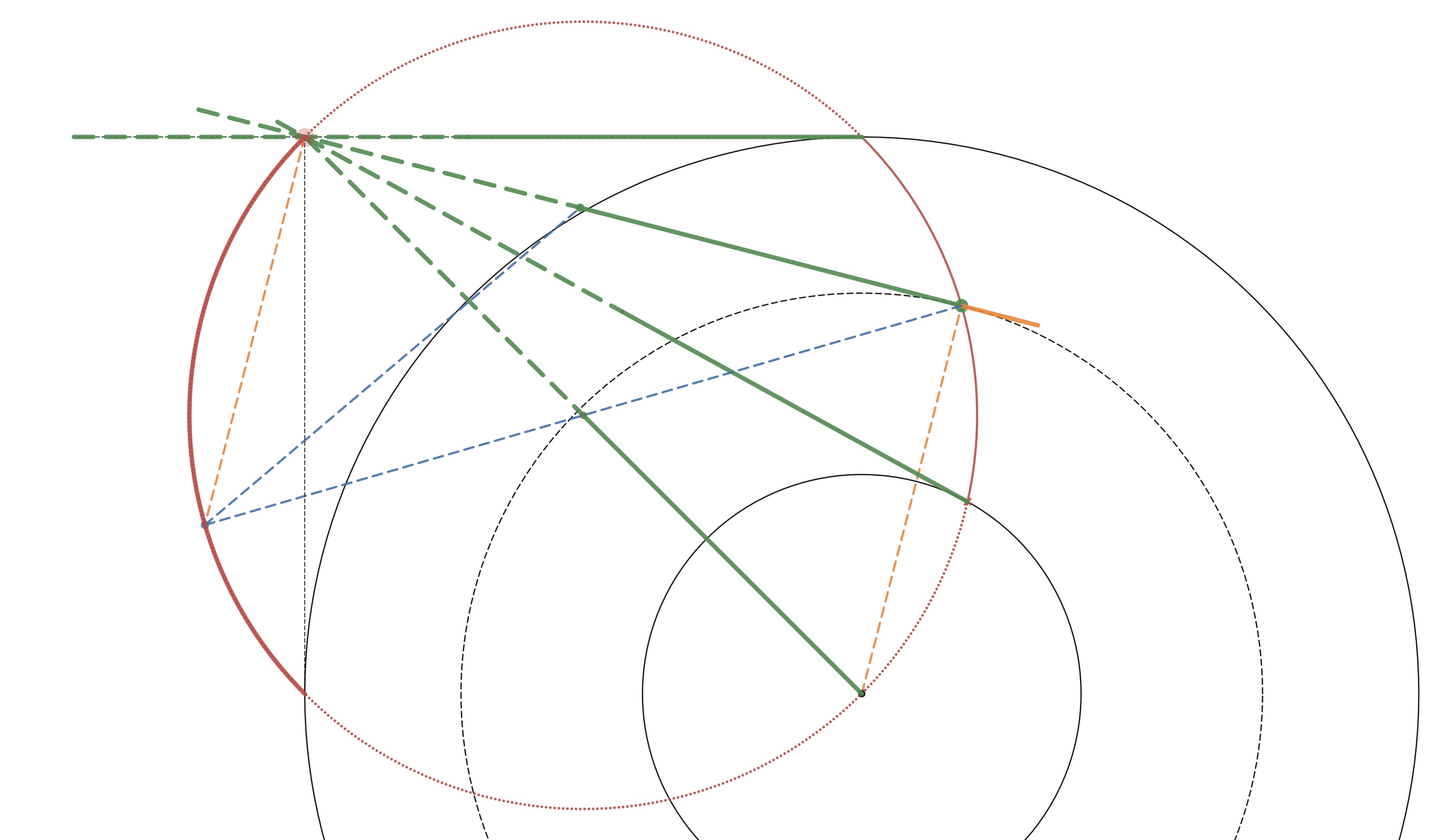

Previously my skating torque calculations for tangential tracking tonearms with various pivoting configurations, have consistently arrived at the same formula, sometimes via tedious resolving of pivot forces induced by stylus drag. The identification of the instantaneous centre of rotation (IC) now makes the reason for this obvious.
In the attached diagram, the tangential stylus drag vector (bold orange) generates a clockwise torque of the tonearm about the IC, proportional to the radial distance from stylus to spindle. This is independent of the pivoting configuration. The skating torque is present regardless of the pivot arrangements.
For a nominal outer groove radius b = 14.605 cm and inner groove radius a = 5.75 cm, the skating torque decreases linearly from 100% to 39.37%.

I have been checking the passive tangential tracking geometry as the physical length is varied. To be clear, I am referring to a tangential tracking geometry, not an approximate one. As the Thales circle diameter increases there will be a penalty due to increased moment of inertia. With increased length also comes increased positional sensitivity. Any small errors in the rear pivots are amplified at the stylus.
On the converse, as the tonearm length decreases, so will the Thales circle diameter and the positional sensitivity decreases. Taking into account the inertial benefit, there is an advantage to choosing the shortest convenient length to achieve a vernier type of effect due to the pivoting structure. There is a practical limit to how short because the stylus has to reach the inner groove.
I anticipate that there will be arguments that higher sensitivity is good … smaller pivot motions to achieve stylus position.
I don’t agree if accuracy is the target. There are consequences to high gain.
I have settled on a compromise of total length equal to the Thales circle diameter as in my diagram #206. A consequence of shorter tonearms is that depending on the configuration, the pivoting structure may overhang the LP surface. I am not bothered by this, but some implementations might be affected. Your tonearms seem quite compact though, so my analysis
may not accurately reflect the approximately tangential geometry.
As Straight Tracker (#217) has pointed out, we mostly are obsessive about perfection in this thread. I accept that badge and restrict my investigations to exclusively what I consider to be perfect passive tangential tracking geometry. For me, discussions of approximate tangential geometry quickly gets bogged down in the minutiae of the particular implementation.

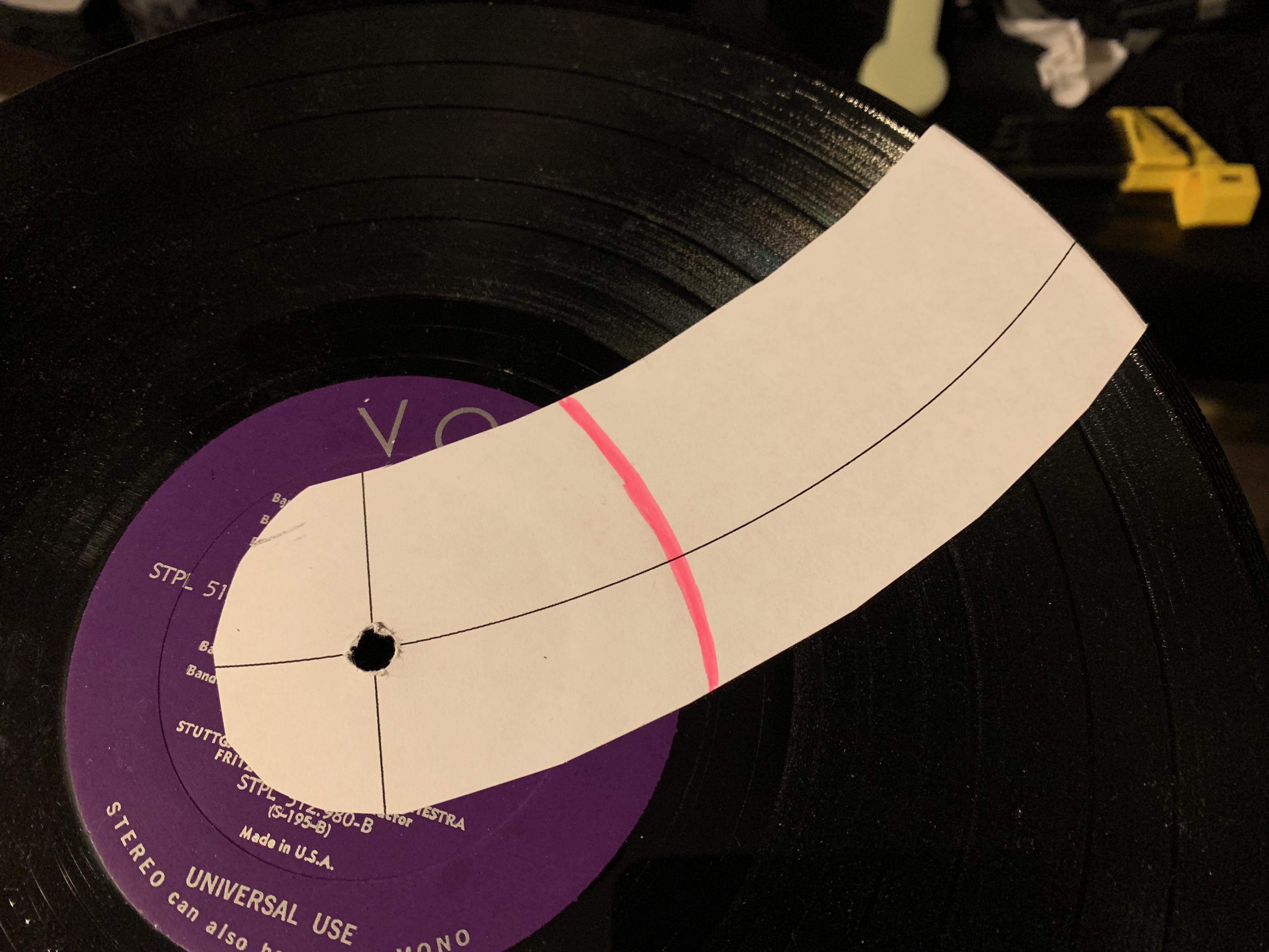

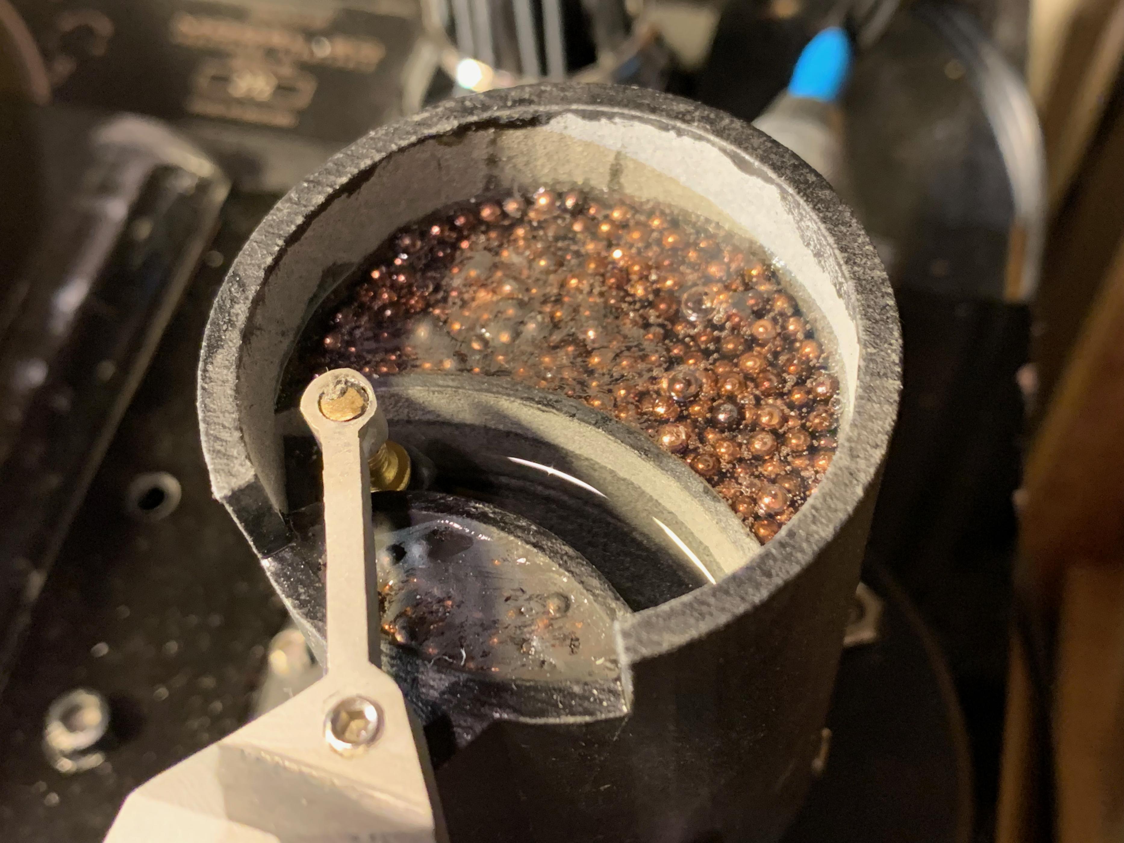

I finally had a listen to my 6B.
The cartridge I used is Ortofon A90, a medium compliance one. I was very impressed by the bass performance of 6B tonearm. A90 is not a bass-heavy cartridge, but on the 6B, its bass is fully competent with the same cartridge on my air-bearing tonearm. I feel it may be slightly better than it on my air-bearing tonearm. High frequency and mid-range sound natural and smooth although the detail can be improved. However, A90 is not a very detailed cartridge. All Ortofon cartridges are kind of “boring” without special sonic characteristics except their top-of-the-line, Anna. Natural sounding is the outcome of lacking tracking errors and skating.
The background is quiet. It is far better than regular pivot arms. It further got improved once I added silicone fluid. I used 40 CST silicone fluid. Please see the photo. I understand that silicone fluid mainly damps the peak of the resonant frequency. It also reduces inertia and other unwanted movements so the background seems to get quieter once I added silicone fluid. But my air-bearing tonearm is still the king of the darkness.
I made a template to align the cartridge. Please see the photo. It is very easy to align the cartridge on my 6B.

The journal to build my 6B is a learning process for me. First, I learned a lot about Birch-style geometry. Secondly, it was a surprise to me that the tonearm doesn’t skate. This alone enforces my confidence about PT arm greatly. Last, it helps me to realize how important horizontal balance is for Birch stylus arms. The total cost of my 6B is about $400. It is worth the money spent to achieve such sonic performance. It is funny to me that people are still trying to eyeball two null points, and all they get are inner groove and skating distortions.

Thanks for building the PLT and sharing. I enjoyed the build process/reading/comments. Thanks for listening impression too. 🙂
