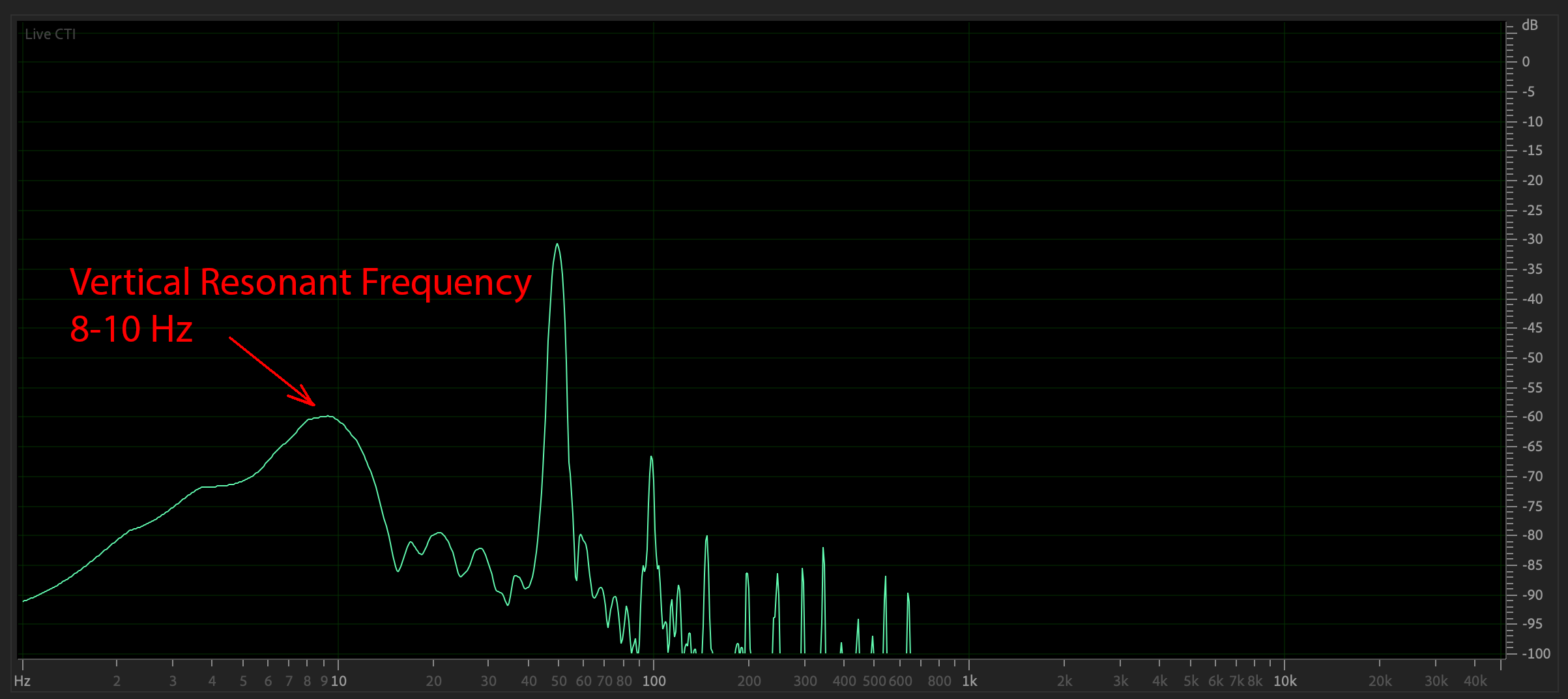

Bearing friction for PT arms is non-issue at all. Effective mass isn't a problem. As long as the resonant frequency is under 20 Hz, ideally 15 Hz, it will be fine. All tonearms designs are the same with resonant frequency, not only PT arms.

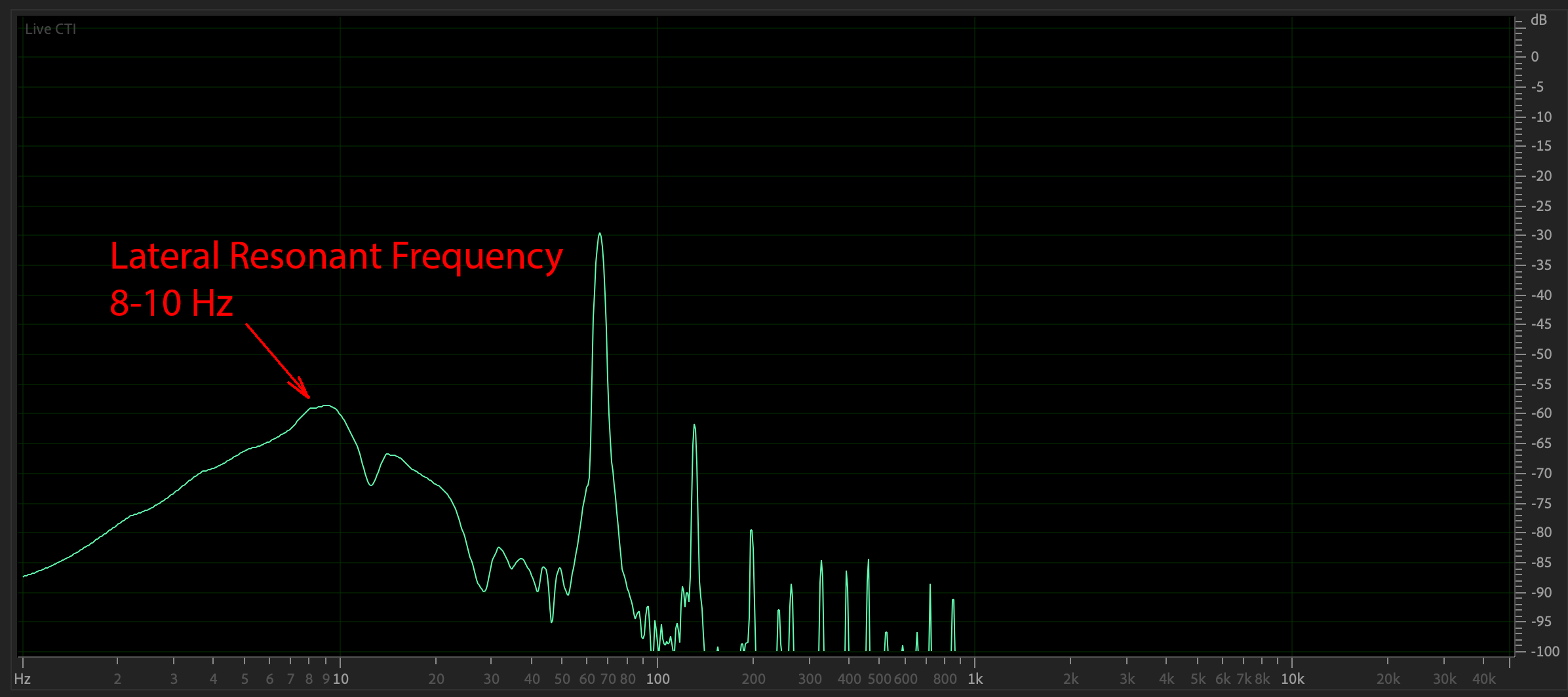

I did resonant frequencies test today. Please see attached images.
The test tracks I used are from Cardas Frequency Sweep and Burn-in Record. Track 8a is 49 Hz lateral modulation and track 8b is 49 Hz vertical modulation. The results indicate that both vertical resonant frequency and lateral resonant frequency are within 8-10 Hz, which are very good. This is exactly what I expected.

Bon raised an interesting question that the lateral resonant frequency may change across the surface of the record. In order to confirm his view, I run three tests.
The tracks I used are from Hifi News Test LP. There are three 300 Hz tracks on the LP. The 1st one is on the most outer groove. The 2nd one is in the middle of the groove, and the 3rd one is on the most inner groove. Bon was talking about lateral resonant frequency. But I don’t know if these three tracks are lateral modulation.
On the most outer groove
In the middle of the groove
On the most inner groove
These tests did confirm that the resonant frequency of my 6B tonearm is 9-10 Hz.
The resonant frequency decreases from 10 Hz to 6 Hz, then it increases from 6 Hz to 10 Hz. I can’t explain the reasons underlying the pattern of changes. In addition to that, I don’t know if the tracks are lateral modulation. Therefore, I think these tests are inconclusive.
In any cases, as I said it before, it doesn't matter too much because from 6 Hz to 10 Hz, the resonant frequency is well under 20 Hz. It is completely fine.
The HFN tracks are lateral. This can be checked by looking at L-R. It should be much smaller than L+R. I recall tonearm resonance should also lie above around 5 Hz to avoid typical LP warp and ripple. 6 Hz is cutting it too fine.

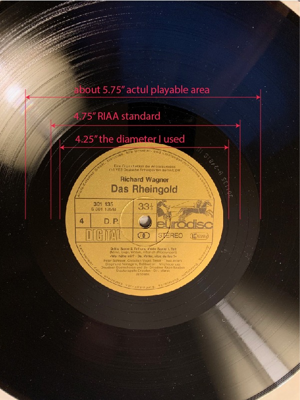

I would like to add additional comments about the playable area of LP in the above post.
According to RIAA's LP standard, the minimum inside diameter of an LP is 4.75". But I used 4.25". Furthermore, the minimum inside diameter of the actual playable area is about 5.75". In the beginning, I thought to measure about 100 LPs to determine the playable area of an LP. However, I gave it up without measuring. If I used 5.75", I could even reduce the tracking errors more. Does this make any difference? Probably not. In theory, it might help to reduce tracking errors more.

Please see the photo. Actually, I should use 4.75" instead of 4.25". The actual playable area is another option as I haven't seen an LP that has the groove up to 4.75.
I just measured every side of my Solti Mahler boxed set of symphonies 5-7.
Diameters of recorded inner groove in inches :
5.2, 5.4, 5.2, 5.9, 5.6, 5.3, 5.1, 4.8, 5.5, 5.4
Random sides of pop LP's inner recorded groove diameters:
4.60, 5.00, 4.9, 4.8, 5.2, 5.3
Only the one inner groove measures more than 5.75"
In general non-classical have inner recorded grooves closer to the RIAA standard or even further in.
The 4.75" seems closer to the mark but the 5.75" figure does not appear to be useful in modelling.
Well, I might not state it clearly. I just took an LP randomly to illustrate my point. It doesn't mean I think 5.75" is a proper dimension to do the model. As I said in my previous post, I thought to measure about 100 LPs to get an estimate of the average dimension. In some cases, the actual dimension may be larger than the dimension I chose to design the tonearm, it really doesn't matter too much since the tracking errors are just starting. The tracking errors are very small anyhow.
