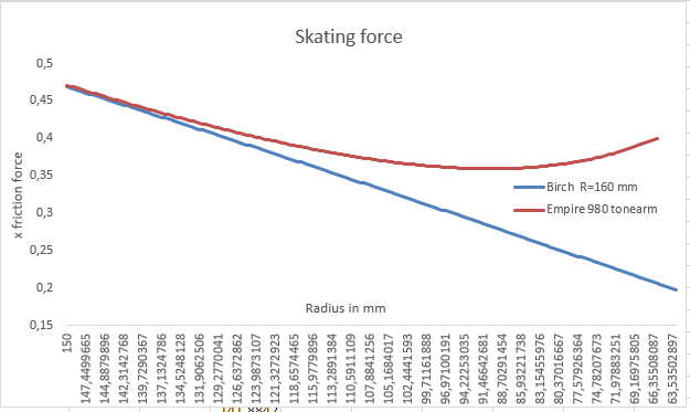

When the radius of the Thales circle is 200 mm, as on your drawing, than the comparison with the Empire tonearm look so:

The purpose I used a larger Thales circle was to reduce tracking errors. If his calculation is correct, it reduces skating, too.

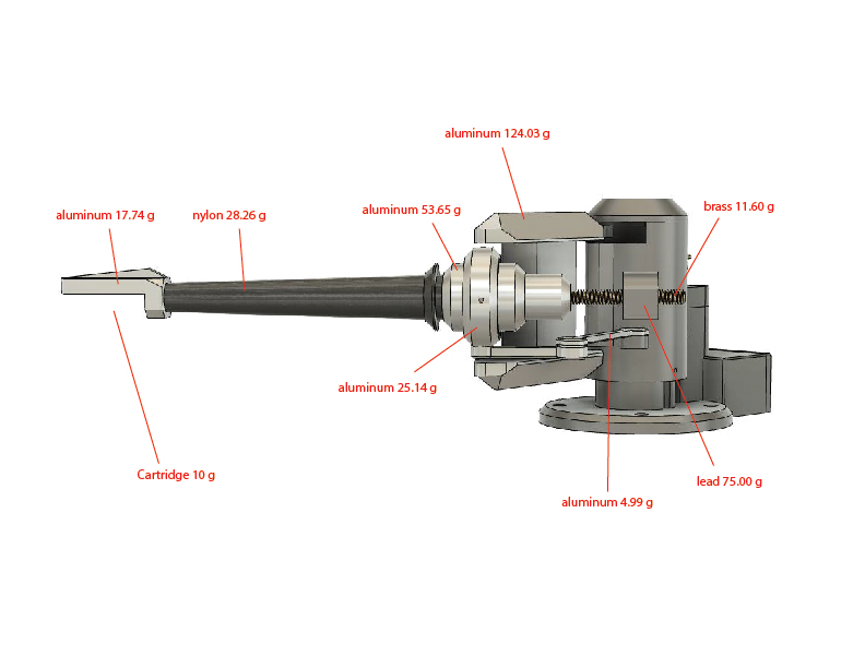

Any chance you can list the parts and their mass, please, Jim?
I'd like to factor in inertia, this might allow the determination of what magnitude of motion friction would be required to damp out SF.
I modeled the same arm in Fusion 360, too. The arm is slightly different from the version I did in Sketchup. Please see attached image. Thank you for your time!

I thought about this when I was modeling the arm. The weight of the arm can be reduced. However, I have a tendency to make everything heavy duty.
There is another possibility that the heavy moving parts is one of the reasons to cancel small skating force.

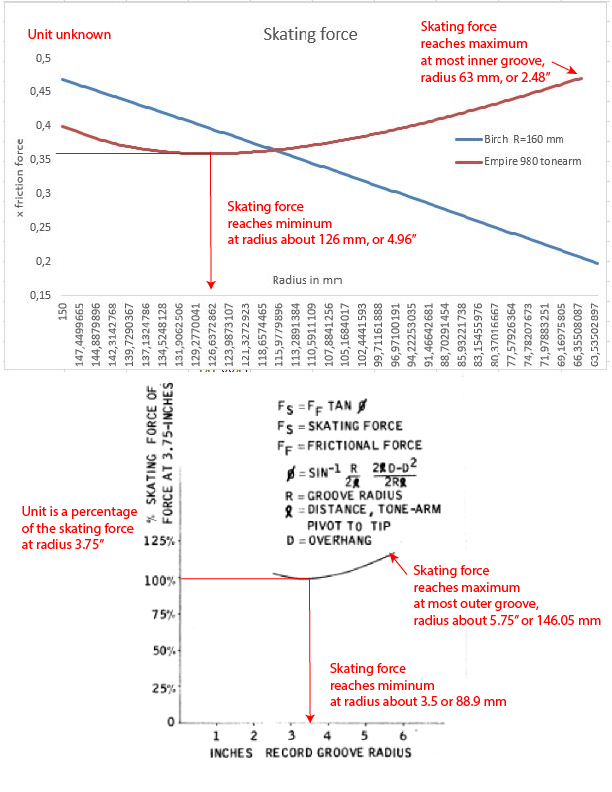

Here are the 4 reasons that I think your calculation is problematic.
1, Please see the image. The main conflict between your calculation and Kogen’s calculation is when the skating force reaches its maximum level. For a regular pivot arm, yours is at the most inner groove while Kogen’s is at the most outer groove.
2, In Kogen’s equation, D is overhang. Obviously, it is zero for my 6B. L is effective length. For my 6B, there are 4 pivots. Which one do you use to determine the L, effective length?
3, For a regular pivot arm, which Kogen used for his calculation, the effective length is constant. But for my 6B, the effective length changes depending on the position of the arm. How do you use Kogen’s equivalent to calculate changing effective length?
4, In your 2nd calculation, once you input different value for Thales circle, the results were changed, too. Why is that? Kogen’s equation has nothing to do with the Thales circle. Does your equivalent need Thales circle?

For a Birch type tonearm it is unrealistic and unpractical to calculate with effective length or the (nonexisting) overhang. So I calculated with the formula I wrote on the illustration in #11.
Klaus Rampelmann quoted the same formula (see here) from Randhawa, “Pickup arm design techniques”, Wireless World, March 1978, p.73; April 1978,
p.63.
The skating force is according to physics and the formula a function of the radius of the Thales circle of a Birch type tonearm. If the radius of the Thales circle would be infinite, the tonearm would be a tangential tracker with zero skating force.

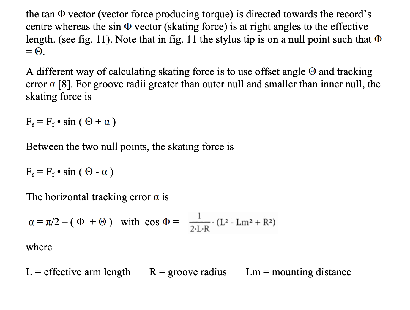

Is this the formula you were talking about? Please see attached image. For my 6B, tracking error is not 100% zero but it is very small and in a very short distance. Its maximum value is less than 0.1 degrees. It is reasonable to assume tracking error is zero. The offset angle is zero, too. If someone thinks the offset angle for a Birch arm is the angle between arm wand and its pivot, no problem, the offset angle varies across the surface of the record.

Fs =Ff •sin(Θ+α)
Above formula is for regular pivot arms only. For a Birch arm such as my 6B, both Θ, offset angle (if you want to use the angle between arm wand and pivot link), and α, tracking error ( if you insist that tracking error is not zero even the tracking error is very small) vary across the surface of the record.
As promised, I answer your first question: you are right, the curve has to be flipped horizontally. I got lost in the spreadsheets.
