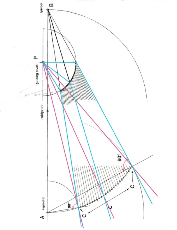

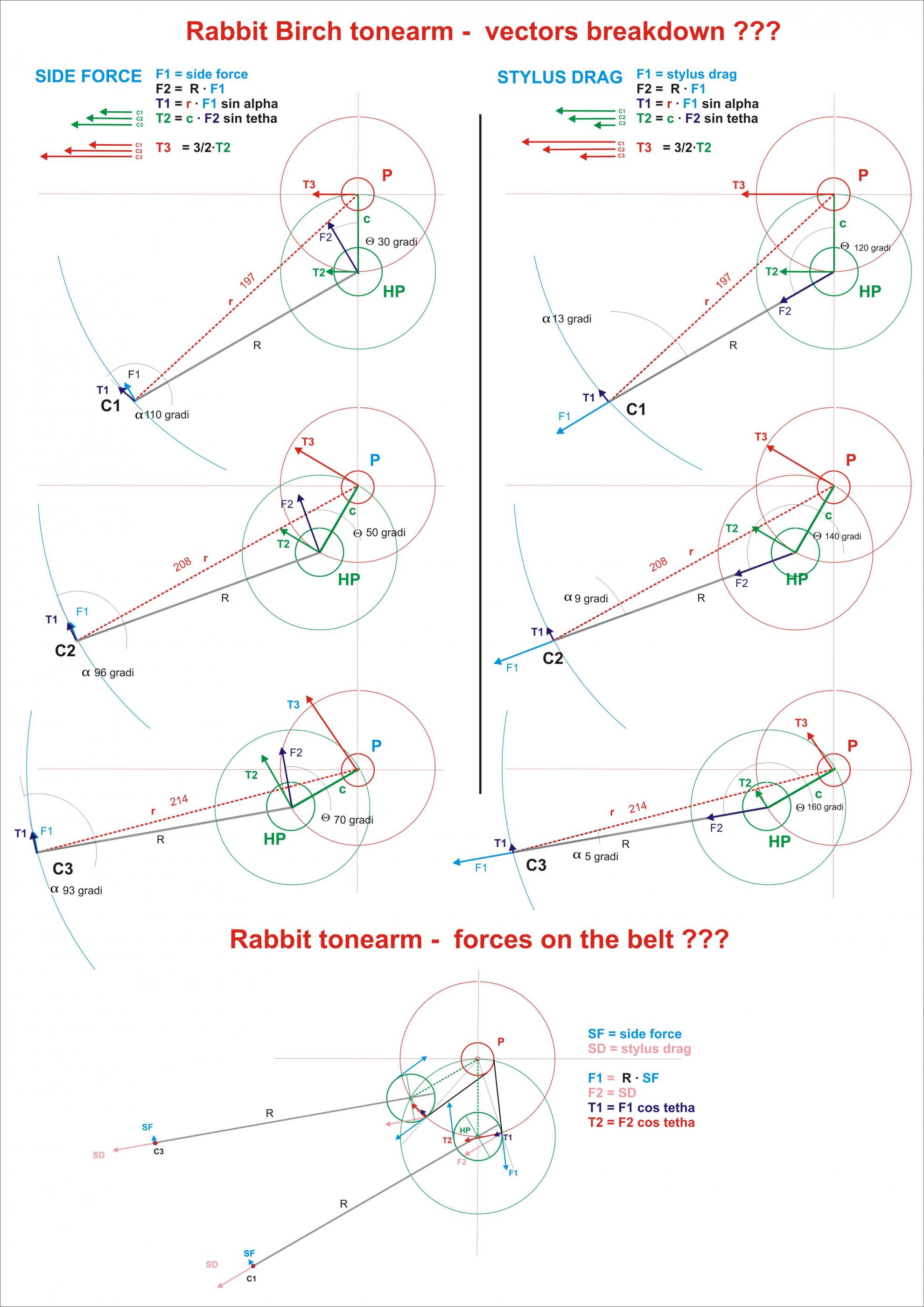

Let's take a hypothetical perfect PLT, frictionless bearings, absolute alignment in both axes, the arm vertically neutral then attach Ray's string and pull. The arm will swing forward and toward the pivot. I am convinced it will show "skating," and fail the test, but there are at least two questions. Carlo has asked: How do you apply the exact equivalent of stylus drag and does it make a difference? And my question is and has been: How much of that movement is simply the geometry doing exactly what it's supposed to do and how do you separate those forces and results? If you pull at the headshell, the PLT will move forward and inward. If you push sideways at the outer pivot, the headshell will move forward and inward. If you push the CW from the rear, the headshell will move forward and inward. Same dance everytime.
In other words "how much and why?" Carlo and I have both tried to answer the second question. Building a test rig which might answer the first question wouldn't be difficult, but, since the forces are so small, actual measurement could be tricky.
Jim hypothesized that PLTs inherently have no skate, built his arm to prove that, and believes he was successful. My take is that he has built a (potentially) excellent arm, but I believe his tests so far don't confirm his no skate hypothesis, but do show how small the existing forces are. I still consider skating in PLTs to be a hobgoblin since the forces are so small and easily dealt with as to be almost irrelevant.
I suggest the reason for designing and building a PLT is because, if successful and correctly set up, it will do a nearly perfect job of putting the stylus precisely where it should be at any point and moment on the record and, consequently, allow the cartridge to reproduce what's recorded accurately and to send the best possible signal to the rest of our system and to us.
The real test of Jim's arm will be how well it does that. I think it just might pass.

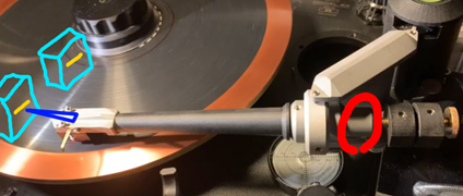

some newbie random thoughts.
Level :
as we dont know all the multiple bearings are on same axis (perfectly Parallel to each other) the bubble level at base would give mixed results. we only want the horizontal tonearm movement to be (already leveled ) platter.
Please look at picture. If one clamps down the vertical movement of tonearm (Shown in red circle), fix a sharp pointer (Blue) on headshell with tape, Have a perfectly flat square piece (Amy material/shown in cyan color) with marking. and if tonearm base has level alignment screws. Just adjust so that pointer on headshell meets marked level on the piece. Move the piece to record lable . Move the tonearm and adjust the tonearm level.

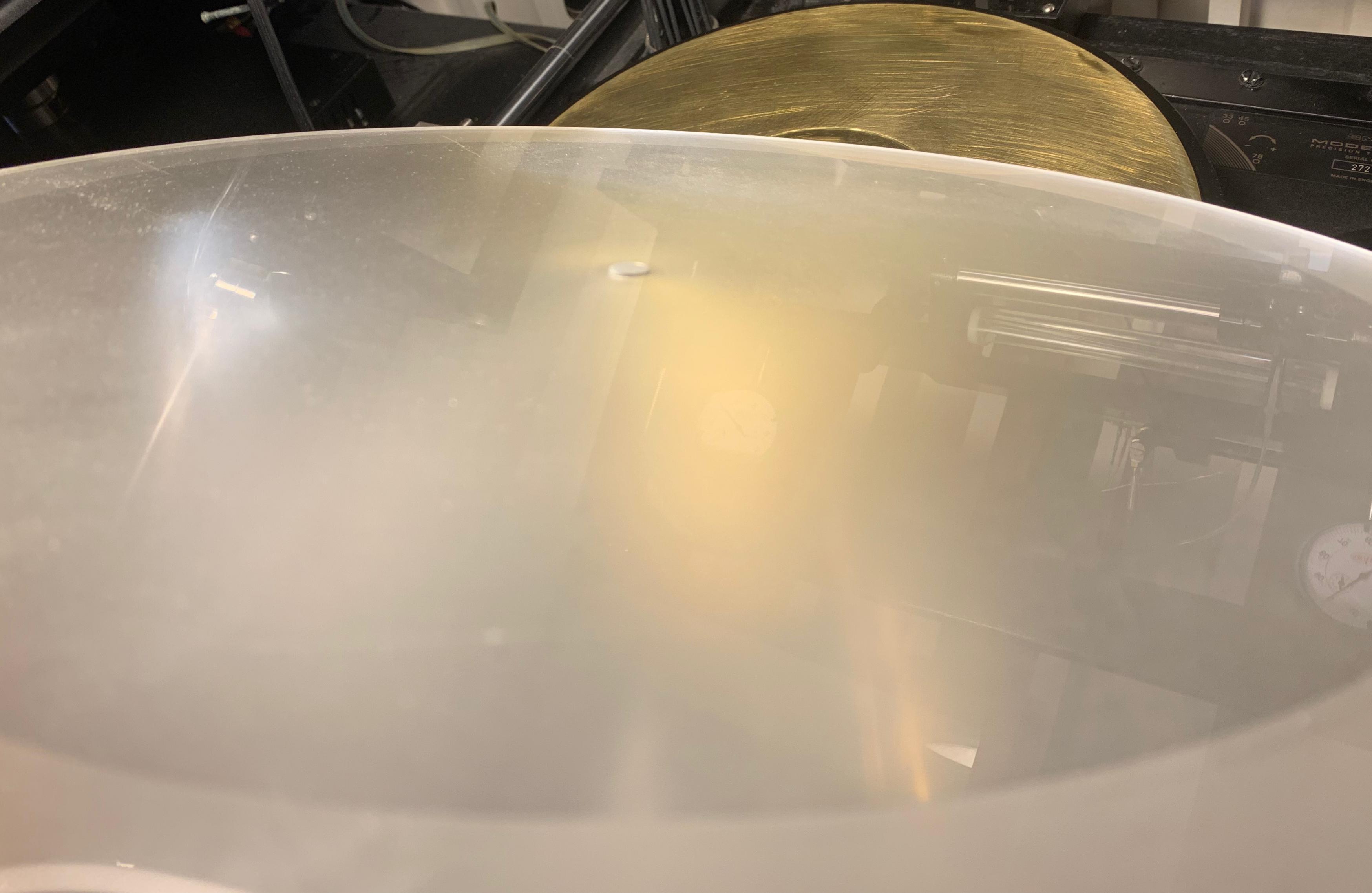

If one has blank record or Laser disc would that be of any help in understanding skating for this particular arm ? Or some test records ?

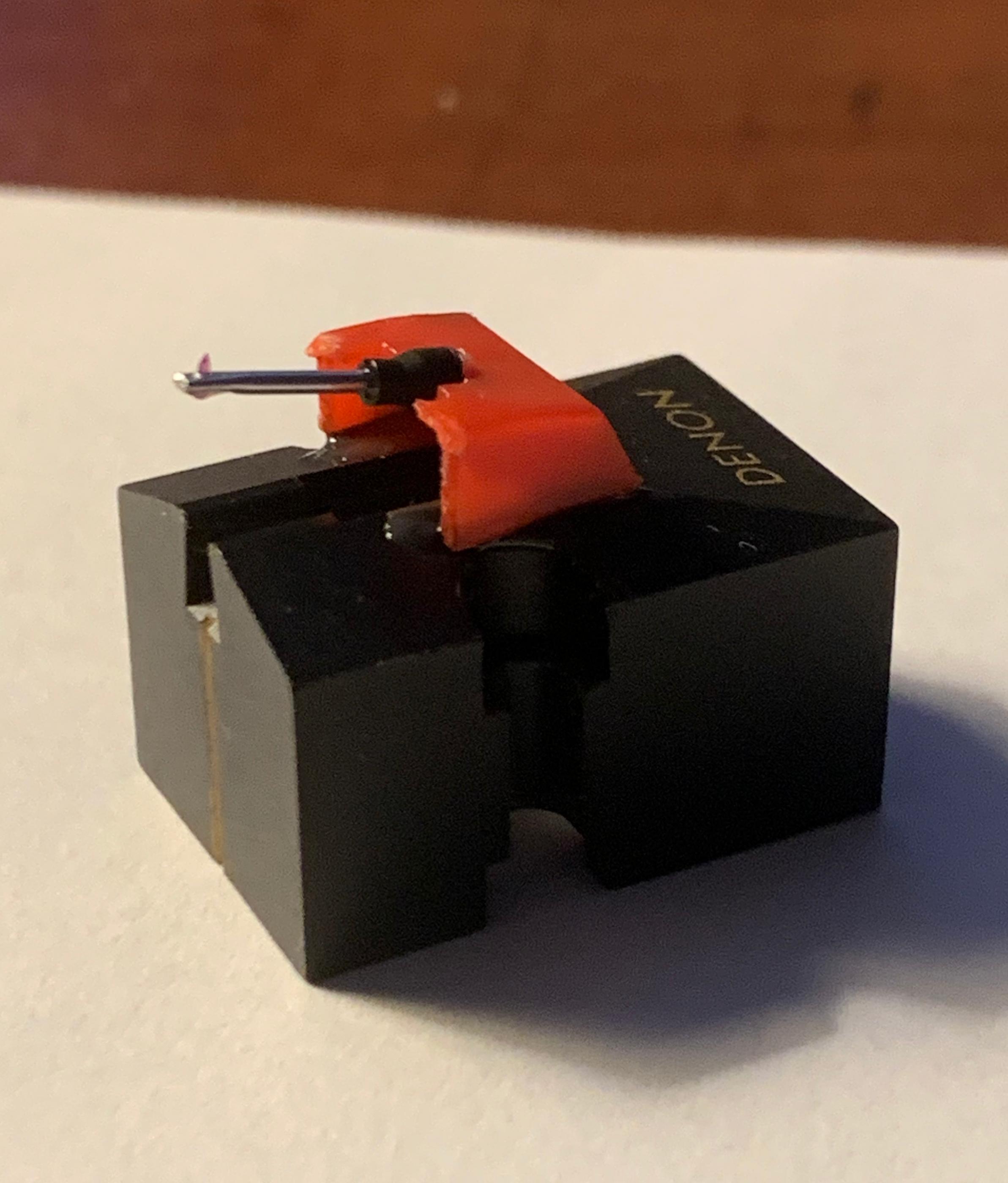

The dummy cartridge I am using for tests is a Crosley stylus glued on the case of Denon 103. I also added some weight in the case to make the testing cartridge about 10 grams. I am going to make a new dummy cartridge. Please see the photo. The cantilever is well exposed so it is easy for me to see the deflection of the cantilever. I don't know the compliance of Crosley stylus, but it seems high to me by touching the stylus.
Such test may only prove how efficient the linkage is. Next conclusion maybe is still a speculation. If the linkage is inefficient, the linkage may cancel the skating force out. If the linkage is efficient, there is still the possibility that the skating force is cancelled out or something else which I don't know.
In any cases, it is a good idea to see how efficient the linkage is to know more about my 6B.
laser disk as blank record
Laser disk! I never thought of using laser disk as a blank test record. That's a brilliant idea. Because of its mirror surface, it's even more effective in detecting skating or side forces. I need to dig out my Criterion collection! :D
