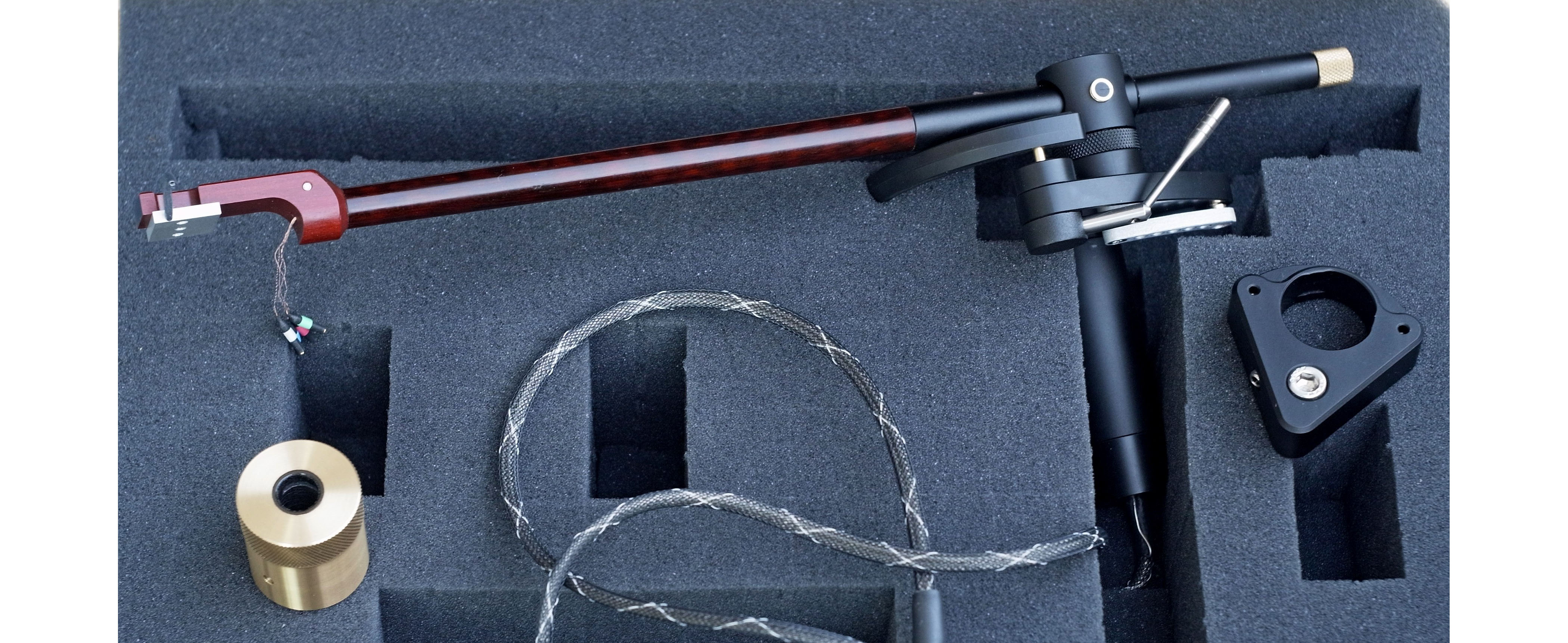

I just noticed in some pictures of headshell & headshell of the Schroder LT tonearm in this page that's similar to material in the OMA K3 headshell. So this is something Frank used before.
After looking at Frank's arm carefully, I have two questions.
There seems a separate metal piece directly over the cartridge. Isn't it better to print it together with the arm wand?
Judging from the photo, the piece of metal over the cartridge has a different texture from the arm ward. Is it printed in a different metal? If so, what kind of metal it is?

Further thought. I do like Klaus' statement. But after my tests, he may need to modify his language a little. It is no problem for regular pivot arms. For a Brich style arm, there are at least 4 pivots horizontally.
leveling adjustment
As a commercial product the Schröder LT does have leveling adjustment as explained by Frank from another thread, quoted below. As you can see in this picture that the base is a 3 point design for micro-leveling with one mounting bolt and two adjustable set screws.
While your arm may exhibit no (or very tiny) visible skating for whatever reason, Frank admits in the quote that his arm allows adjustment to " compensate for any remaining skating force that stems from the overall geometry." So, his LT arm does have small amount of skating.
Perhaps Doug can chime in on this. I wish there's a Dual Skat-O-Meter to verify it. From what I saw the 6B does have tiny amount of skating probably trumped by bearing friction, unleveled side force, and/or various hidden microscopic counter forces, as suggested by Ray.
So, in the end skating becomes moot or insignificant to worry about in practice and certainly miles less than traditional overhung tonearm. That means a Birch style arm is a viable option for tangential tracking. And that's a good news!
All these commercial Birch style arms don’t have the mechanism to adjust micro leveling. It may be a problem for users while they are not even aware. A bubble level is just a rough indicator. It is not enough.
Just a brief comment regarding the compensation of skating force on the LT. There are several ways to compensate for any remaining skating force that stems from the overall geometry, like changing the proximity of the guide magnet vs. the guide rail over its length.
The main reason why you won't experience the arm showing any tendency to move inwards or outwards when either "riding" a blank record or with a Dual skate-O-meter on a modulated record is the fact that the stylus drag can be countered nearly 100%(within the stylus drag/vinyl friction coefficient variation range) through vertically offsetting the main bearing by the correct amount and in the right direction(180° to the stylus drag vector).
The main arm assembly, which sits on a rotating cantilever(so to speak), can be seen as a pendulum and it will seek the lowest position. The base of the LT allows for not just leveling, but ever so slightly off-setting the arm to generate a force exactly opposing the stylus drag, hence avoiding the generation of a skating force. Cancellation would be the proper term here...
And, quite obviously, such an arrangement wouldn't pass the "attach a string and pull along the cantilever"-test as the generated drag will always be far higher than the stylus drag.
