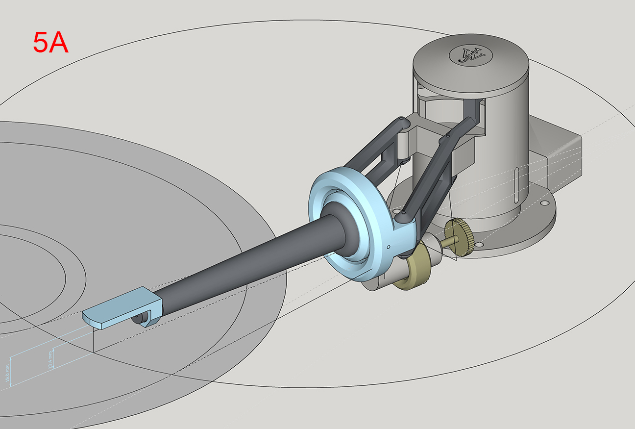

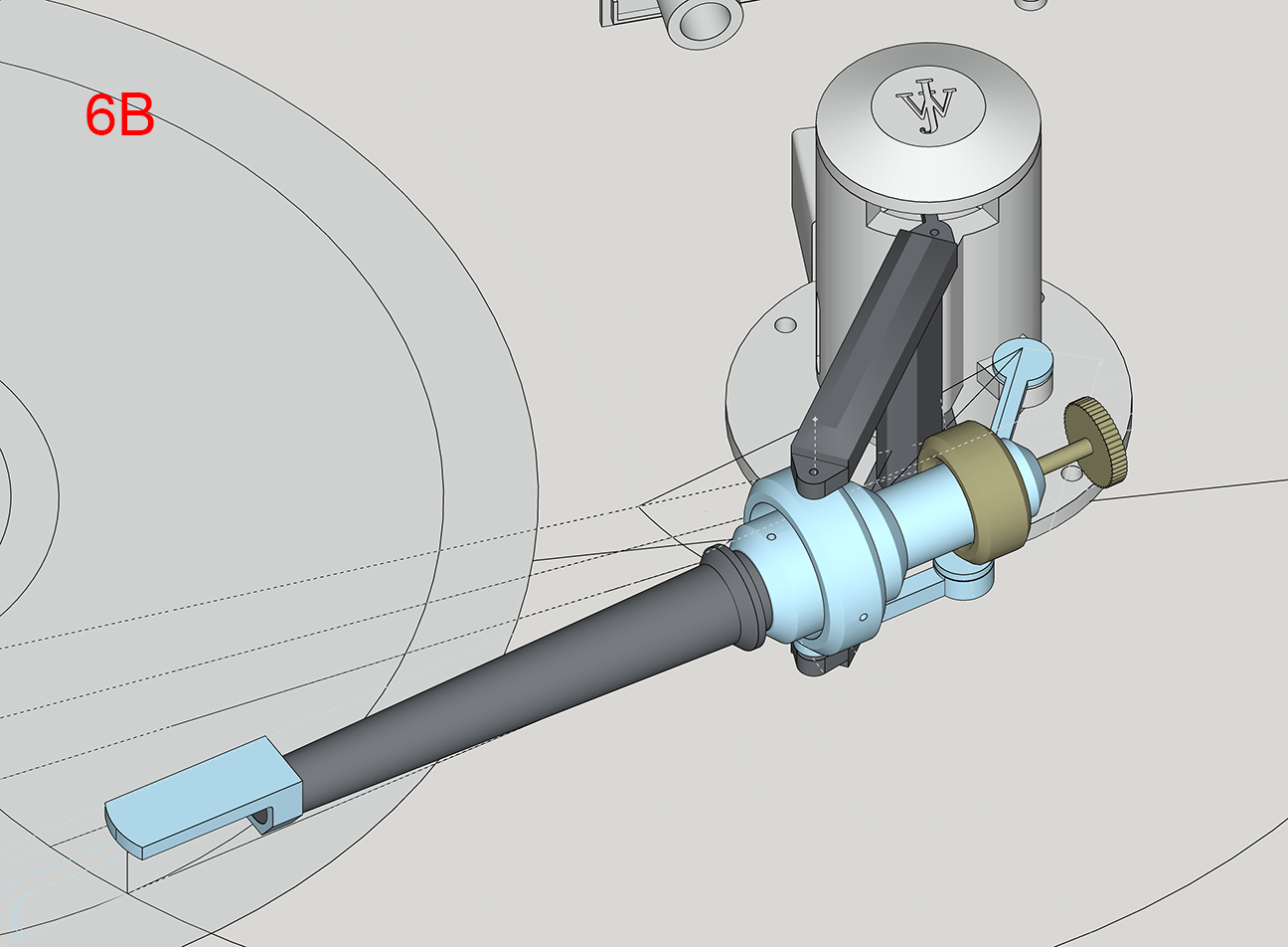

I continue to try to improve both arms.
For 5A ( please note it is not Reed 5A, it is the 5th version and a variant of the 5th version), I redeigned all the parameters. Its tracking errors are so small and they are not factors at all since tolerance during making may be larger than theoretical tracking errors.
For 6B, I changed the guiding mechanism. It was inspired by Schroder LT tonearm. Schroder LT has the guiding mechanism under the base tower. It is a very clever implementation. I can't do that because it may get too complicated to use the arm on my existing table. I also found that if I design the guiding mechanism too far from the front of the arm, tracking errors may be getting larger. So, a non-circle guiding rail may be desirable.

I like both arms so much and don't know which I should make now. If I have to choose, my favorite leans slightly towards 6B.

I prefer 6B. I like having only ONE primary bearing so the majority of the mass is on one pivot. And the secondary bearing should be relegated for the guiding mechanism. I don't like the Thales Simplicity tonearm approach of dual pivots/armwands. Said to have resonance cancelling effect but I don't buy it. I would put the guiding arm at the top instead of the bottom so it's easier to implement a cueing device.

Jim,
I agree with 2wice and DD - 5A is an attractive arm, but 6B would be my choice for its relative simplicity and inherent stability. And it's a pretty good looking arm. Nice designs and excellent drawings. There is one possible hitch I think I see in 6B - there's a possibility the guide arm will foul the pivot arm when the arm reaches the final grooves. If that's true, a slight curve or offset will cure it.

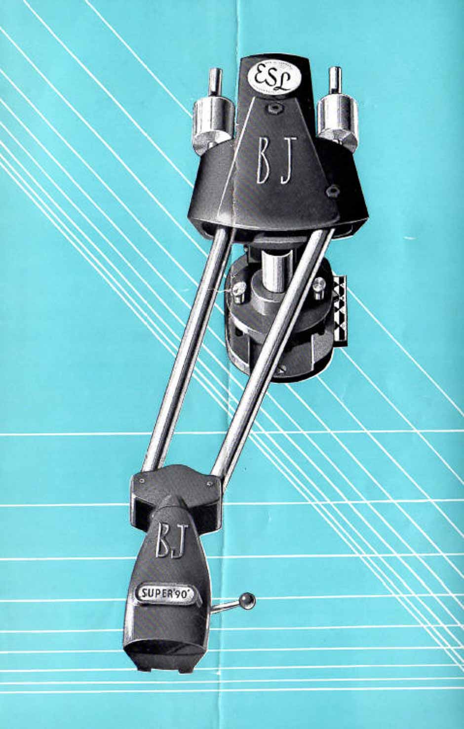

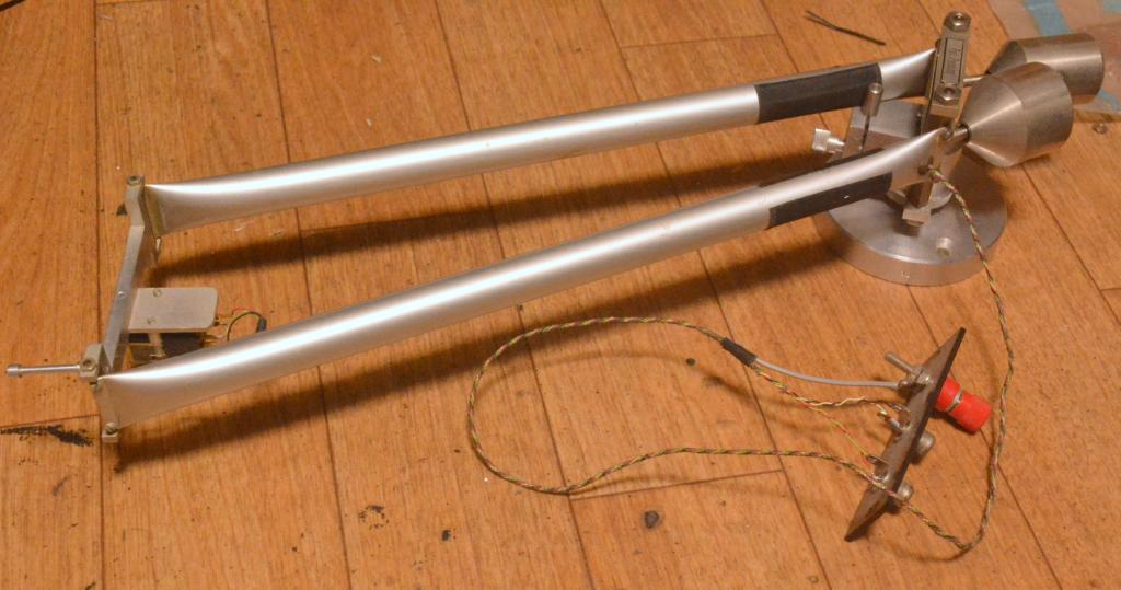

5A reminded me of something because of the way it sits - the Van Epps and Burne-jones arms. If those designers had shortened the arms, moved the outer bearings inward and added a wand, they might have invented the twin arm PLT a long time ago.
Rayk: When I was looking up those two arms, I came across a conversation you and I had about them ten years ago on VE. Ten years ago.

Doug,
I checked the guide arm after reading your post. The clearance between the guide arm and counterweight is about 2 mm in the vertical plane. It may be problematic. The counterweight is a spare part I left from building the air-bearing arm. I may have to make a new counterweight. Thanks for your advice!
From the photos you posted, they do look to have the same geometry as my 5A arm. However, it is hard to say without knowing the details. It also seems to me that they resemble Thales tonearm more.

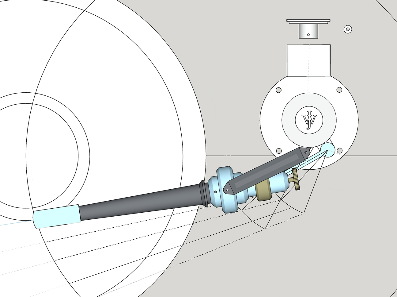

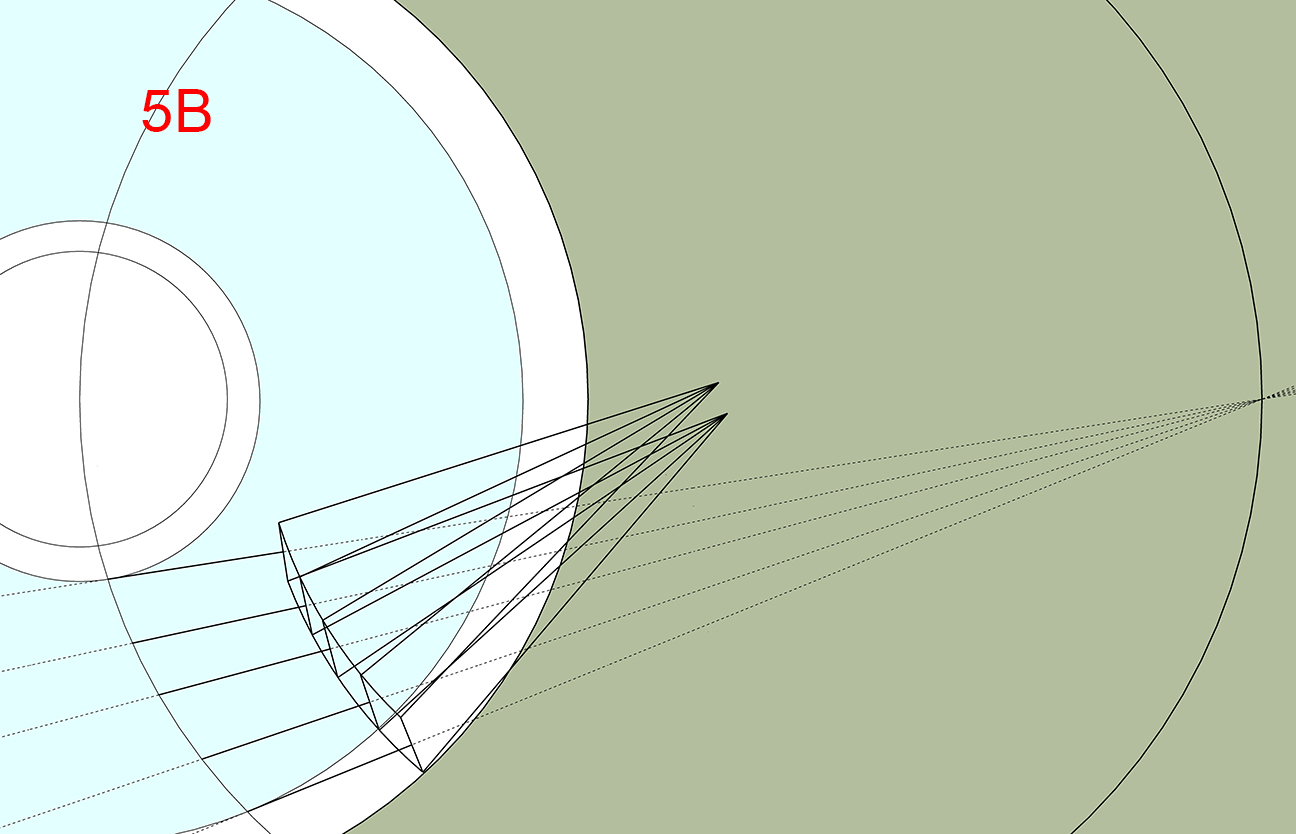

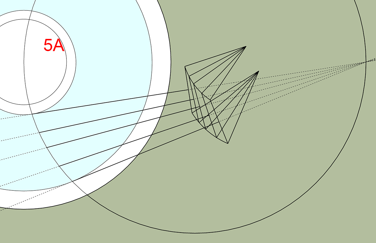

I am posting the geometry for my 5A arm and for other variable geometry for my 5B arm here. It seems to me that both tonearms in the photos posted by Doug have the same length of arm wand. If a tonearm is based on double Birch geometry, the two arm wands can't be the same length. My arms may look similar to these arms, but the underlying principle is different. Especially for the geometry of my 5B as I posted here, their geometries look very similar. In fact, they are different in their geometry.

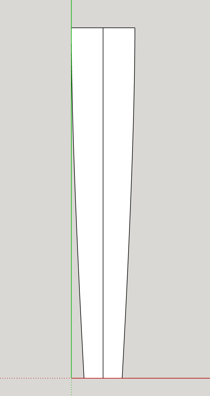

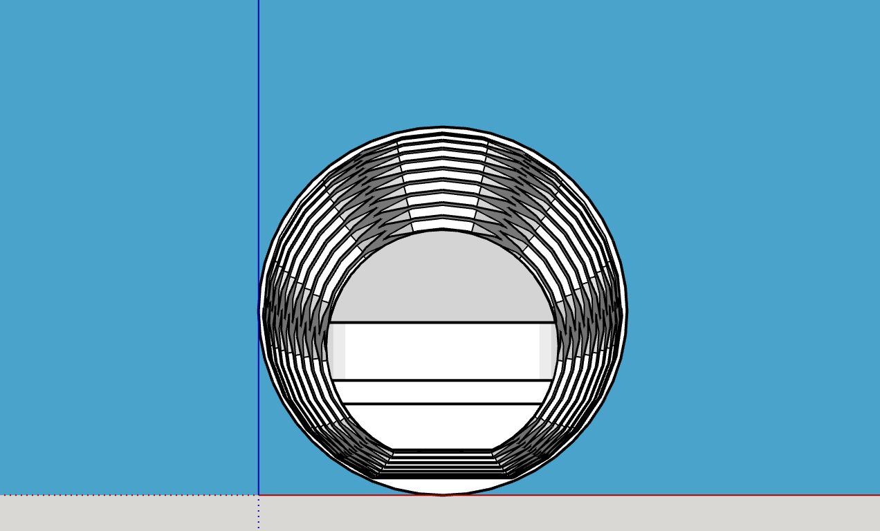

I finalized my designs and came up with two versions of the same arm.
I am going to make V1. For V1, I am going to print the headshell in stainless steel sandwiched with a 2 mm carbon fiber plate. I also took Doug's suggestion to install a bubble level on the top of the base. All the orders for 3D printed parts had been placed.
For V2, the arm wand is 3D printed in aluminum or, better yet, titanium. Titanium is not cheap but acceptable for this particular piece. The headshell and arm wand is a uni-body design. The headshell gets sandwiched with carbon fiber, too. From the experience of making air-bearing arms, I realized how important a headshell is.

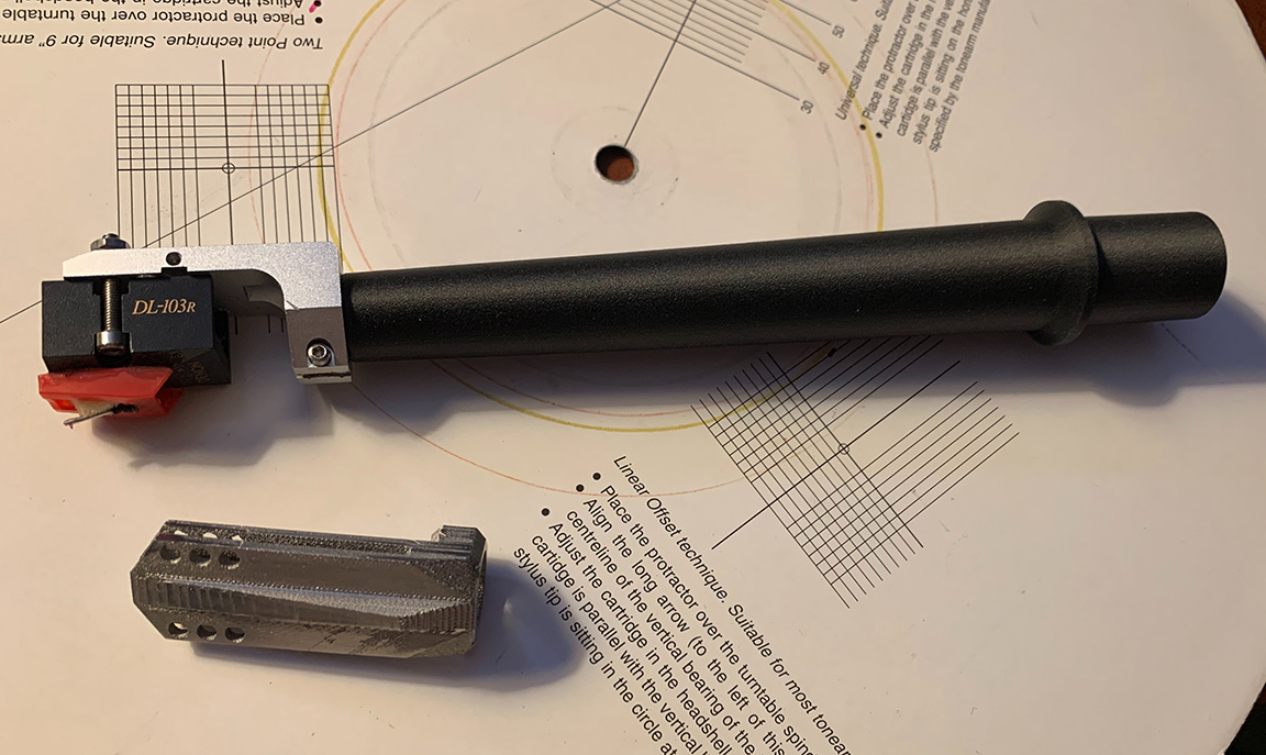

I received the 2nd part, a carbon fiber 3D printed wand, today. The wand is beautifully printed. If I can do it 2nd time, I may try to reduce the weight of the wand by using less infill. I used 80% infill. I think 60% should be better. The stainless steel headshell is on the bottom of the photo. The headshell is nice, too, but I can't use it because 316 stainless is magnetic.
For the honeycomb wand, I don't know how to arrange the wire yet. I may just glue the wire on the bottom inside the honeycomb.

Very nice armwand. I particularly like the repurposing of the Audio-Technica headshell as it will make future cartridge swap easier. Can't wait to see the rest of the parts arrive.
3D printing is a form of additive machining and traditional machining is a form of subtractive machining. I believe SLM belongs to the latter. Each method can arrive similar results of course.

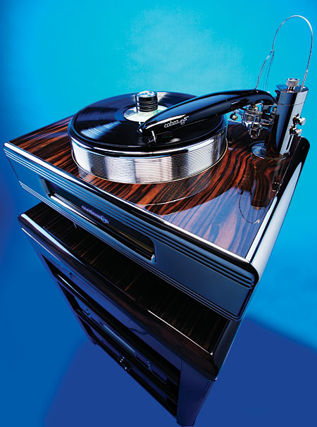

My honeycomb arm wand was directly inspired by Cobra tonearm. They used composite material to form a shell and I use structure to form a shell. My honeycomb arm wand is in a half-moon shape as well from the front view. It also has a curved profile. Frank's arm may be the first commercial arm with 3d printed structured arm wand.
