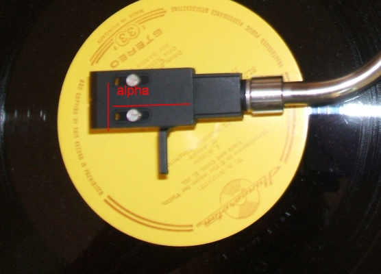

1, On the Thales circle, Reed 5A is on the Thales circle without overhang. It supposes to have no skating by their claim.
2, All regular pivot tonearms are beyond Thales circle with overhang and two nulls. They can be sin(90)=1, at null. By your model, once sin(90)=1. Fsk=Ffr. If Fsk=Ffr, does this mean there is no skating? However, all regular pivot arms skate at nulls, i.e., sin(90)=1.
All the tonearms are real. They are not imaginations.
Overhang and Thales circle have nothing to do with skating. Exactly that was I wanted to illustrate with my formula. The only thing what counts is the angle of the tangent to the path of the stylus to the line between the stylus and the centre spindle.
If this angle is 90 degrees, than the stylus is on the label. Then of course the friction force and the skating force will be the same, but that has no practical value to the listener.

Ray’s string test and Conrad’s condition are different from Klaus's statement.
Klaus Rampelmann stated: As long as the line connecting the stylus tip to the arm pivot is not tangential to the groove at the contact point, which is always the case for pivoted arms, a skating force is generated.
I will assume that he was talking about regular pivoted arms, i.e., a pivot arm with an overhang. Yes. He is correct. All the pivot arms with an overhang skate. Offset is irrelevant. No problem here. For a pivot arm with an underhang, his statement is incorrect.
Let’s take a DJ tonearm without offset but with an overhang. The DJ arm will pass the string text. If you pull the string, the arm won’t move sideways. The DJ arm will meet Conrad’s condition, too. A line through the headshell will intersect the center of the pivot. So, this DJ arm won’t skate by the conclusion of the string test and Conrad’s condition. In fact, the DJ arm does skate.
This why I said it before. The string test and Conrad’s condition can’t be used as the standard whether a tonearm skates or not.
