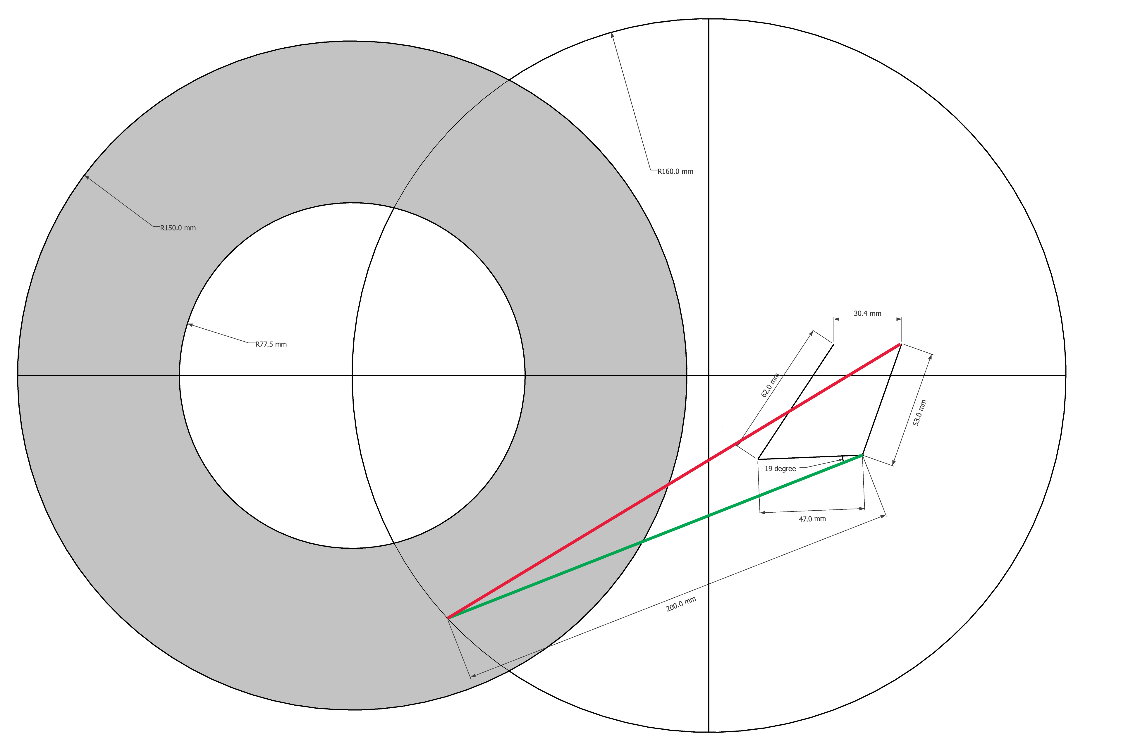

I thought you were talking about skating for regular pivot arms. But if you were talking about tangential pivot arms, Klaus' statement is correct. And, both the string test and Conrad's condition are correct, too. Take Reed 5A as an example. Please see the image.
The green line indicates the string test and Conrad's condition. If the green line is a string, pull the string, the arm will move sideways. For Conrad's condition, the green doesn't intersect the center of the pivot. The arm will skate.
For Klaus' statement, the red shows that the line through the tip of the cartridge to the center of the pivot is not tangent to the groove. Therefore, the arm will skate.
Although I said that I did expect the arm didn't skate, I thought the arm might still skate. This is why I want to build a clone of Reed 5A.
All I was trying to approve that the string test and Conrad's condition were not the universal standards for judging if a tonearm skates. In the case of DJ arm, both standards get incorrect conclusions. Both standards are based on arm's offset. In fact, offset is irrelevant to skating.
For Klaus' statement, it is not correct if a tonearm has an underhang. Yes. I do understand that we haven't seen a working tonearm has an underhang. It probably will never be a tonearm with an underhang.
If I have to choose, I rather take Klaus' statement about skating as standard because his statement can be applied to a DJ arm as well.

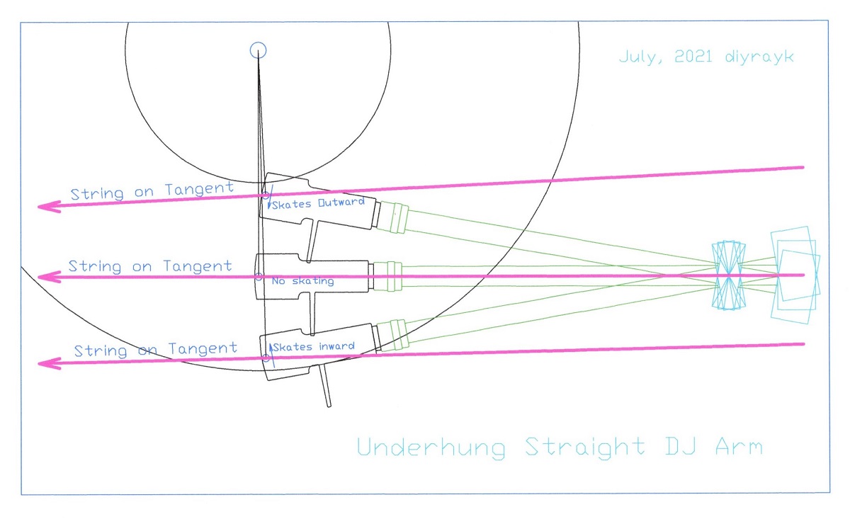

I can’t help but get the feeling that you have a specific vendetta against my string test. I hope I am misreading that, in which case I apologize. I am going to be extremely careful to keep this technical by limiting my response to presenting facts and data.
Your frustration with the string test is due to your applying it incorrectly, and are therefore mis-diagnosing what happens when you use it to test straight DJ arms.
The string test was originally conceived to be applied to offset arms and tangential pivot arms, both of which had/have the goal of maintaining tangency across the playing area of the disc. Then, straight DJ arms bubbled up in the witches brew and entered the discussion from out of left field. Your misapplication of the string test has been, shall we say, throwing you for a loop. As clarified in subsequent posts by myself and others, you have to pull the string tangentially to the stylus contact point, which is not necessarily in line with the headshell. I have outlined pertinent historical mileposts to clarify this and present them below.

Summary:
If we take Straight Tracker’s precise definition of “tangential” and substitute that precise definition in my “String Test 2.1”, alighiszem’s ‘yarn’ test, Conrad Hoffman’s criterion, and Klaus Rampelmann’s explanation of skating, then there is no conflict or incompatibility among these test criteria for skating, and by all these methods, the DJ arm FAILS the test. All four methods work as advertised if you use the correct frame of reference for tangency, and the physics of the universe is happy. The nice thing about String Test 2.1 is that with a simple piece of string you can walk up to a tonearm and determine if it will skate even if you don’t know where exactly the pivot is, which is sometimes not clear on a complex mechanism such as a KLAUDIO arm.

Ray,
I don’t have any vendetta against your string test and had no intention to discuss skating in this thread. I was merely replying DD’s post that quoted Klaus’ statement and mentioned your string test and Conrad’s condition.
Your string test V1 and Conrad’s condition are in fact the same thing. Both don’t include friction between the cartridge and groove at all.
For string test version 1, it will fail in two cases. 1, a DJ arm. 2, an arm with offset and an underhang, too. Since you updated your string test to V2.1 now, you must be aware of its shortcomings.
Before we start to discuss V2.1, I would ask only one question.
How do you determine that your string is tangent to the groove? If it is a test, you have to actually perform such a test on a tonearm. I would like to see you actually perform such a test before we will discuss it further.

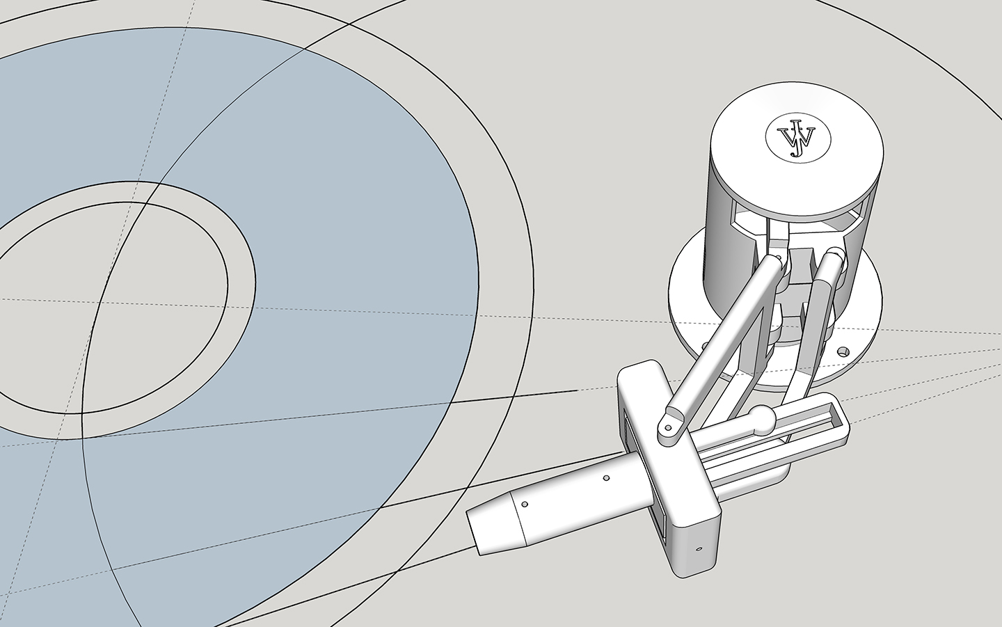

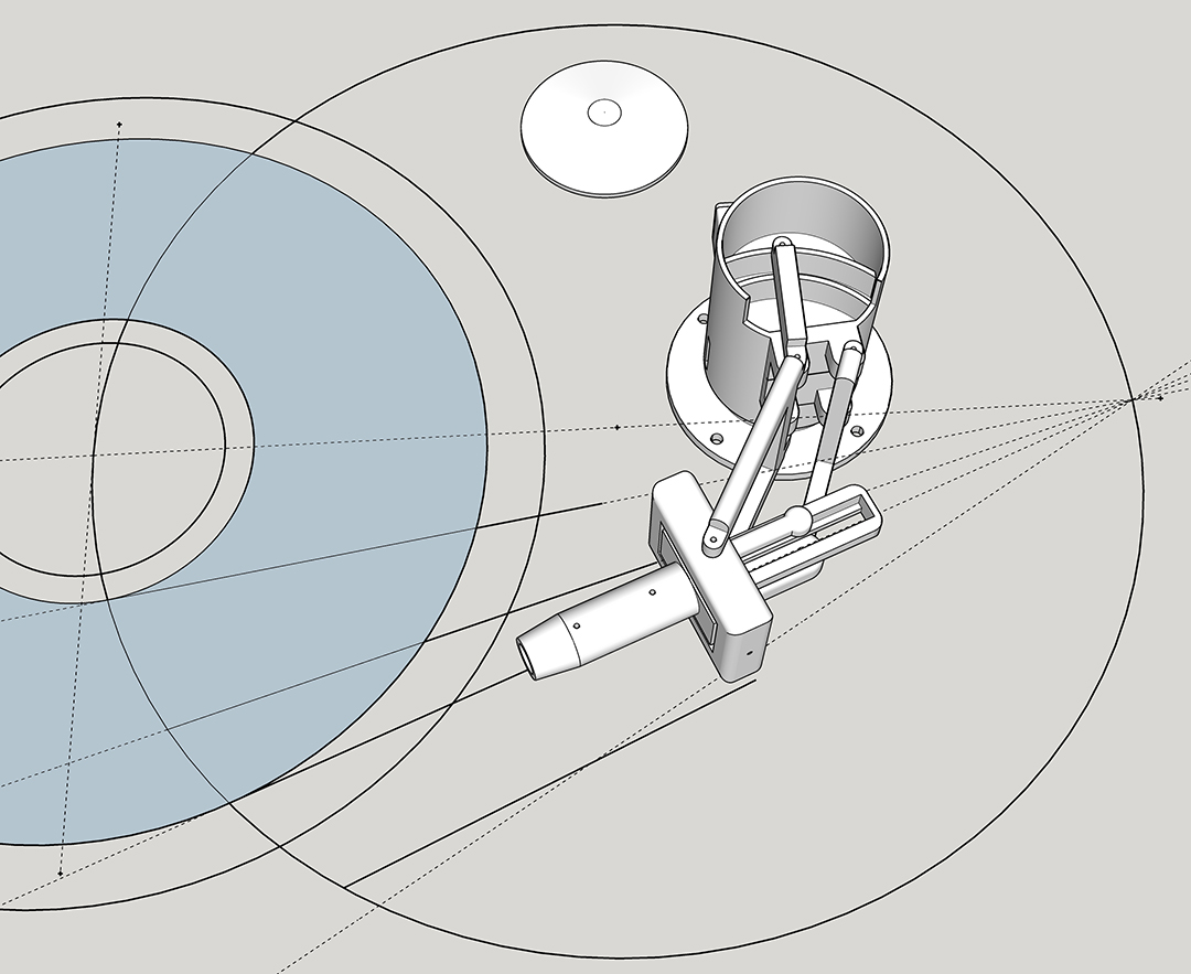

I updated the title for this thread. I planned to build a clone of Reed 5A originally to prove if Reed 5A skates. However, in the process, I start to study its geometry and found my own geometries for new tangential pivot arms. Once I found my own plan, I am so reluctant to just copy someone's work and decided to build my own. Still, my own arms can still be used to prove if the arms skate since both my tonearms and Reed 5A have fallen the same category by the skating definition of Klau.
I designed two plans and am not sure which one I will make at this moment. Both arms will have a silicone damping device that is built into the base. Both arms will utilize a magnetic counterweight and be 3d printed. Ideally, they will be printed in aluminum, but the costs are too high. So, it will be printed in ABS.

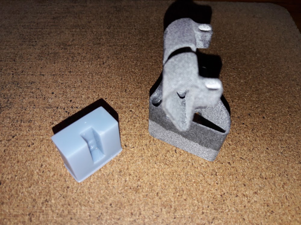

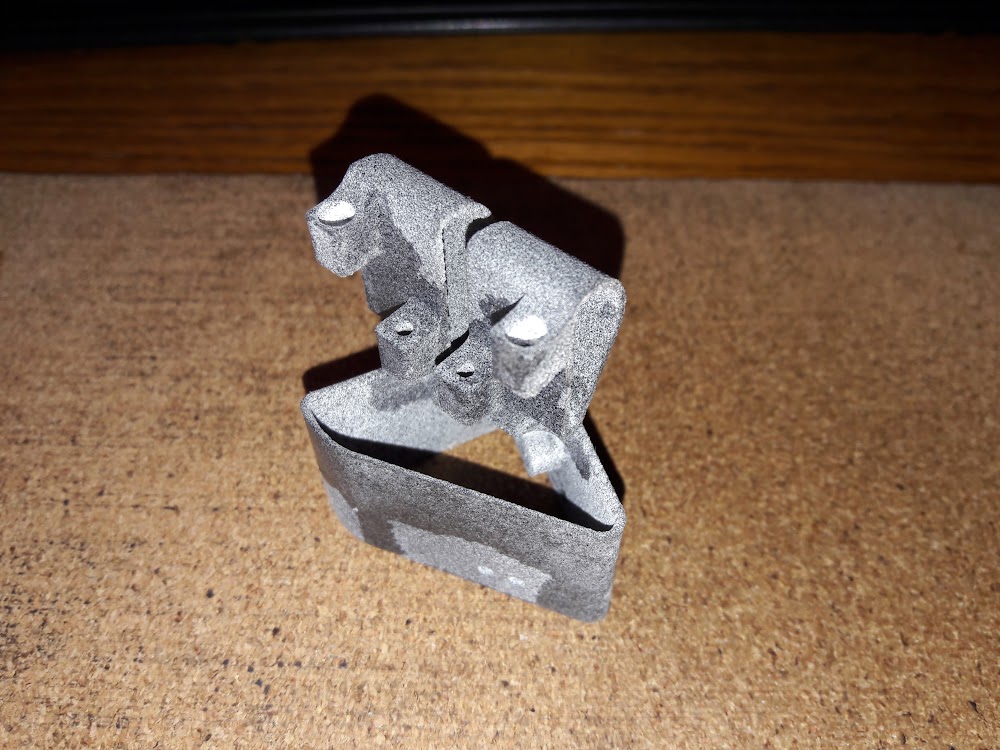

Nice work Jim
Looking good, if I may suggest printing in Multi Jet Fusion if possible. It is not supper pricey, but the tolerances with nylon MJF are waaaay more accurate.
It is what I've been using to great effect.
Your fitting will be better and the parts are production ready with no post-processing needed.
You can also get any colour you want, super trippy rainbow unicorn fart prints?
No problem.
It also weights less than ABS and you are free to design elements without regards for print support or print orientation.
attachment.php
1 mm wall thickness, about 4g in natural colour.
attachment.php
mSLA Resin assembly jig, also about 4g. Much stronger than both SLS and MJF, costs more though.
Good Luck!

Hi 2wice,
I have very little knowledge about 3d printing material and methods. I got my education on printing materials from youtube. I saw a video about 25% carbon with nylon printing material. It was very intriguing. Such material must have nice physical characters to resist vibration. But I have no idea where I can get the parts printed with carbon nylon and don't know the cost.
I will take a look at nylon material, too.

Jim,
Very good looking and promising project(s). Are you going to do one or both? If both, I'm very curious about relative performance, partly because the orientation of the primary pivots is so different - by nearly 90 degrees. I wonder what effect that may have on the arm at its fullest extention for the last few grooves.
What program are you using for the printing plans (instructions)? I know so little about the details of 3D printing, I don't know what they're called.

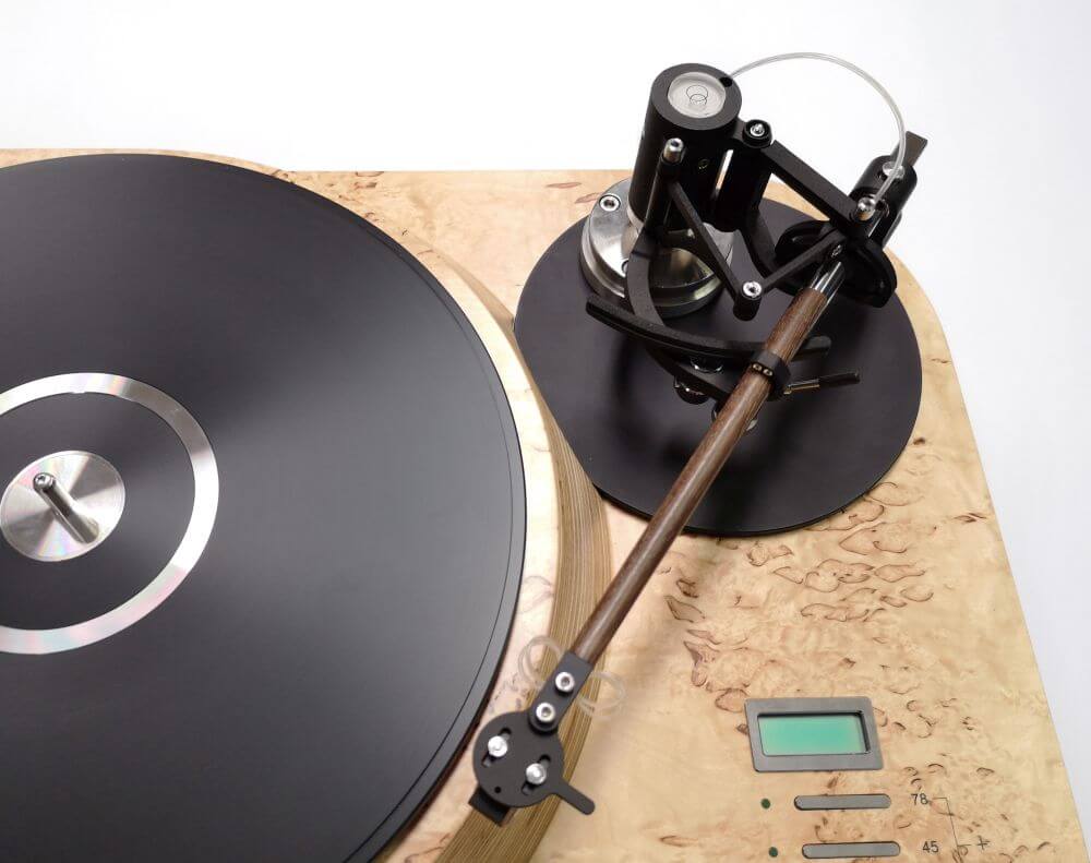

You could just fit a bubble into the reservoir cap. Bubble levels are very handy to have with these arms.
2wice: Are you saying Reed 3D printed the $10K Reed 5?

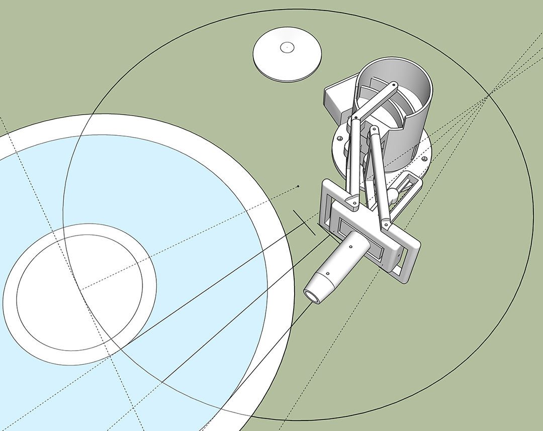

The attached image is the one I am going to make. However, both arms have some common parts so I will pre-print holes on the parts for another arm as well. If I want to make a second one later, I only need to print three additional parts.
I use Sketchup to do all the designs. You may use its web version and it is free.
I don't expect there are big differences in performance between these two arms. The other arm uses a bit more material and seems a little complicated due to the needle bearings I use. If I can source the needle bearings as Reed used for their 5A arm, my arm can even simpler. I have no plan to install a bubble level on the top of the base tower. The flat top of the base tower can be used for bubble level if I need it.
Jim
