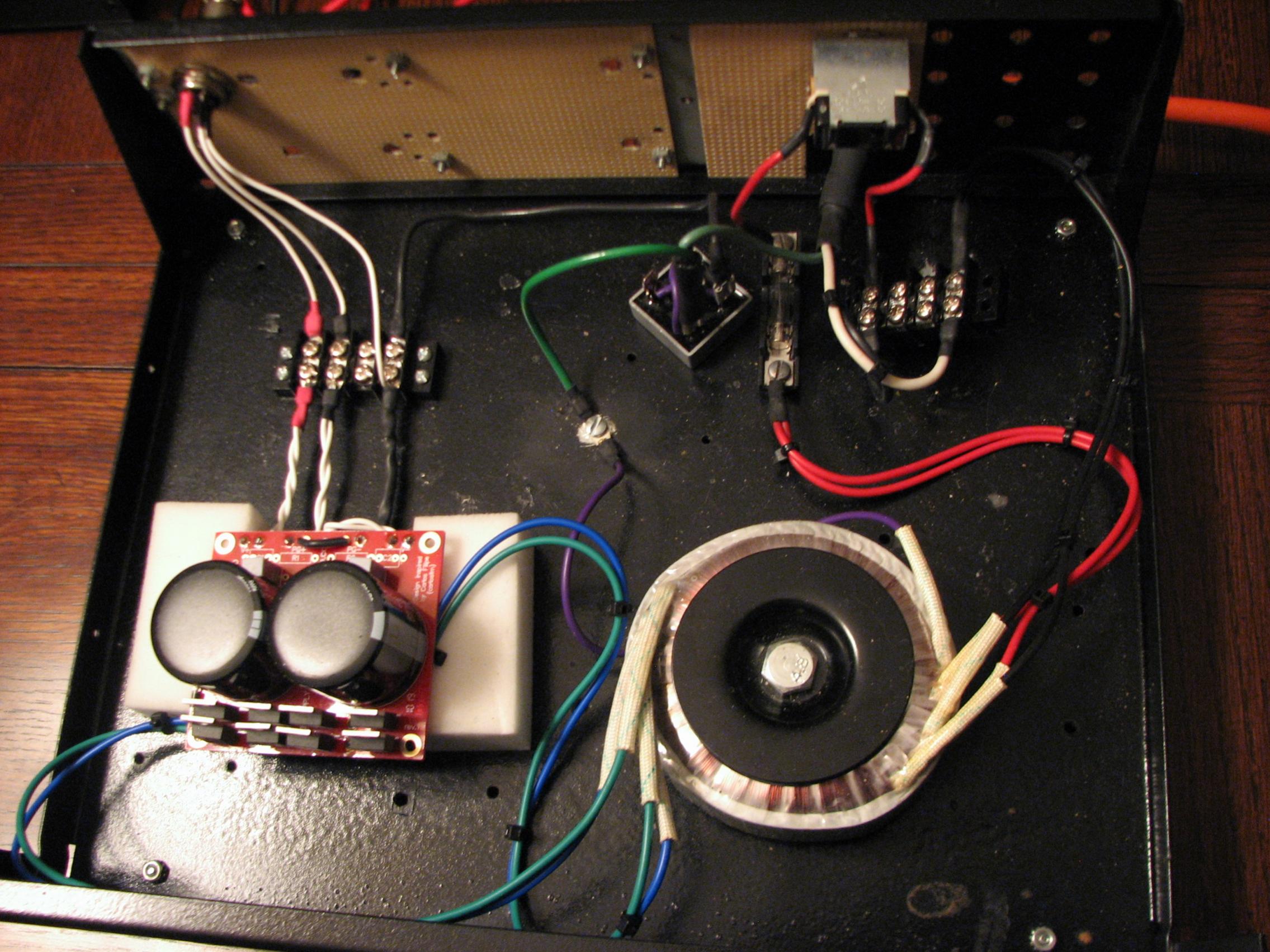

Fired up my Pearl 2 Power Supply, at least it works. 33.3 volts per side though variac, unloaded

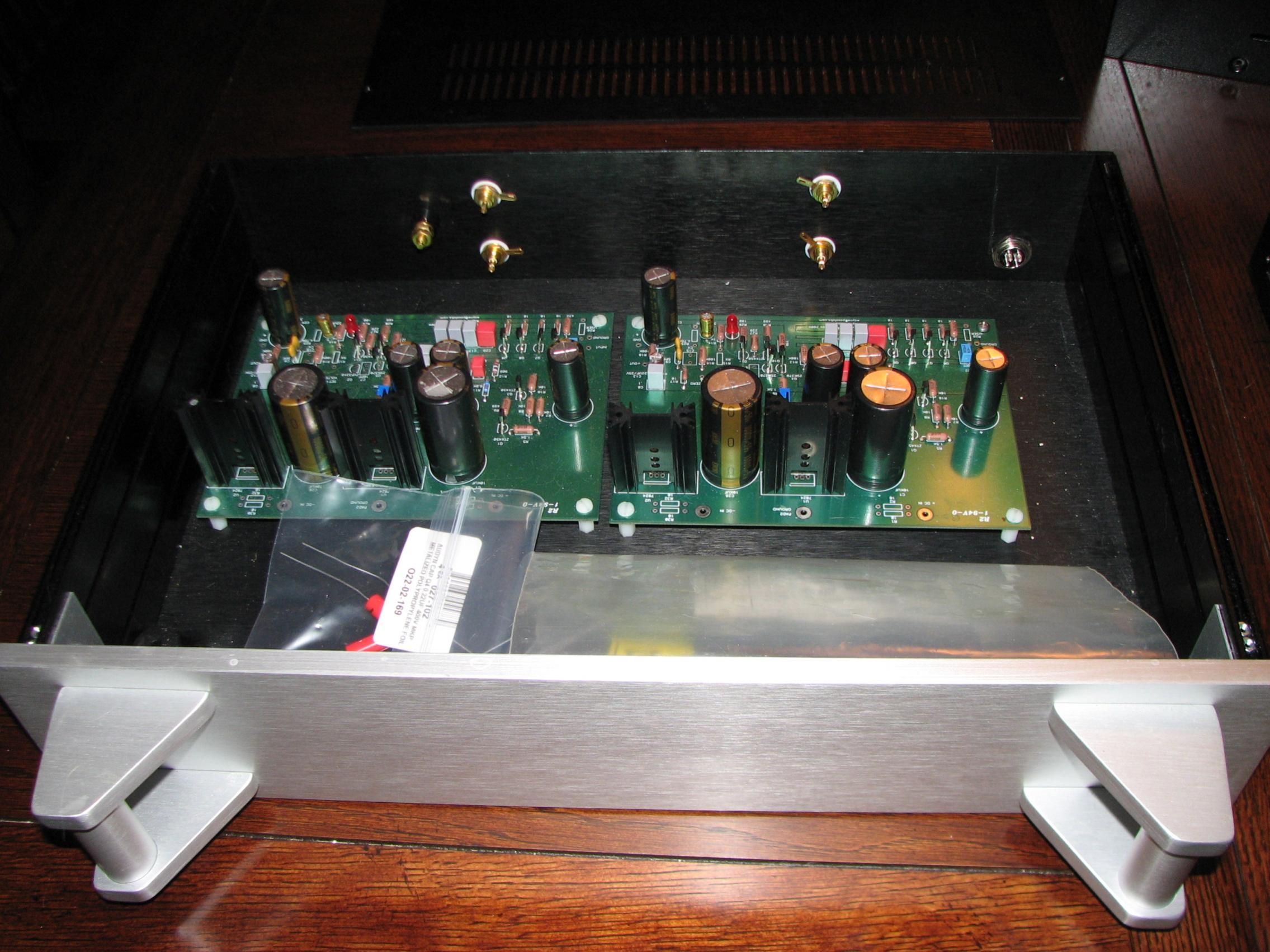

Assembly of umbilical and getting phono box ready. Just need to solder in the regulators, ZVP 3310s, a few resistors and wire it up.
Seems I left out certain resistors as part of the fire up protocal, will have to reread notes from a few years ago!
Eventually the power supply will be housed in a DIYstore chassis, but the old Dyna Pat 5 box will do for now!

The PCB has holes for the heatsinks. Place the TO-220 device on the heatsink, with screw and nut, insert the heatsink on the PCB, solder it in, then solder the electronic leads.
I did not realize you soldered the heatsink to the board,glad you mentioned this. I just assumed the tabs on the sink stuck in the holes, along with the device soldered to the board and screwed to the sink held it in. Or do you mean the TO-220 device is soldered in when you say that and NOT the sink itself?
Is it difficult to get the tabs on the sink hot enough? Guess I will find out soon enough!
