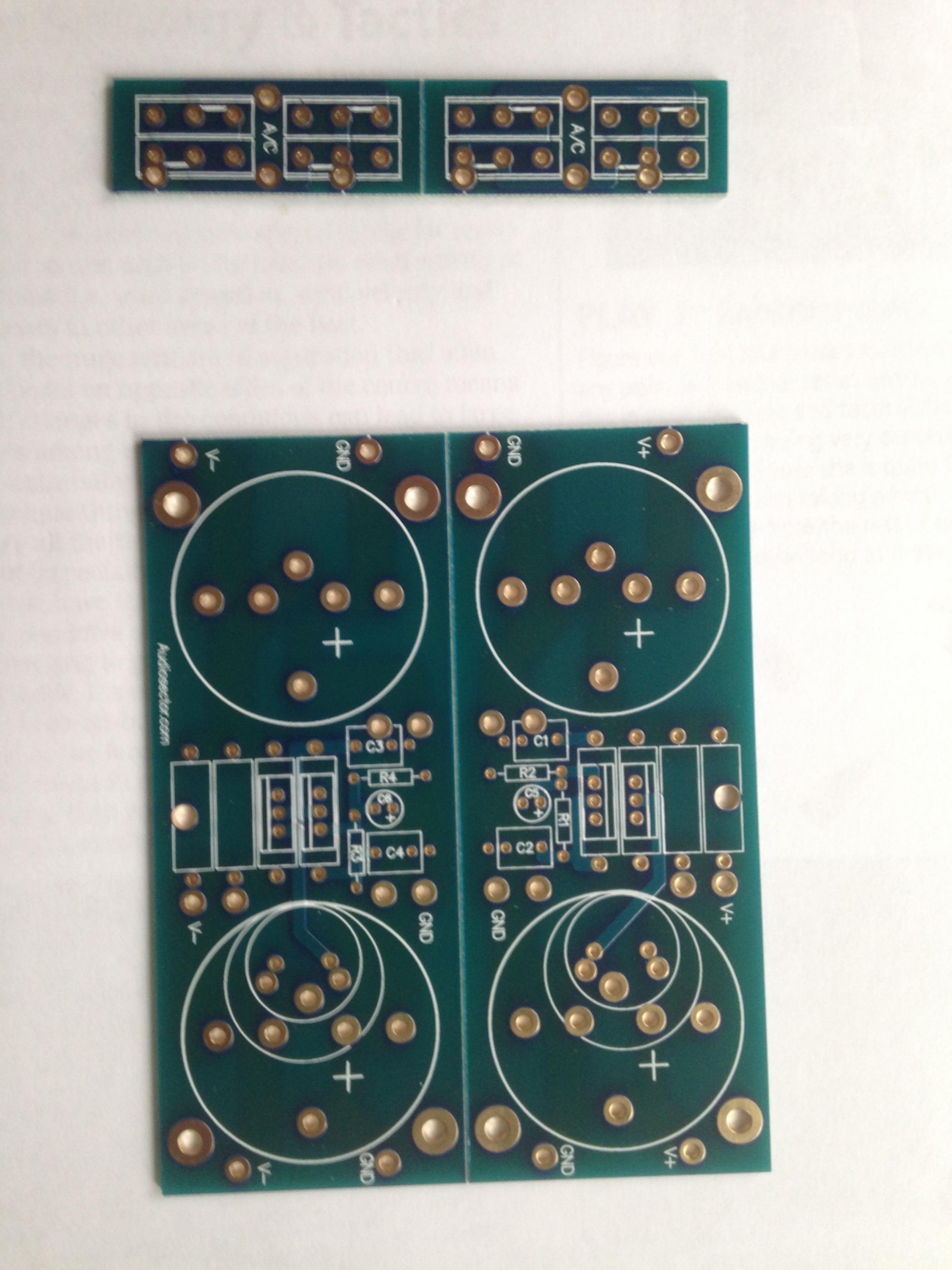

I was so happy with my B1 that I decided to sell my tube line stage; then I thought I'd put my tube phono preamp on Audiogon and see what happened and it sold immediately. So now I "have to" build a Pearl 2. Power supplies scare me a little so I thought I'd start there.
I have a Peter Daniels psu board I'd like to use, like in the photo.
I intend to use this toroid: 50VA Power Transformer
These rectifiers: MUR860G ON Semiconductor | MUR860GOS-ND | DigiKey
And in the spirit of diy overkill, four of these caps: Mundorf MLytic AG MLGO 10000uF 40VDC, Sonic Craft
So, my question is what else do I need to populate the board? What value resistors, and do I use the spots for small components, like C1-4 or R1-4 or are these for other applications? What's a good connector for the power umbilical?

The parts you have will work great! Save the m-lytics for the pearl boards, not the raw supply.
The other pads on the PSU are for regulators. Leave them alone. Use 4.7-10 ohm for the filter resistor.
