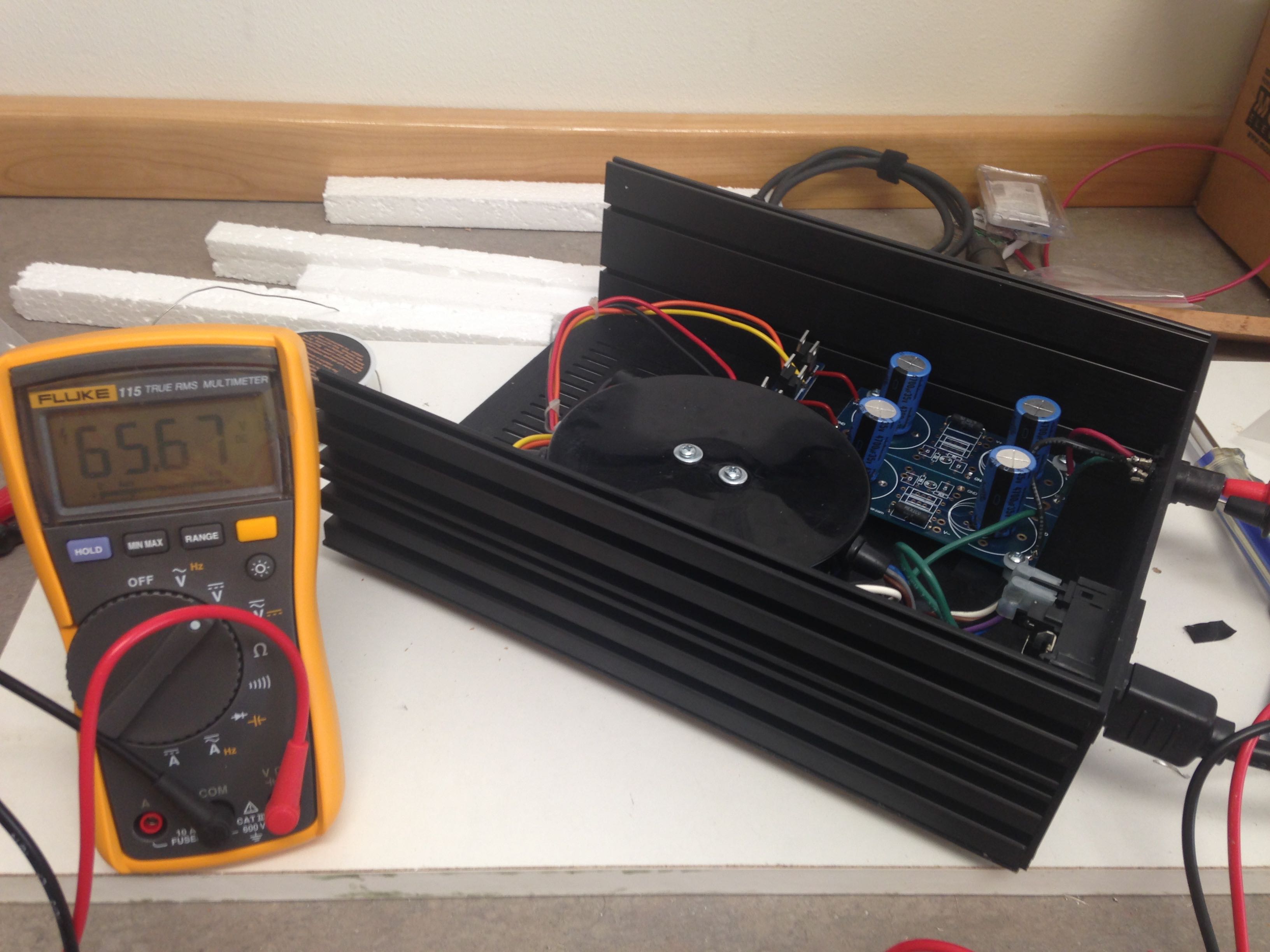

So today I finished wiring up the PSU for my Pearl 2. I switched it on, plugged in my DMM and got the reading below, in the picture, which is too high, right? But at least there were no sparks or smoke. A few hours later I tried it again, and this time only saw about 7 millivolts, and the fuse looks smoked, though still intact. What have I done?
Thats not the same fluke as mine, but it looks like 65 volts to me, no? If you are measuring from V- to V+ thats about right. If thats the case, measure from either V- or V+ and ground. My fluke shows Mv if its millivolts...If thats the before pick, and you were measuring from V- toV+, mine shows about 60v dc. Make sure you are set to DC, and if from V- or V+ and ground and it says 7 mv, yeah something is wrong. If thats the case people here can help, but they will want clear pics of the build and so forth. Fuse still good?

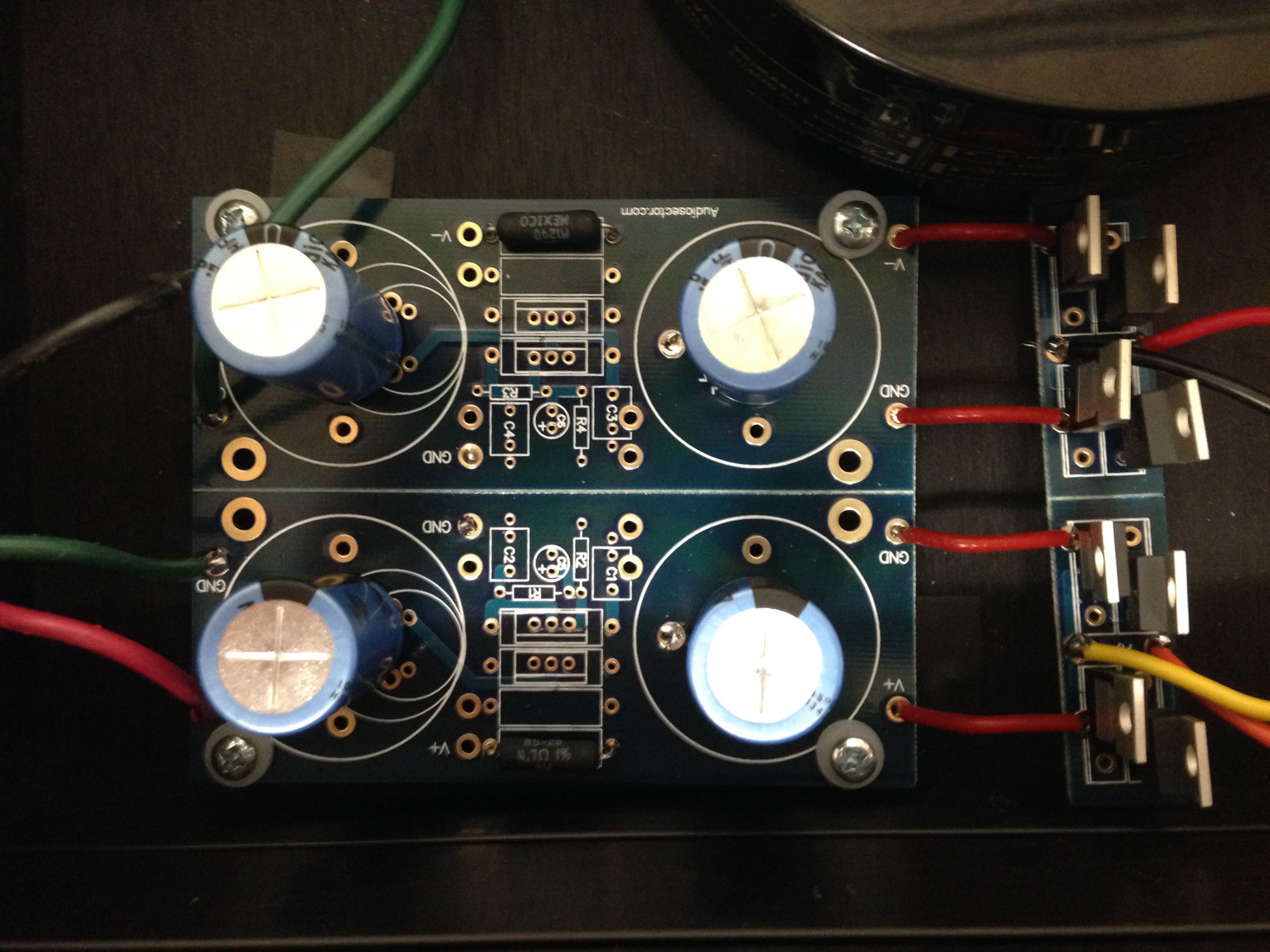

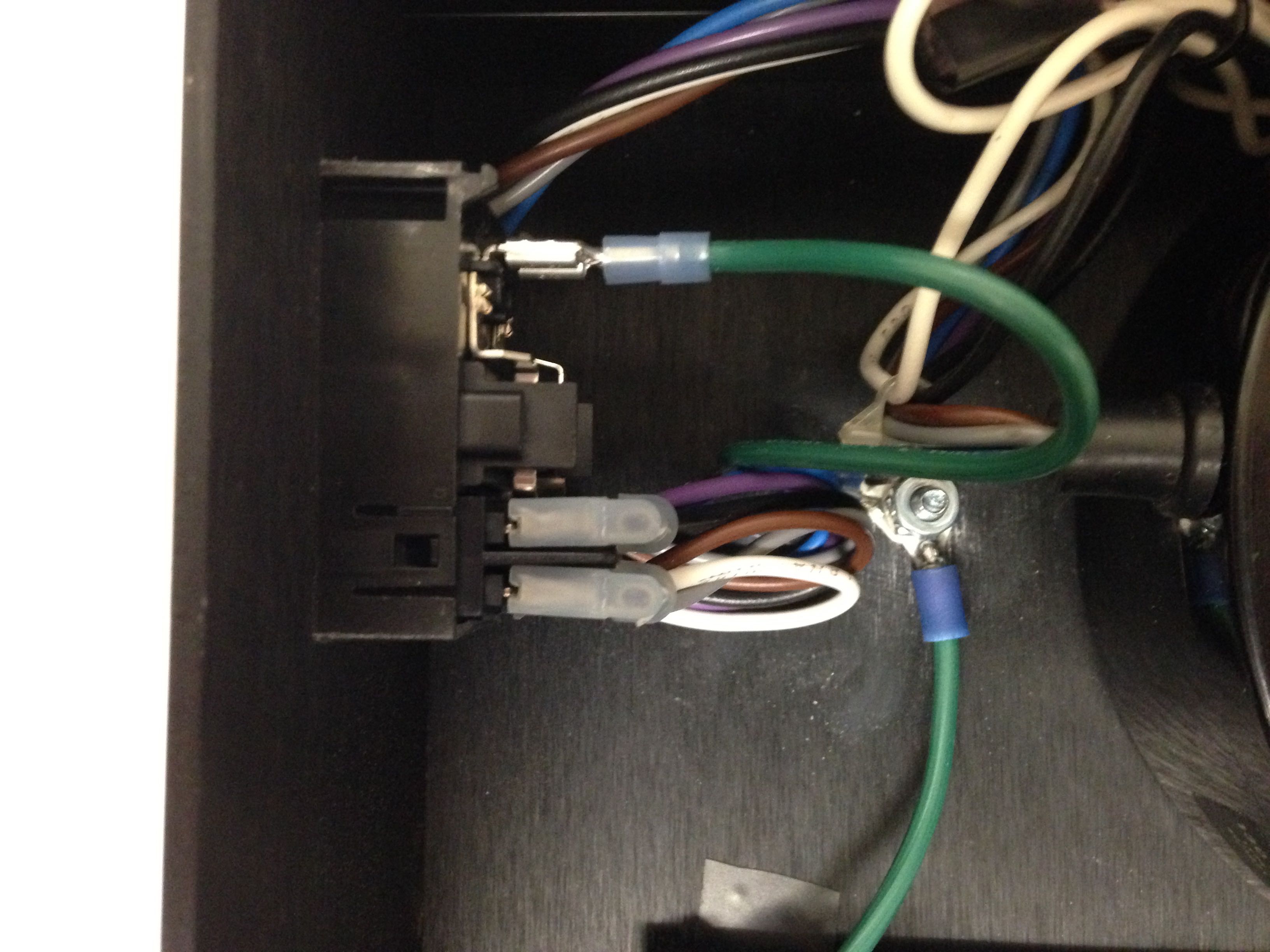

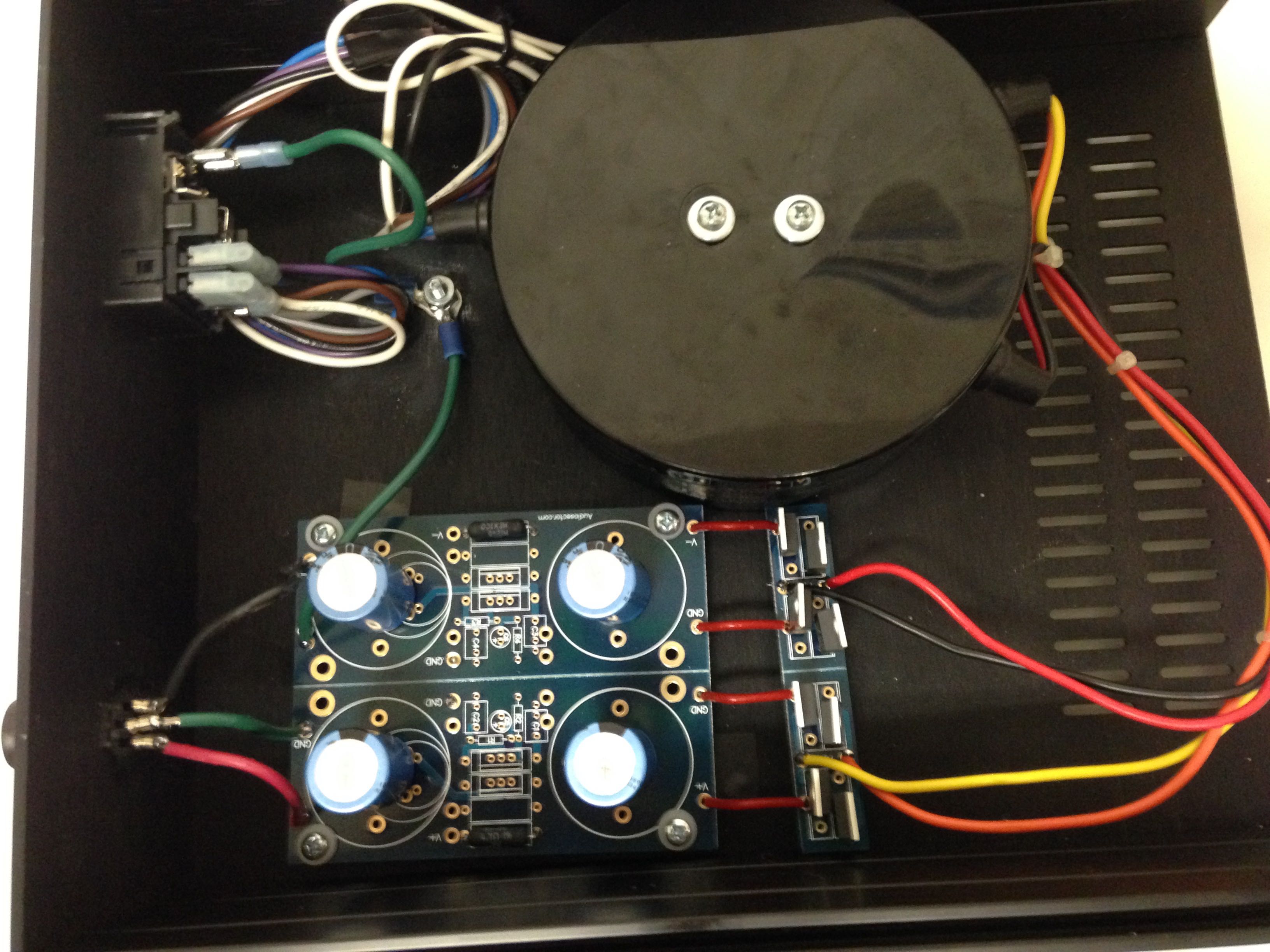

New fuse, blows right away. I'm using 500MA, 250 volt, but I'm not sure where I got that value. Is this correct? Per 6L6's recommendation, I used 4 caps, about 4700-6800uF, a pair of 4.7-10R 3W resistors and some bleeder resistors, 2.2K-10K 1W or more, MUR860 diodes in TO-220 packages. The big toroid is an 130 VA dual 22v sec Avel Lindbergh that I bought from another diyaudio member. I can look up the exact values for the caps and resistors, if that helps. Pictures are of the Peter Daniels board.
Reverse the connections of the yellow and orange secondary wires. Unsolder, swap, re-solder. That will probably do it.
As for voltage, measure with the black probe of your DMM on GND, and with the red, you should have positive 32V at V+, and negative 32V at V- .

Hi Jim, I switched the orange and yellow leads as suggested, and all is good now. 32 volts each side, direct from the wall. Now on to the RIAA boards! I used the Peter Daniels PSU board because I already had one. Thanks again.
