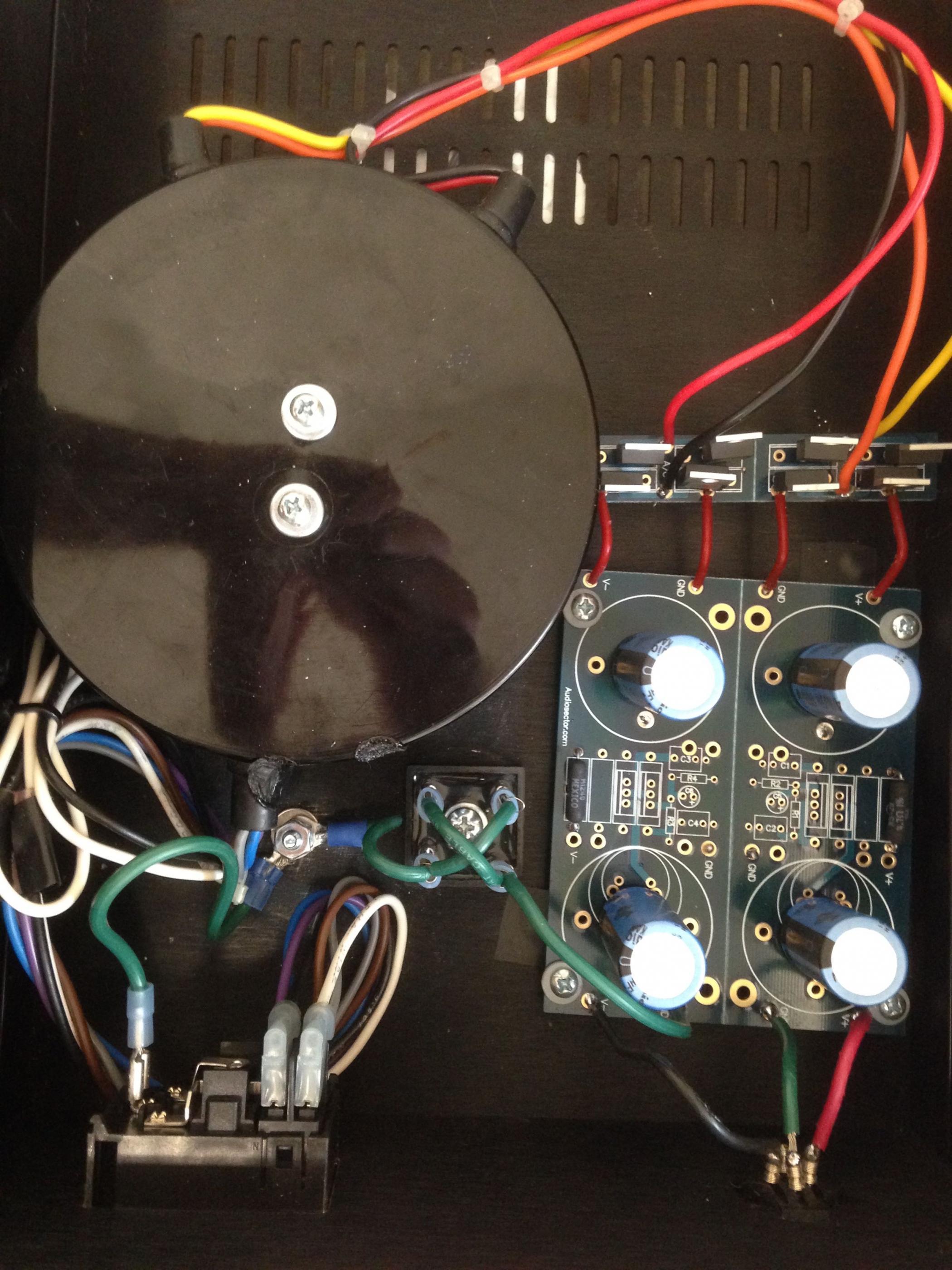

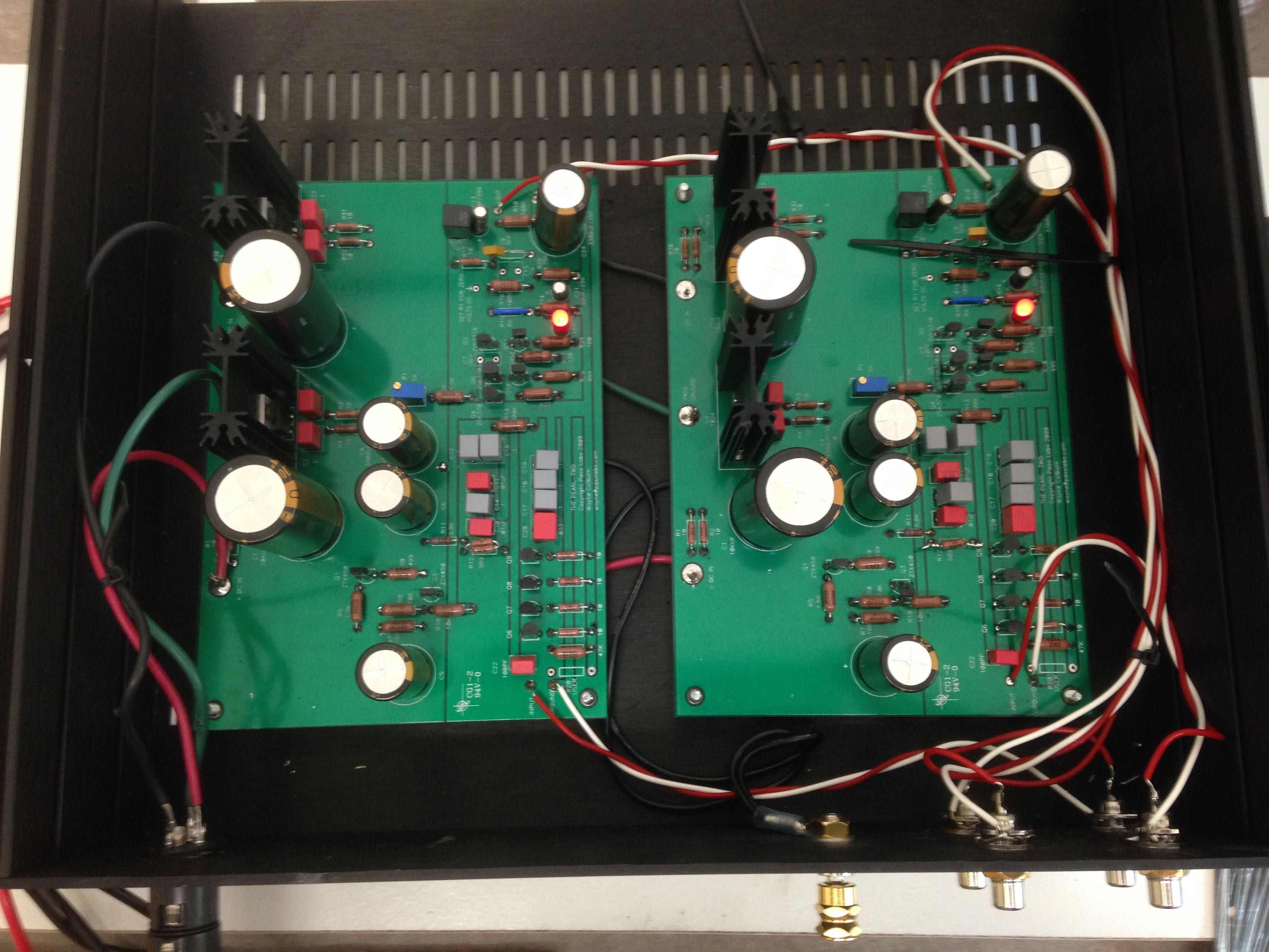

After my questions and confusions with the power supply, I was apprehensive about the finished product. But it lit up, it measured out, and it sounds fantastic. Absolutely quiet, very transparent and detailed. Plucked strings are truly luscious. A definite improvement over the expensive tube phono pre it is replacing. First album listened to: Roxy Music, Avalon. Then Suzanne Vega, Beauty & Crime; next maybe Steely Dan, Aja. This is one of those components that keeps you up for hours, pouring back through your record collection. Much thanks to Wayne and Nelson, for making their great work available to us, and to Jim for all his help. Next I think I'll do an Aleph J, but that's for next winter.

Looks great! Well done!
Yep, it's a fantastic gift that Wayne gave us all. A simply amazing phono preamp. I know of nobody who has built it that isn't simply enchanted with it.

it lit up, it measured out, and it sounds fantastic. Absolutely quiet, very transparent and detailed. Plucked strings are truly luscious. A definite improvement over the expensive tube phono pre it is replacing .... This is one of those components that keeps you up for hours, pouring back through your record collection.
